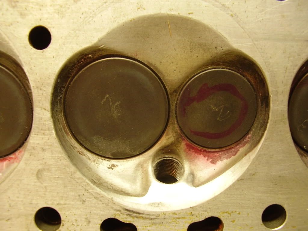

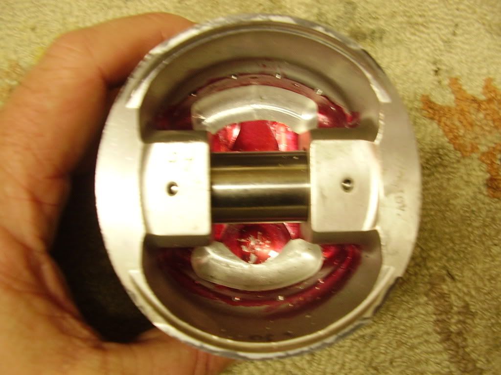

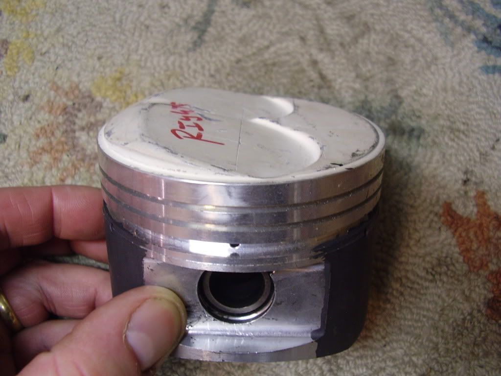

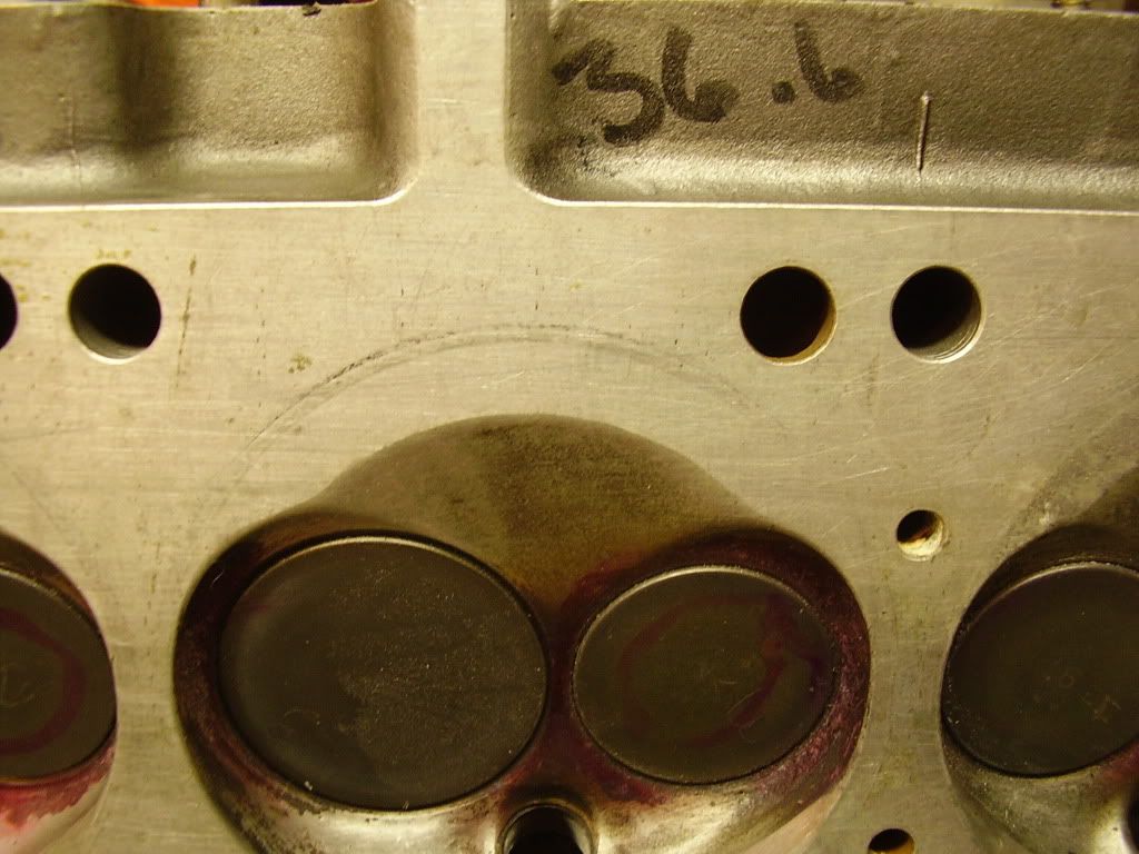

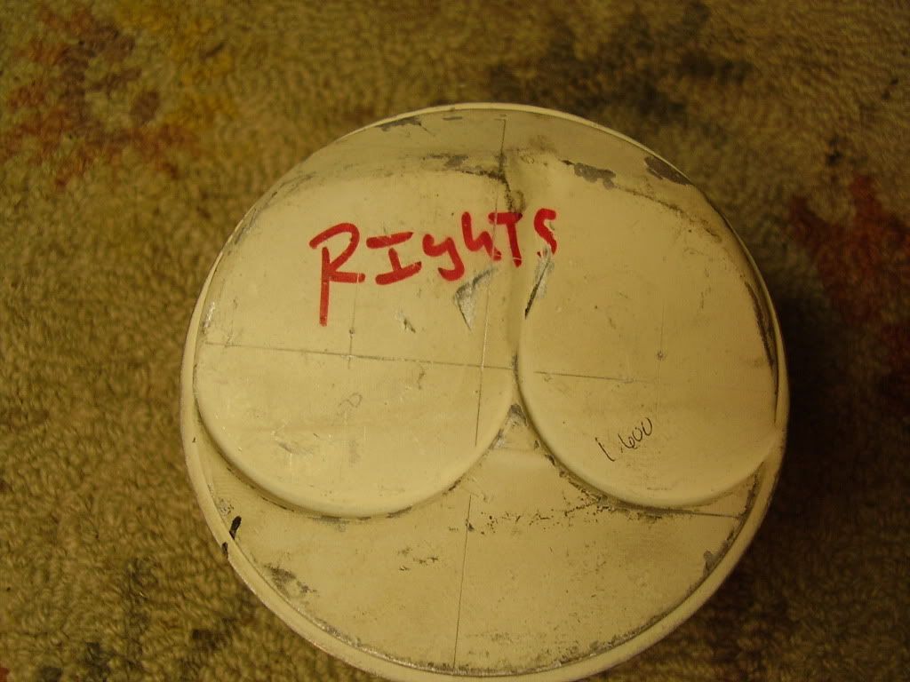

z-ya Posted September 27, 2010 Share Posted September 27, 2010 Here are some photos of a Bob Sharp GTU head I picked up with a bunch of other BSR stuff. It's and E31, and was most likely used on this car: I also have the port matched intake and Mikunis. Here is a piston that I believe was setup for this head: Quote Link to comment Share on other sites More sharing options...

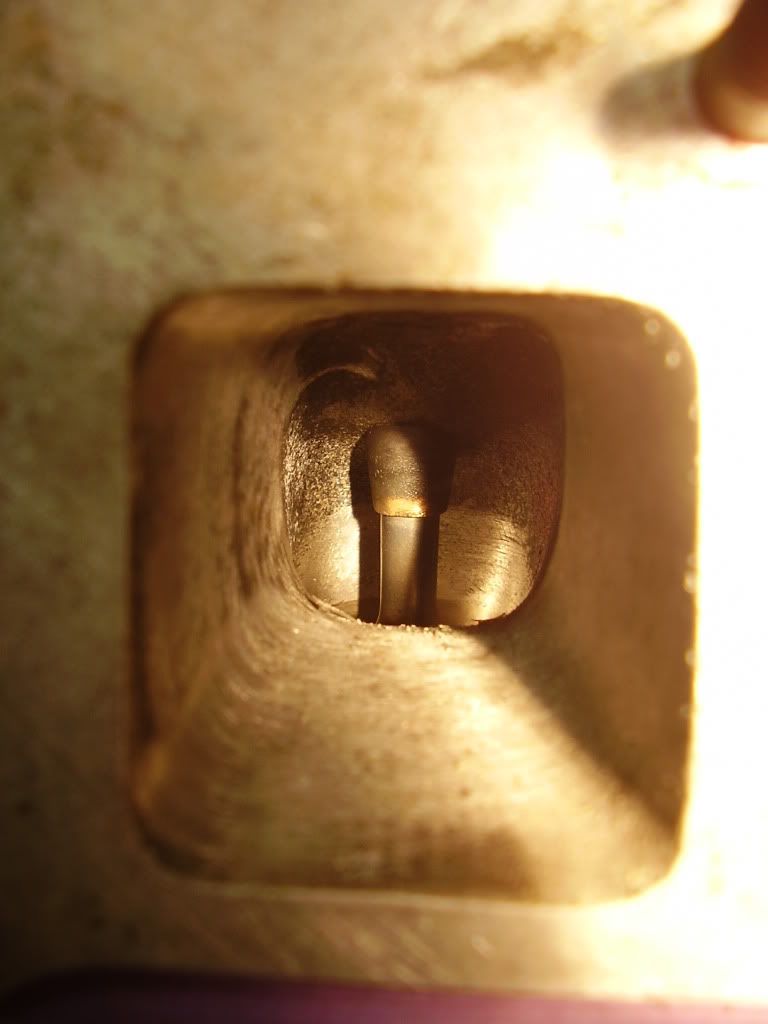

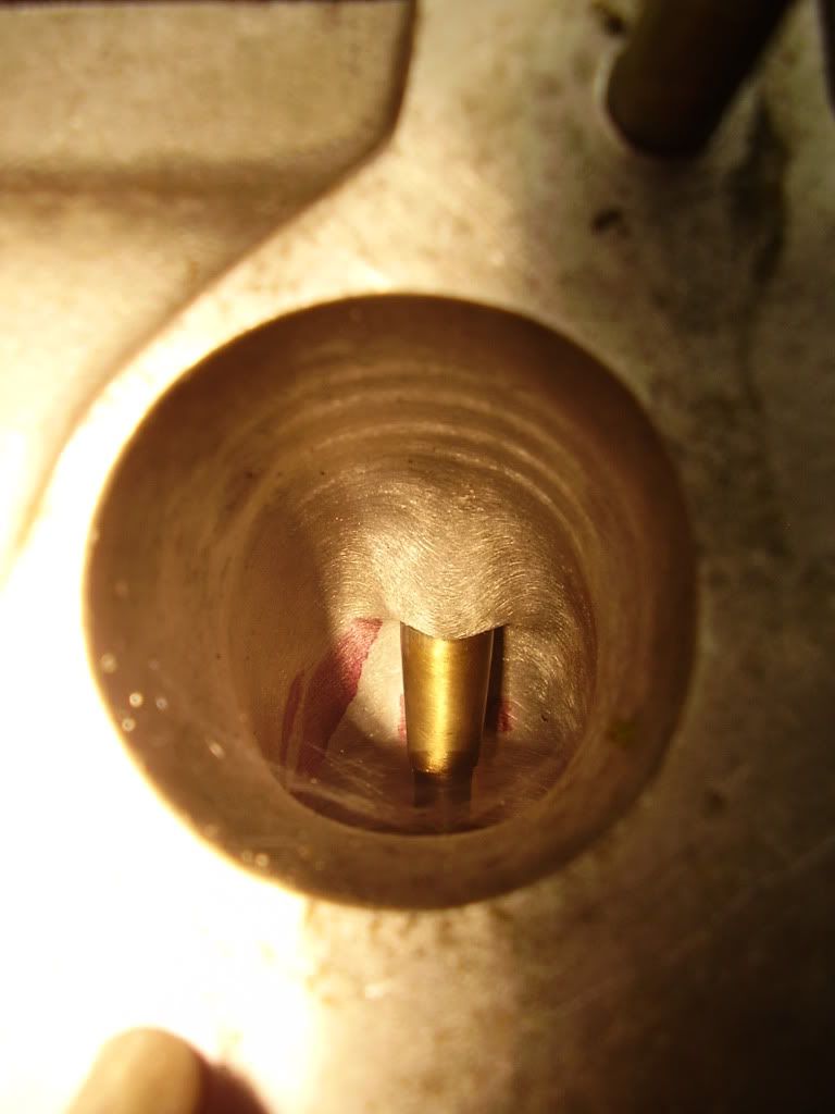

josh817 Posted September 28, 2010 Share Posted September 28, 2010 (edited) I don't like that you have that. LOL Can you measure the entrance to the intake and exhaust ports. Whats the diameter of the intake and then whats the height and width of the exhaust port square. I've got a head I just bought but don't know if its mildly ported or outrageously ported. Thanks! Edited September 28, 2010 by josh817 Quote Link to comment Share on other sites More sharing options...
z-ya Posted September 30, 2010 Author Share Posted September 30, 2010 (edited) I don't like that you have that. LOL Aren't you glad I shared the images? Intake ports are around 1 9/16" Middle exhaust ports are 1 1/2" x 1 5/8" Outer exhaust ports are 1 1/2" x 1 1/4" Edited September 30, 2010 by z-ya Quote Link to comment Share on other sites More sharing options...
josh817 Posted September 30, 2010 Share Posted September 30, 2010 Our intake entrances match. I'll need to look into on the flow numbers of my head. Perhaps I have a gem. I was thinking "meh its ported but we don't know if it flows well". I'm not going to get my hopes up just yet. Quote Link to comment Share on other sites More sharing options...
Tony D Posted October 1, 2010 Share Posted October 1, 2010 Definately looks ported for carburetion... Quote Link to comment Share on other sites More sharing options...

Gollum Posted October 6, 2010 Share Posted October 6, 2010 Definately looks ported for carburetion... (please don't kill me) Do you say that because the ports aren't raised as much as they could have been for that port size? Quote Link to comment Share on other sites More sharing options...

Tony D Posted October 13, 2010 Share Posted October 13, 2010 I've seen 44's run with no chokes. Not a street application for sure. I said 'looks like carburetion' because of the size of the ports. Running 50mm carbs makes for BIG runners to get the taper you need. You get the same power from 45mm ITB's as you do from 50 Carbs, but with much smaller ports, and higher port velocities. Quote Link to comment Share on other sites More sharing options...
