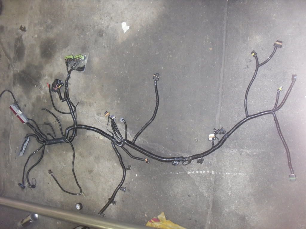

SUNNY Z Posted February 26, 2012 Author Share Posted February 26, 2012 I know you are looking at alternative fuel tanks. Below is a link to my tank. http://forums.hybridz.org/index.php/topic/105275-fuel-tank-conversion-ls1/ Danno74Z Well i'm not really looking. I have one thats been ordered.... thanks though update Spent a LONG ass time on the engine harness and body harness yesterday. To the tune of 7-8 hours. Found out that the moron who built the harness removed the high speed fan pin, so I'm currently looking for a pin to put in the PCM connector... :eyes: Other than that, I got the plate for the relays done, and the relay section of the harness, and the gauge portion of the harness shortened. I added weatherpack connectors to connect the engine harness to my dash gauges. Also, the trigger wire for the harness relay, and the trigger wire for the starter. Basically made the harness so i can pull it in about 5 minutes, only unbolting it from the starter. The remainder of the fuel system should be here tomorrow, then its off to the fab shop! slow progress.... Quote Link to comment Share on other sites More sharing options...

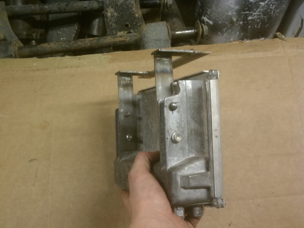

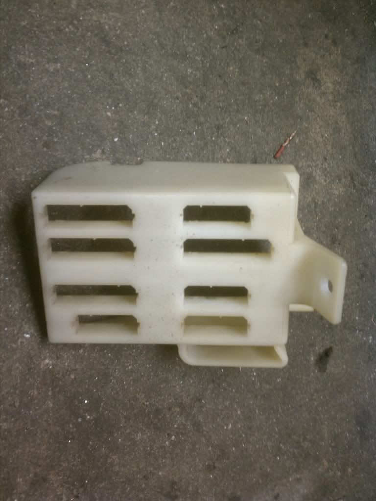

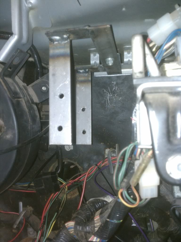

SUNNY Z Posted February 27, 2012 Author Share Posted February 27, 2012 (edited) Thanks for the info, but the wire is ran, and the harness is wrapped up. Basically everything is its own entity now. Also worked on mounting the PCM. Here's the PCM bracket that I built. I did some eyeball measuring, and I THINK that it will be free from interference with the glove box. If it does interfere, it is only a quick cut and weld away from fitting. This is what its replacing - as most of the factory wiring is gone now. Mounted With PCM Another fun filled day of wiring Whew it got late! Edited February 27, 2012 by SUNNY Z Quote Link to comment Share on other sites More sharing options...

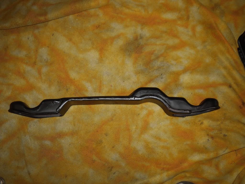

SUNNY Z Posted March 12, 2012 Author Share Posted March 12, 2012 Been busy busy busy, and most of its not with the car! Here's what I DID get done though. Dash Mounted I had to either rebuild or notch my tranny crossmember to clear my exhaust comfortably, so i notched it. And of course filled it. Started on the exhaust - its gonna tuck up REAL nice Ran out of straight tubing - going to the muffler shop now Quote Link to comment Share on other sites More sharing options...

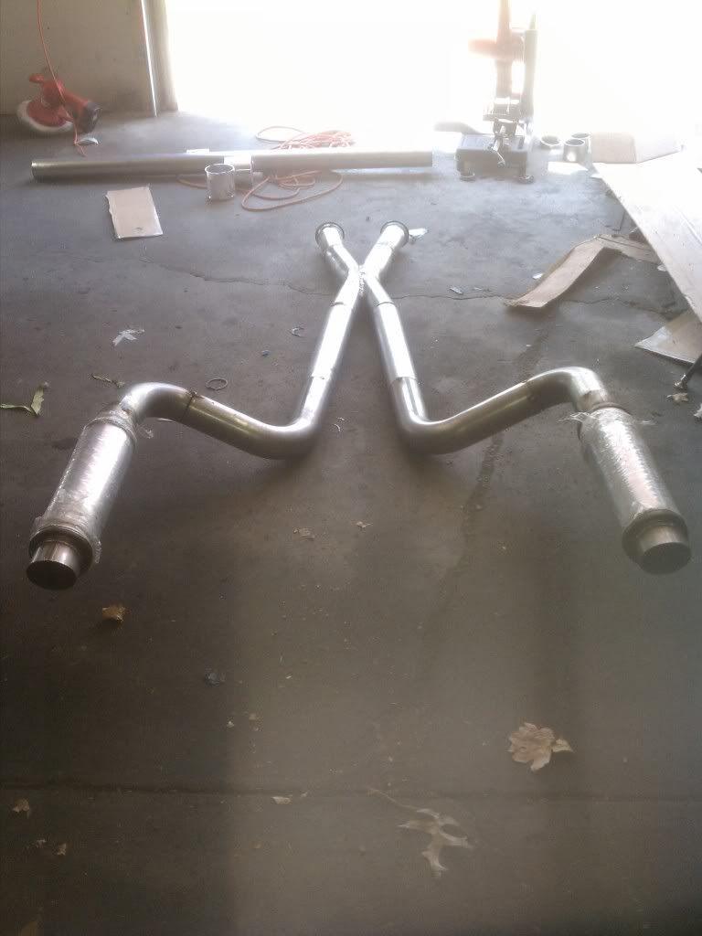

SUNNY Z Posted March 17, 2012 Author Share Posted March 17, 2012 UPDATE Finished up school .... until after spring break. So i rewarded myself with an afternoon at the shop. Got my harness finished!!!!!!! and installed. Its come a long way.... From this: To this: I also installed the rear LCA's. Shown here, fresh paint! I worked on my cold air intake. Hows it look? In all seriousness though, i did get it done. Then I went to work on the diff crossmember - clearancing it for my exhuast Started laying in strap... . Done prettyfied Then I worked on my crossver pipe. I was originally going to do an H, but i decided to try my hand at an X. Here's what i got. used two 45* bends, and a chopsaw. The tuck is nice. I wish my fuel tank would get here, so i could finish the rest of the exhaust! That's it and that's all. Quote Link to comment Share on other sites More sharing options...
alainburon Posted March 17, 2012 Share Posted March 17, 2012 Are you running dual 3" or 2 1/2"? Quote Link to comment Share on other sites More sharing options...

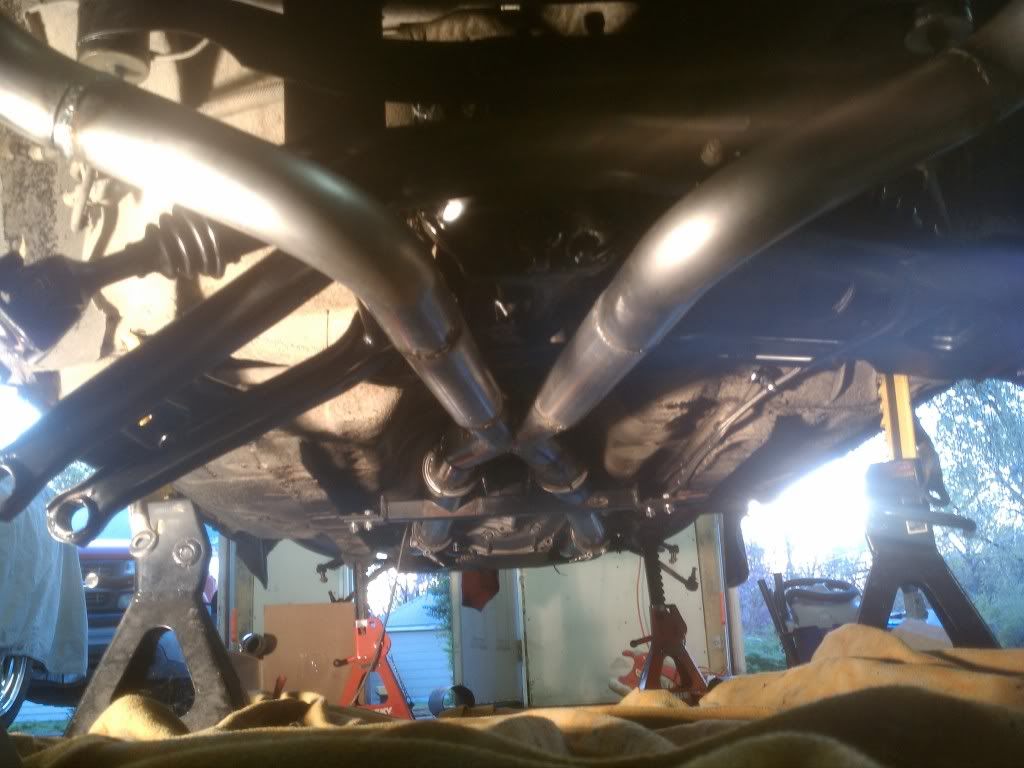

SUNNY Z Posted March 17, 2012 Author Share Posted March 17, 2012 Dual 3". The other engine I plan on putting in would have been choked by dual 2.5". Here's the rest of it! I got to the shop about 10:30 and JUST finished welding it. Forgot to take any on-car pics, but the fitment is excellent! This afternoon Im headed off to south TX for spring break, so I won't be able to do anything for a week. Quote Link to comment Share on other sites More sharing options...

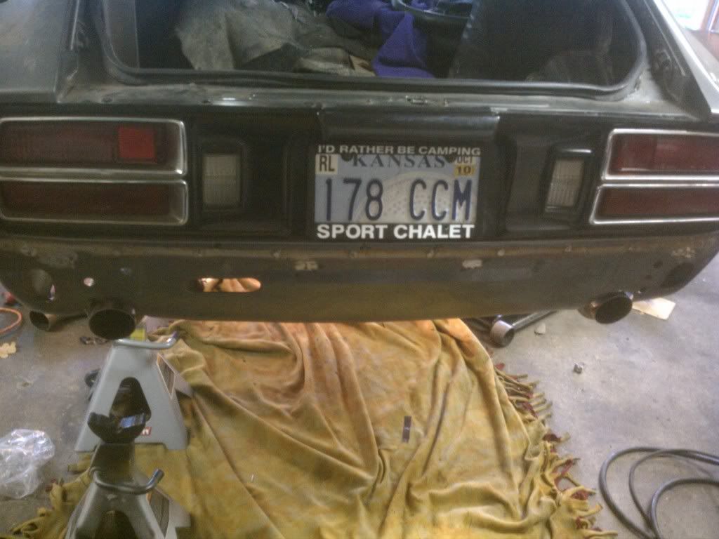

SUNNY Z Posted March 26, 2012 Author Share Posted March 26, 2012 Well I survived spring break (barely) And my camera didn't take kindly to the sand (big surprise there)... So i'm uploading the progress from my mobile. So I installed the exhaust for one final test fit before I painted it, and GUESS who forgot to tighten the front v-bands all the way before welding the whole thing up. THIS GUY. SO I ended up having to make about half a dozen relief cuts to get my tips where I needed them. Got it tacked again, and here's the pics. Now its back out, fully welded, and ready to be prepped for paint. Would have liked to have painted it tonight, but the parts store was closed before i thought about it Quote Link to comment Share on other sites More sharing options...

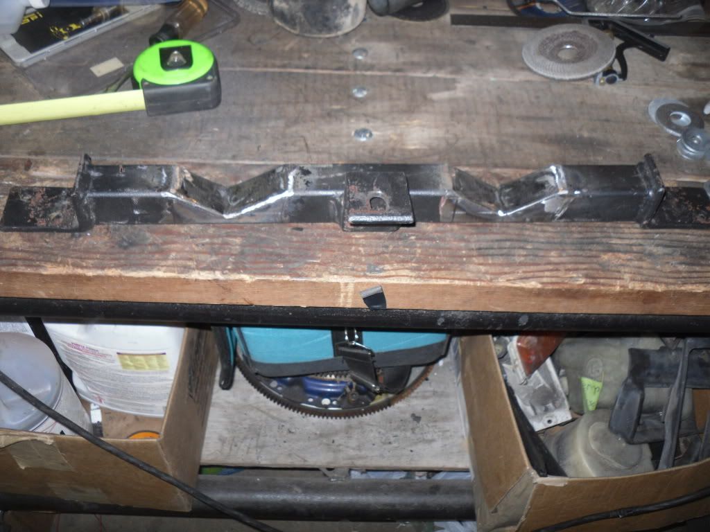

RebekahsZ Posted March 26, 2012 Share Posted March 26, 2012 I'm sure it wasn't simple, but it looks so simple and clean - Great job. I wish I had your fab skills. I really like your trans crossmember- I have the 240z JCI cross member, and I while have no side movement of my shifter, but I do have some up and down shake. Trimming the stock shifter boot is working fine. I went on a 2 hour "reliability run" yesterday and had no issues. So far, no tickets from the straigh pipes, but I rarely "open 'er up." It really isn't any louder than a Harley, and I never see one of them pulled over for noise. Thank goodness I'm in Alabama and not some big city. I did high-center the car on the dump tubes once on a driveway, so I gotta re-think my side exhaust. Still want them, so I may c-notch my frame rails and bring the dump thru the lower part of the front fender. No matter what fuel tank you use, I recommend spending the money for a shut-off type fuel filter before your pump, so you can clean it out with a full tank of gas. Plan for some flex in the lines so you can service it. I put the filter in, but did not use the shut off type (so expensive) but now wish I had - gotta find a little AN6 plug that I can put in the line quickly. Little bits of welding flash and other trash gets in there - I've been SO careful to keep my tank and fuel clean, but I'm going to be cleaning that filter regularly for a while. Before I installed my tank, I cleaned it with soapy water, solvent, gasoline, blew it out with air and reached in and rubbed around with a tack rag, and I'm still getting trash in the screen! I also mounted my Corvette FPR in a bad spot where I can't reach it with the tank installed, so do a little more backward planning than I did. I think the screen is catching enough to protect my FPR (I hope). So far, that is the only thing I would do any differently. Quote Link to comment Share on other sites More sharing options...
1 tuff z Posted March 26, 2012 Share Posted March 26, 2012 Josey, took the guy who will weld/fab my exhaust center section a picture of your tranny crossmember and told him I wanted something like that and run the exhaust the same-said no problem. Had my John's cars tranny crossmember [which I never really liked] blasted to remove the powdercoating which he may or may not use when the mods or new one is made. He'll do that same time as the exhaust. Pipse & bend should be here this week [sticking with the 304 ss] as well as brakes and I pick up the newly mounted tires [same wheels] tomorrow. Once all back together drive it to the shop [with open long tubes!] to get the exhaust and crossmember work done as well as dyno & tune! Quote Link to comment Share on other sites More sharing options...
SUNNY Z Posted March 26, 2012 Author Share Posted March 26, 2012 I'm quite flattered you guys, because I actually feel its kind of rough. If I had a band saw and a couple other misc. tools I feel I could do a better job. Quote Link to comment Share on other sites More sharing options...
