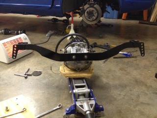

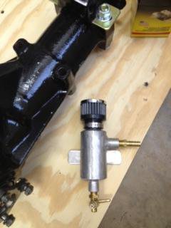

RebekahsZ Posted January 8, 2013 Author Share Posted January 8, 2013 (edited) Truck is in the shop, so I put Z-car on the ground and drove to work today. CLSD banged on first left turn, then on first right turn, then all was well, with no banging on trip to Subway for lunch. Car (seems) much more mellow with the 3.54. I don't have that much experience playing with different ratios, but it dropped rpms a lot. First gear now has a role to play. Time will tell how my 60' times suffer. If anybody falls in love with my differential puke tank, I had is custom made at Alabama Hose in Muscle Shoals, Alabama. Cost? I bartered for medical services (removal of metal from eye). I got the better end of the deal. Edited January 9, 2013 by RebekahsZ Quote Link to comment Share on other sites More sharing options...
RebekahsZ Posted January 13, 2013 Author Share Posted January 13, 2013 Finished the front droop limiter brackets (will take to be welded on Monday). Finished frame rail reinforcement plates/jacking points. Removed straight "cattle catcher" to protect oilpan and fabbed a triangular cattle catcher (to pitch road debris to the side rather than trappping it under my front crossmember. Cleaned garage. Helped my buddy with his AC Cobra replica. Took my daughter to supper. Tomorrow is to put together sketches for driveshaft loop to take to my fabricator so he can get all the welding done for me when I drop car off for the week. Big goal for tomorrow is to put together my exhaust parts list. Quote Link to comment Share on other sites More sharing options...

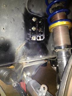

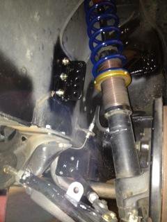

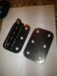

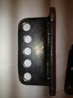

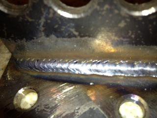

RebekahsZ Posted January 25, 2013 Author Share Posted January 25, 2013 (edited) Pics of front droop limiter brackets. These "sandwich" the sheetmetal of the inner fender below the strut tower where the metal is 2 layers thick. Once I get them bolted onto car I'll be ordering straps. Whit Lyles as Red Wrench hotrod shop in Muscle Shoals is a great welder-looks like aviation quality welding to me (what looks like voids in this photo are not voids, the are just shadows caused by the flashbulb). Wish I had some clue of how much droop I should allow as a starting point to adjust from-anyone? Edited January 25, 2013 by RebekahsZ Quote Link to comment Share on other sites More sharing options...
rsicard Posted January 25, 2013 Share Posted January 25, 2013 RebekahsZ: Very much interested in the droop limiters both front and rear. I need to do the same to my 240Z to eliminate the float of the springs when the struts are drooped. Please post more photos of the completed installation both front and rear of the upper and lower limiter brackets and the source of the limiter cables. I purchased an Aviation Nico-press crimper especially to fabricate the limiter cables. Thanks much for showing your work. Quote Link to comment Share on other sites More sharing options...

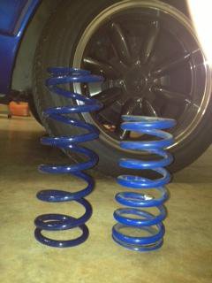

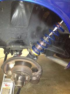

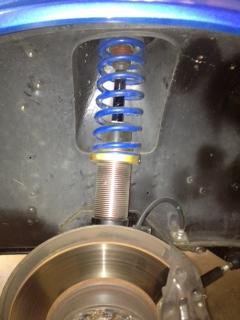

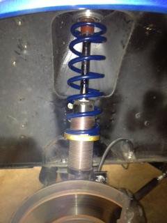

RebekahsZ Posted January 27, 2013 Author Share Posted January 27, 2013 Got droop limiter brackets mounted and ordered some straps, so that job is almost finished. Looks like 10" for back and 9" for front. V-bands, exhaust cutouts and various other exhaust parts arrived. Cutouts are from QTP. I'm gonna go ahead and order a set of Doug's Headers cutouts too and return the one I don't use. Seems each design has its merits and limitations. i have to remember, I'm runnning these to make noise first and power a distant second. Cleaned and painted front swaybar mount reinforcement and jacking plates. Painted cattle catcher. Swapped my front springs from 8" to 10" and raised front ride heighth 1 inch from where I had it before (being overly low looks cool but is a royal PITA. The fabricator made me another clutch master cylinder support rod-with only one on one side, the master cylinder was wagging like a dog due to firewall flex. Much better now. Pushed front camber plates all the way in, preparing for autocrossing hopefully in March. Quote Link to comment Share on other sites More sharing options...

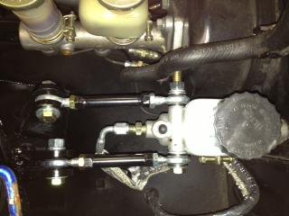

1 tuff z Posted January 27, 2013 Share Posted January 27, 2013 Keith, we need bigger pics-when opened [at least on my pc] they're only about 3" square-teasers! I'm especially interested in the master cylinder support setup-been thinking about that for my z... Quote Link to comment Share on other sites More sharing options...
