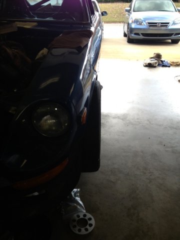

RebekahsZ Posted October 1, 2013 Author Share Posted October 1, 2013 AZC Brake kit arrived. Ordered bolt-on 1.25" spacer adapters for the rear to use with the 15" draglites I drag with. Getting ready to order Z Force Productions BAMF carbon fiber flares so that I can go to 8" rear draglites with 28X10X15 MT ET Drags next year and 275/40/17 autocross tires on some Rota 17X9.5s. Chrome moly 6-pt NHRA roll bar planned after installing Kirkey Economy Drag 20-degree layback aluminum seats. Also plan to finish fender exit exhaust with electric cutouts. Brakes have never been the same after my trip to AMP. I am not impressed with Hawk HPS pads, although the trouble with braking could be my rotors as well. Gonna throw in the towel on the drifting hand brake when I convert to AZC brakes-that project was a total fail. Will just roll with no parking brake, cause I can't friggin' stop at the autocross, and I need all 4 wheels contributing-the maxima rears were a total fail, too. Big winter plans, but I may be finished racing for the season due to family stuff and my mother moving here from Arkansas. Will be busy every weekend getting her out of the homeplace where she has been for 42 years. Quote Link to comment Share on other sites More sharing options...

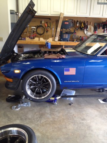

RebekahsZ Posted October 15, 2013 Author Share Posted October 15, 2013 Invoice for Konis from johnc came thru today and RBR order was finalized. I'm out of money and brake fluid (a crappy combination that seems to always rear its head when I'm doing brakes). Gonna try to get all these parts on the car and hopefully have a good month and re-charge my car account, so long as Congress keeps paying thru Medicare I should be ready for more spending come Nov 1. Dropped exhaust and pulled CV axles (I love those things) and got the big ass nut off the axle stubs. Thanks to my lovely wife for mashing the brakes while I broke fasteners on the drivetrain loose. With the crappy Maxima calipers, it took full force on the foot brake, hydraulic handbrake and cable-operated parking brake to hold the wheels still enough to get the stub axle nuts broken loose. Luckily I anti-seized the crap out of everything, so the CF companion flanges came off by hand-the M2 flanges needed a gear puller to remove. Got rid of the aluminum/delrin rear LCA bushings and swapped in polyurethane bushings (liberally greased per a recent thread about squeaky bushings). The delrin gave me more tire clearance, but gosh they were clunky and noisy, and photos show that they did nothing to control LCA flexing on drag strip launches. Tomorrow night I hope to get to the point of pulling stub axles. Then out of town for three days, then I should have all my rear brake kit first mock-up done before the weekend is over. I think the driveshaft is gonna have to come down AGAIN to remove the parking brake assembly. Oh well, anything worth doing is worth doing twice, or three, or four times.... Quote Link to comment Share on other sites More sharing options...

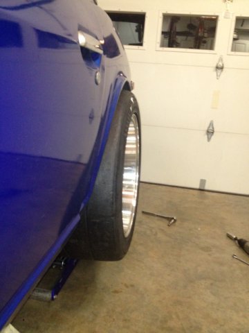

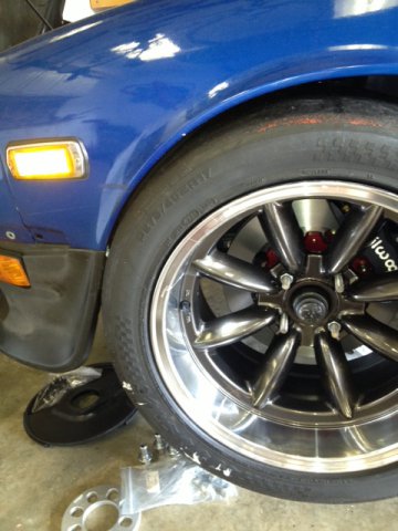

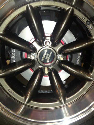

RebekahsZ Posted November 3, 2013 Author Share Posted November 3, 2013 The old dude with the pipe wasn't at work on the day I took my tires to get mounted. The young guy with the tattoo only gouged one of them...honestly, I don't know how you avoid gouging a soft metal rim when mounting super stiff race tires, so I wasn't too broken up about it-its a race car and an off-track excursion would likely do far worse. When I ordered my wheels from racinglab, I went ahead and ordered 4 of the 17X9.5s just in case they got discontinued at some point. I have accepted the need to flare the rears, but I am just not ready to flare the fronts, but it is a much easier process should I decide to do it in the future. I'm starting to think about sending back the two that I still have in the boxes and buying a pair of the 17X8.5s that have an offset that is more toward the strut. The 9.5s only come in one offset and are spaced pretty far away from the coilover strut, so I could afford to push under more. Plus the Hoosier R6 275/40/17 is a little "stretched" on the wheel even though Hoosier's fitment guide recommends at least a 10" wheel-I think I'd be fine running 1" more narrow if I limited my width to 275s up front. At the moment, the 17s look huge, but they are actually only 1" taller than my 16s with 245s on them. Plan for the moment is to run 17s in rear and 16s in front-we'll see how that works out. Made some progress on the rear brakes. Made a drawing using an elementary school compass, then scribed and cut the extra brackets ($39 each). This was super easy. Drilled holes in a piece of 1/4" steel to use as a fixture when the welder tacks everything up. Hopefully, everything will stay straight. Had to "clearance" a little on the cast portion of the rear hubs to be able to install and remove caliper mounting bolts; the brake line will clear well too. The brake line will likely conflict with my droop limiter, but I usually don't run them in back. Will need custom flex hoses for the rear, but I think this is gonna work and work a lot better than my Maxima setup. Hope to finish the bracket trimming and sanding today and have the brackets ready to go on next weekend. Final picture is the door bar arrangement I hope to use, or some modification thereof. I really want to connect my firewall to the back of the car to stiffen up some. Quote Link to comment Share on other sites More sharing options...

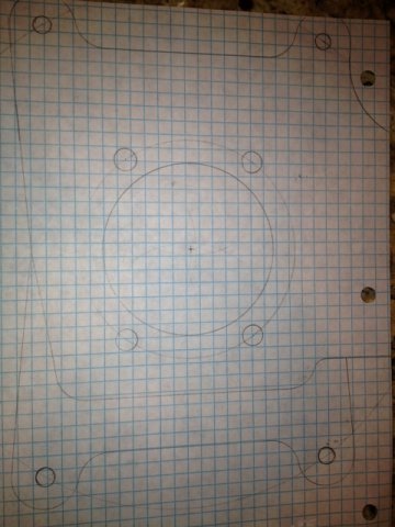

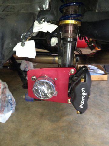

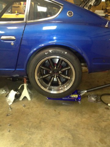

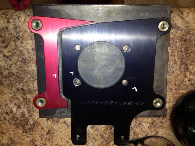

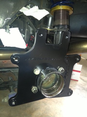

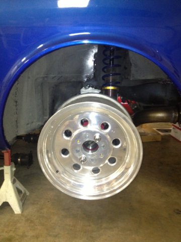

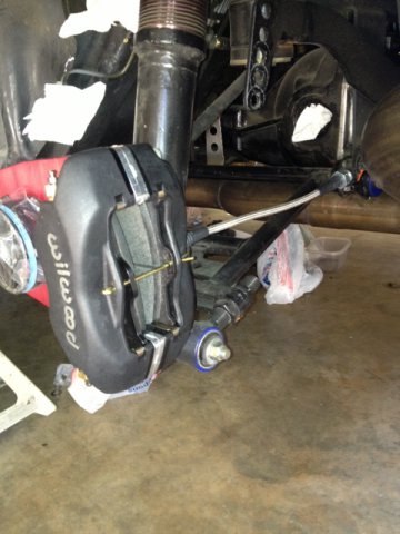

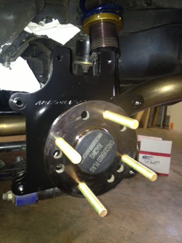

RebekahsZ Posted November 10, 2013 Author Share Posted November 10, 2013 Got one side of the rear brakes mocked up-perfect fit so far. Trial fit all my different wheels. As expected, need the ZG flares-they are to arrive Monday. Hope to get passenger side mocked up tomorrow, then start on modifying hard brake lines. Will definitely need the 1" bolt on spacers to use my 15" drag wheels, but looks like it is going to fit fine with that modification. The 16" and 17" Rotas fit fine. Quote Link to comment Share on other sites More sharing options...

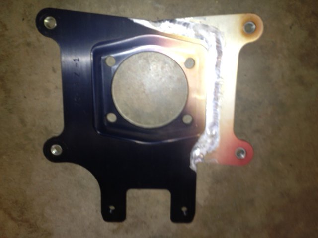

socorob Posted November 10, 2013 Share Posted November 10, 2013 That's some back plate! Quote Link to comment Share on other sites More sharing options...
rturbo 930 Posted November 10, 2013 Share Posted November 10, 2013 (edited) Sorry if I missed it, but what was the modification for? Looks like you're gonna have 3 different calipers mounted there. What bolt patterns are on your stub axles? 4x4.5, 5x4.5 and something else? Did you order them like that to keep your options open or are they all like that? Edited November 10, 2013 by rturbo 930 Quote Link to comment Share on other sites More sharing options...
RebekahsZ Posted November 10, 2013 Author Share Posted November 10, 2013 2 calipers per side for now, plus parking brake caliper if I can figure out cable routing. Car is multisport: street, drag, autocross, road course track day, and is like to even do a solo drift event if I can find one that is in a super safe venue (cones with no walls or curbs). The hydraulic handbrake I ran for the past year was really helpful for trailer loading and drag racing. And, if it cost me any horsepower, the dyno didn't show it. So I'm just having fun. The chequered flag billet stubs come in dual pattern. If I had owned them before I bought like five sets of four-lug wheels, I would have converted to five lug. Quote Link to comment Share on other sites More sharing options...
