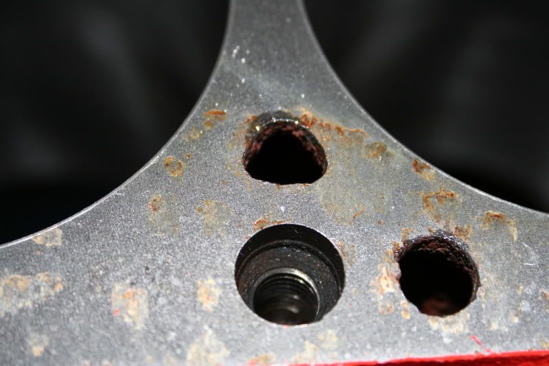

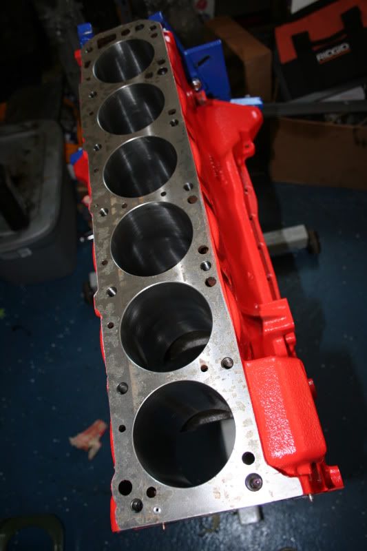

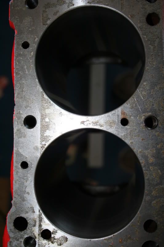

Oddmanout84 10 Posted January 30, 2011 Share Posted January 30, 2011 (edited) So I've been carefully prepping my block for the past couple months in order to rebuild my L28ET. The block was hot tanked, rebored .50mm over and the gasket surface was trued. Since then I've been carefully cleaning every passage, wiping down the bores and keeping it coated in WD40. Two days ago I cleaned off the outer surfaces to remove the oil coating so I could paint the block, and taped the machined surfaces to protect them from overspray. The head surface was particularly hard because I left a thin film of oil that made the tape a little challenging to stick. Eventually I succeeded and painted the block and its been drying in my heated garage for the past 24 hours. This morning I removed the tape and found this. I'm furious. No matter how careful I've been, it looks like flash rust STILL found a way to work its way in and piss in my cheerios. I'm hoping I'm not completely screwed and have to get the gasket surface redone at the machine shop. Its bad enough that I have to find a way to clean it all off and then was the block off AGAIN to get rid of any residue. I guess what I'm asking is, is there any better method I can use to clean the surface without messing it up, and dry it so it won't flash again? And, at the same time, how can I remove this stuff without destroyed the gasket surface? So far every time I've pressure washed it, I've immediately coated it in WD40 to disperse the water, blasted it with compressed air to shed the water, then wiped the surface with a cloth and applied another coating of WD40. So far its not working. Edited January 30, 2011 by Oddmanout84 Quote Link to post Share on other sites
stprasinz 10 Posted January 30, 2011 Share Posted January 30, 2011 dampen a cloth with some sort of rust remover, like clr. Or have you elbow greased it with a good clean cloth... you could even take the green scotch brite and lightly hit only the areas that are troubleing you.. others should chime in don't loose sleep all is not lost..... Unless you would send it all to me if it is all lost then it is send it to me lol.... no really though you'll be fine...... I've never surfaced my block, and I know I've had some impuritys and I always seal up nice Quote Link to post Share on other sites
josh817 15 Posted January 30, 2011 Share Posted January 30, 2011 (edited) I wouldn't use WD-40... I remember sanding down a BMW hood and coated it with WD-40, a week later it was all surface rusted. WD-40 is actually a degreaser, I think. I remember seeing something like someone was trying to preserve a rear end so they filled with WD-40 and it got pretty messed up. What I did on mine was just get typical motor oil and wipe down everything. At our shop we have a squirt bottle with whatever type of oil, anything from motor oil to Marvel Mystery Oil. Squirt some of that good stuff on a lint free cloth or on your hand and go from there.... Sounds kind of dirty. I think a Scotch Brite pad would do well, like STP said. It shouldn't be rough/hard enough to scratch the surface. Edited January 31, 2011 by josh817 Quote Link to post Share on other sites
rayaapp2 4 Posted January 31, 2011 Share Posted January 31, 2011 scotch brite pad lightly on the surface. In shops techs use a similar pad to clean up the surface. Your really not going to hurt that surface with a scotch brite pad even if you rub it in... As long as you end up with a semi-rough but true surface the gasket will seal just fine. You'll notice that the machine surface isnt polished smooth. That is on purpose. It helps the seal from what Ive been told. You should be able to confirm this with your machine shop. If you get worried about messing up your surface use a straight edge and a feeler gauge to check it. WD40 = "Water Displacement formula # 40" It works to keep water out for the most part. For shelf life tackier oils work better and can be cleaned off with brake cleaner. I like to use assembly lube or pneumatic tool oil to coat stuff. Its messy and removing it in your case with brake cleaner would most likely result in paint damage. I find it easier to leave the deck coated in oil, cover the bores, and then paint. A new razor blade easily takes the over spray off and the oil prevents it from sticking to the deck surface. Ray Quote Link to post Share on other sites
Oddmanout84 10 Posted January 31, 2011 Author Share Posted January 31, 2011 (edited) Thanks for the tips guys! I have worked with scotchbrite before, and was afraid it would be too aggressive and messy for the application, but it worked just fine. You can't really even tell the stains were there anymore, and now the surfaces are coated in Marvel Mystery oil. Smells minty. The surface is so true that I can't fit anything under my straightedge. Not even light. I'll probably end up flushing the oil passage again though just to make sure no bits got in there... Edited January 31, 2011 by Oddmanout84 Quote Link to post Share on other sites

cygnusx1 12 Posted January 31, 2011 Share Posted January 31, 2011 (edited) I bet the glue on the tape or the tape itself just "wicked off" the WD40 in the places where you pressed it hard. Condensation or not, there is moisture in the air that hunts all things Datsun. I am going to say that an evenly, lightly, rusted surface might give a good "bite" to the head gasket. Of course I am just surmising. But that amount of rust should cause no trouble at all. Even if you left it alone. Of course, you did the right thing. Scotchbrite by hand will hardly touch the surface finish of the super duper Japanese cast iron. BTW..masking surfaces with grease, that you don't want to paint, is good practice. Edited January 31, 2011 by cygnusx1 Quote Link to post Share on other sites

cygnusx1 12 Posted January 31, 2011 Share Posted January 31, 2011 (edited) I have tried masking with grease as my uncle taught, but have had very limited success. Perhaps I've just been using the wrong grease or technique. It always seems to "seep in" and mask the areas that I don't need masked. Yeah that can happen, and then cleanup can be messy too. BTW the block looks great. What paint did you use POR15? Here is a great 101 article on gasket sealing, including surface finish. http://www.rlengines..._L_Engines.html Edited January 31, 2011 by cygnusx1 Quote Link to post Share on other sites
Oddmanout84 10 Posted January 31, 2011 Author Share Posted January 31, 2011 (edited) Yeah that can happen, and then cleanup can be messy too. BTW the block looks great. What paint did you use POR15? Here is a great 101 article on gasket sealing, including surface finish. http://www.rlengines..._L_Engines.html Thanks! That was a pretty good read. Actually, its Duplicolor/Rustoleum 500 degree rattle can engine paint (with "ceramic"). I've used it to great success a number of times, as has my uncle on his 944. It seems to hold up on the block surface and valve covers really well, though I wouldn't dare trying it on anything hotter. Finish is durable and shiny as long as the surface is prepped well. My uncle actually uses it on just about everything under the car, including suspension pieces. Edited January 31, 2011 by Oddmanout84 Quote Link to post Share on other sites
