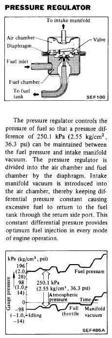

NewZed Posted March 14, 2011 Share Posted March 14, 2011 I would read this thread before doing too much else - http://forums.hybridz.org/index.php/topic/95316-braaps-l6-efi-induction-advice-and-tips/ 56 psi with bigger injectors doesn't fit. That would give a LOT more fuel over stock since the ECU just controls open time of the injectors. Double whammy on fuel enrichment. ~ 36 psi is the stock setting with stock injectors. Your AFM has a screw for adjusting idle air volume, to lean out or richen the idle mixture. It's on the side under a rubber plug. And the ECU adds fuel when the TPS is at the idle setting. Idle mixture is essentially separate from everything else, so probably shouldn't be used for tuning for driving. Quote Link to comment Share on other sites More sharing options...

richracing Posted March 14, 2011 Author Share Posted March 14, 2011 oh, i forgot to mention the reason I bought and adjusted the FPR is because the PO had blocked off the return on the fuel rail, and the fuel pressure was at 80-90 psi i put a factory fpr from my 280zx on it and got the fuel psi to 34'ish, then it ran really lean, (didnt have my wideband at that time, but the plugs were covered in white nastyness and didnt run so great) When I got my Fuel Lab FPR and wideband in the mail and installed, I adjusted the fuel psi until i got 14.5 - 15.0 afr at idle. Quote Link to comment Share on other sites More sharing options...
boardkid280z Posted March 15, 2011 Share Posted March 15, 2011 55 psi is still pretty high. I'm not sure what the AFR is supposed to be at idle, but there's a good chance it should be more lean than 14.5-15.0. If it ran lean at 34psi, you probably don't have bigger injectors. The stock fuel system is designed to run at 36psi, so that is what I would shoot for. As long as lowering the fuel pressure doesn't lean the AFR out so much that it stops running smoothly, adjust the fuel pressure: What AFRs were you seeing when you had the fuel pressure was at 34? 13.5 is about what you should shoot for at WOT on an N/A engine. Any richer than that and you're wasting fuel. Any leaner and you might be running too hot. But usually a lean or rich condition can't damage a N/A engine like it can a turbo engine. Check your TPS and make sure it is working correctly too. Quote Link to comment Share on other sites More sharing options...
