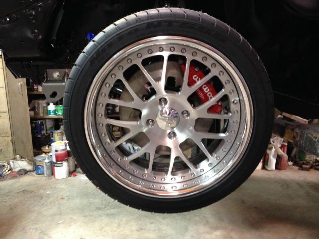

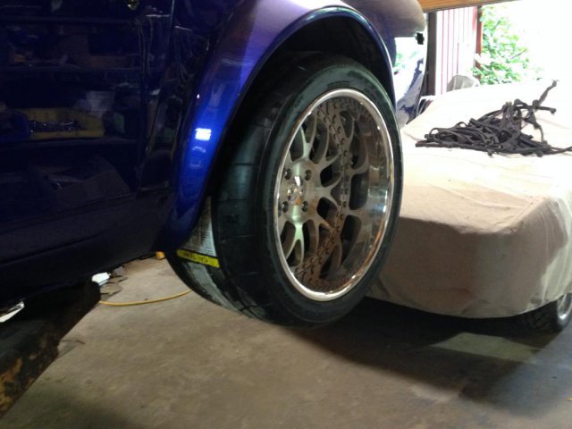

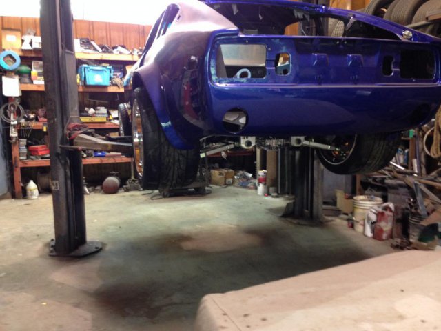

alainburon Posted June 27, 2015 Author Share Posted June 27, 2015 After 3 long months of waiting the wheels finally arrived. Now the car can be moved in order to wetsand it, buff it and assemble it. Thanks to Texis300 and thezguy for your help today, Quote Link to comment Share on other sites More sharing options...
