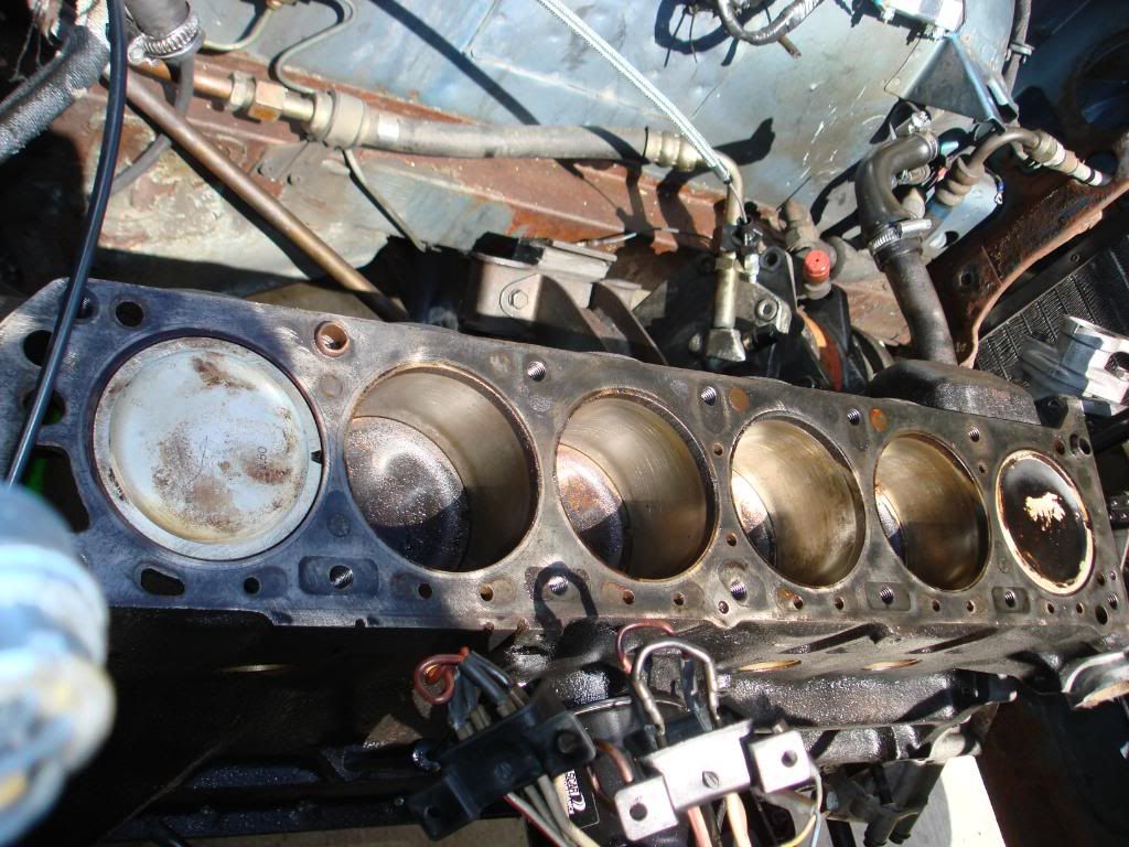

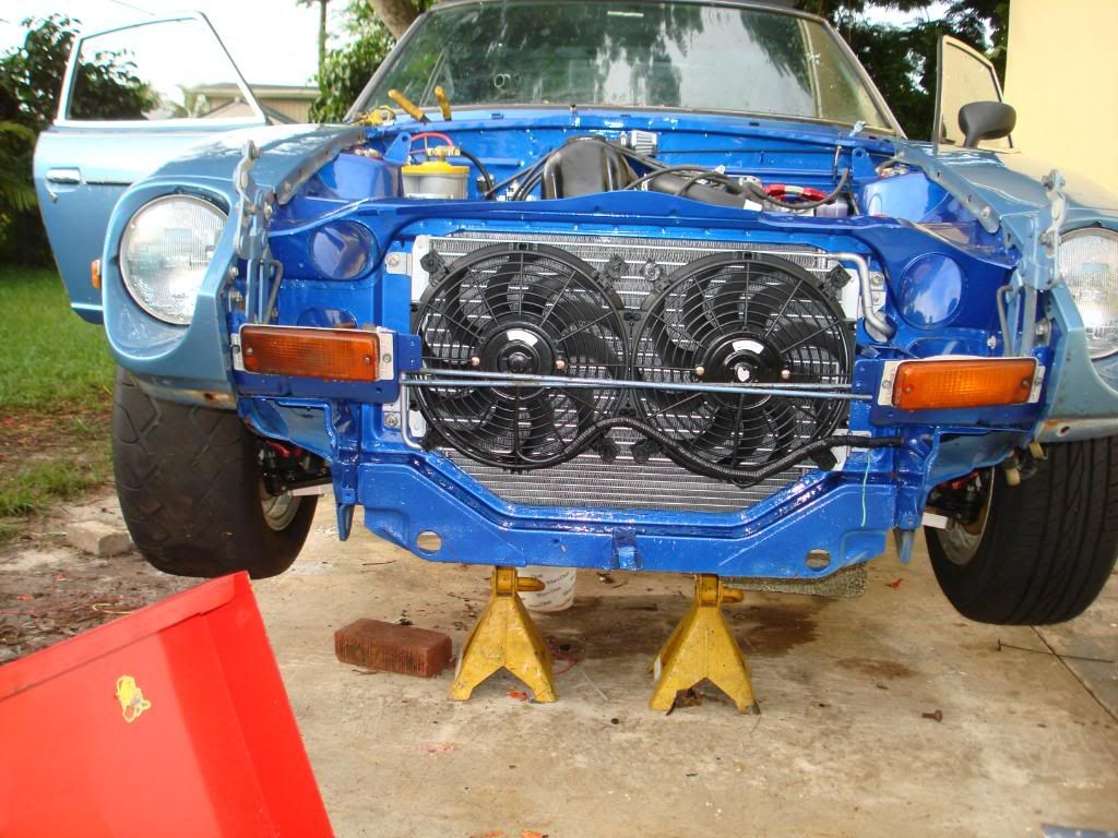

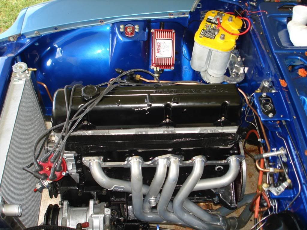

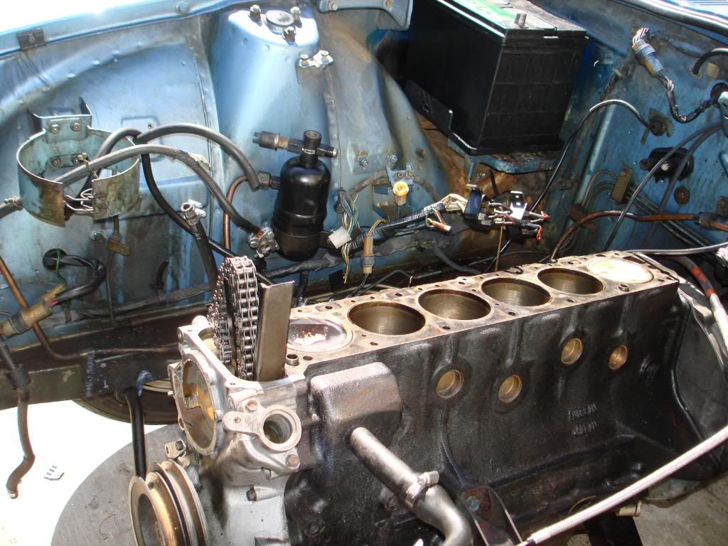

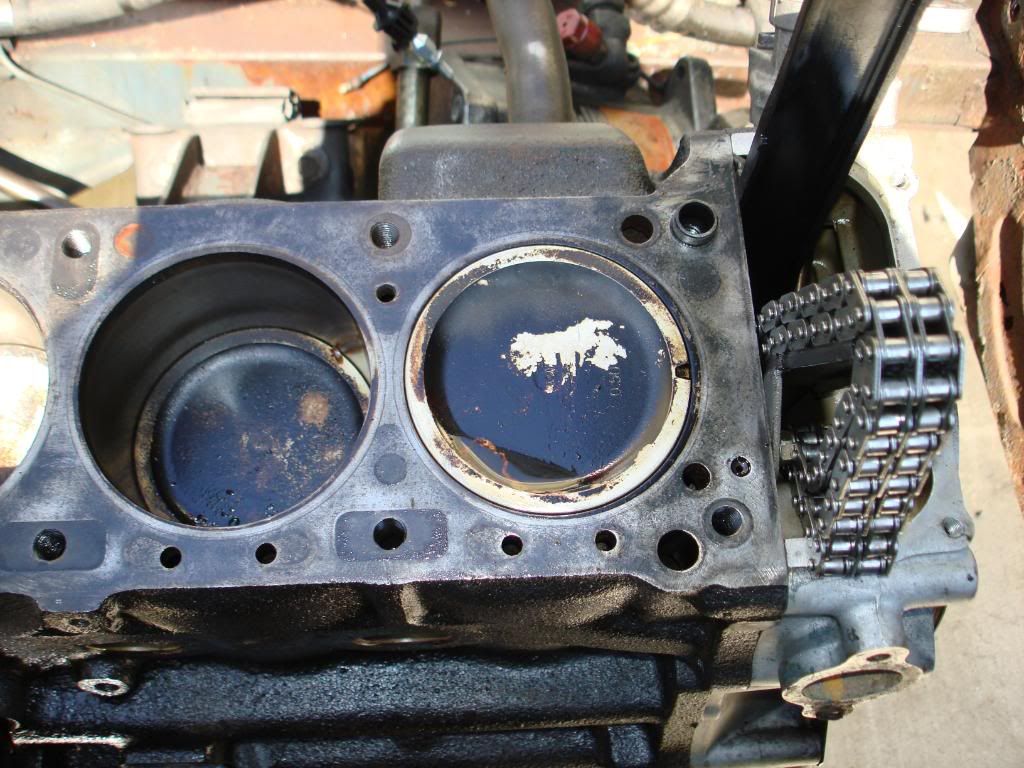

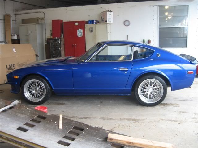

Hey guys I've been a member of this forum for a while but this is my first post(LOL). This forum was helpful throughout my entire build and decision making process, I thank you all. We have been working on it for 2 years now. It was originally my neighbor's car, she was the first owner and she droved it till the day it died. When I bought it and revived it. I took it to a local shop (a story for another time) and had the motor rebuild, drove it around for a month or 2 then we noticed the head gasket was blowing oil from the side. Oil will blow though the cap and well, you get the picture. So it was then we decided to evaluate the entire process...What's our horse power goal, what budget, what engine? When parts start coming off, there is really no end to it. The rest is my story...

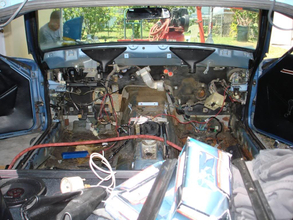

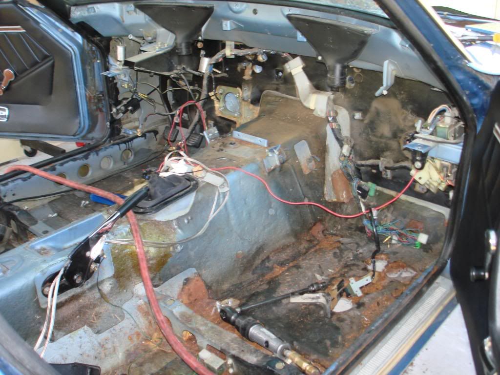

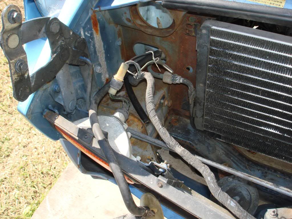

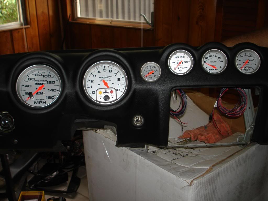

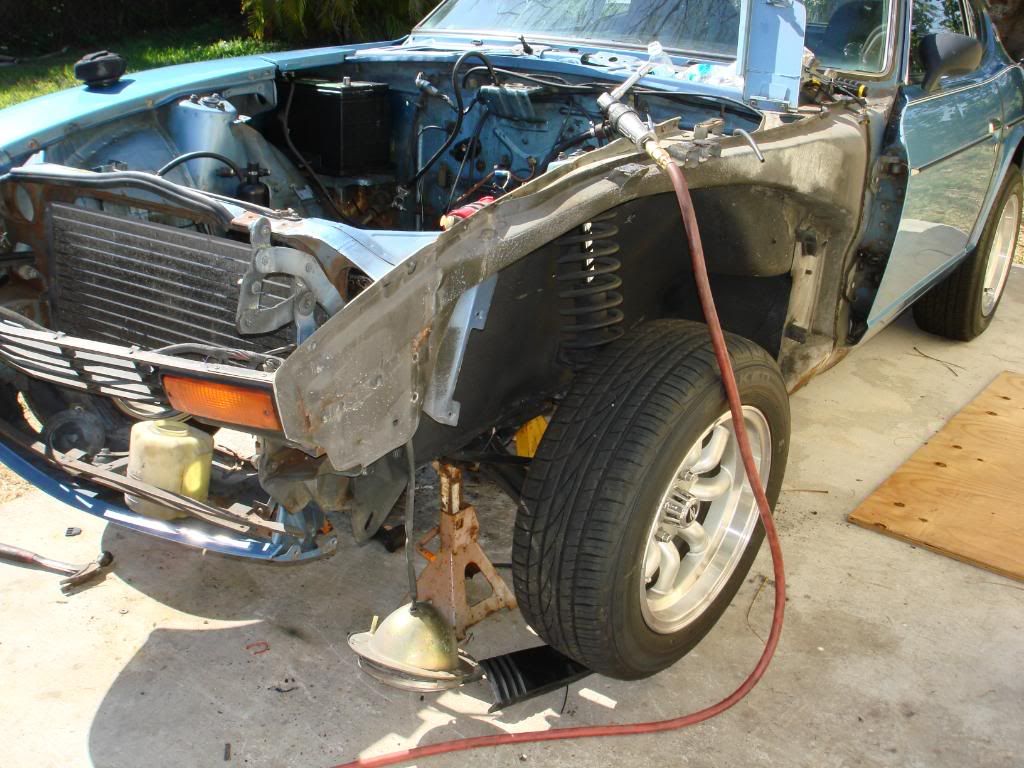

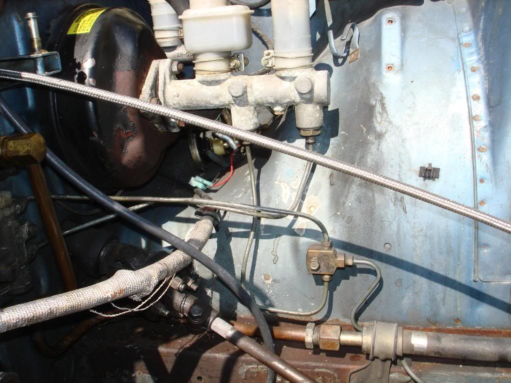

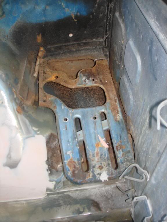

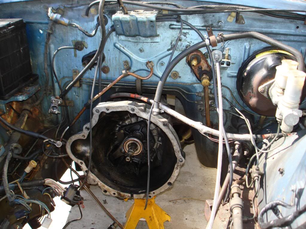

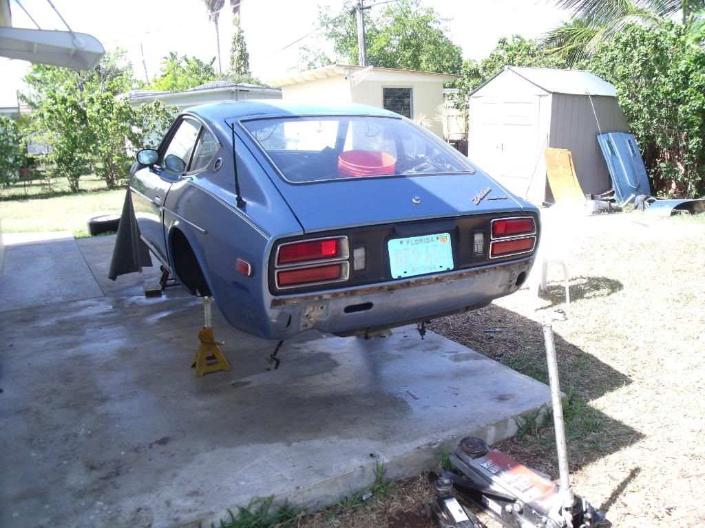

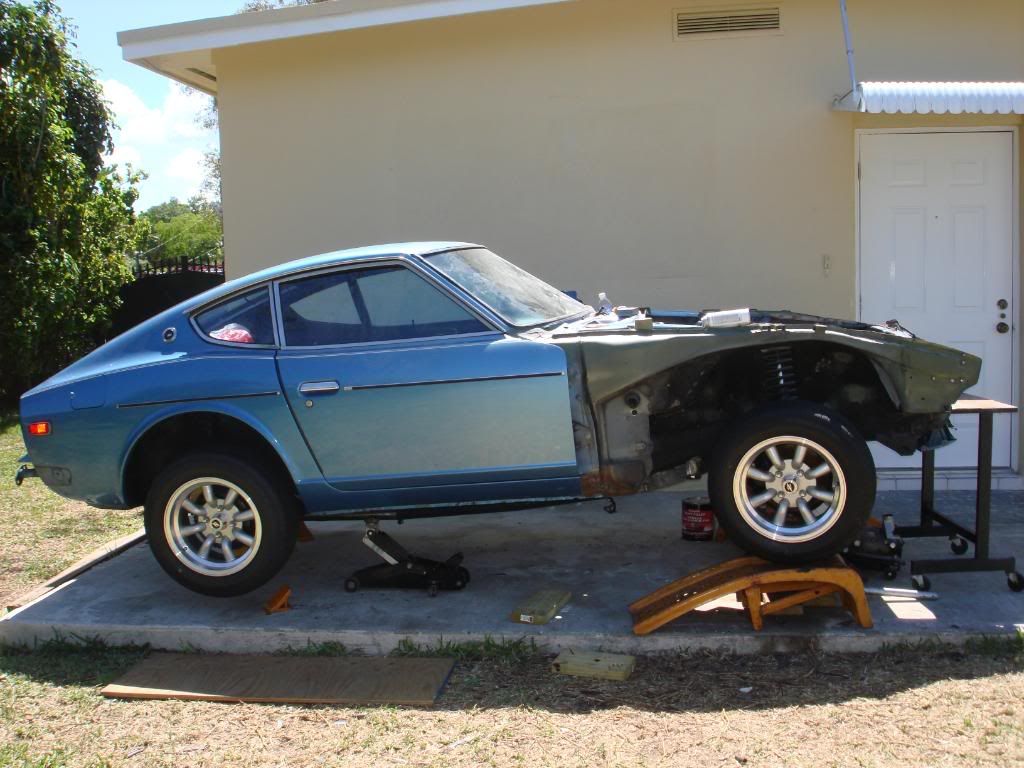

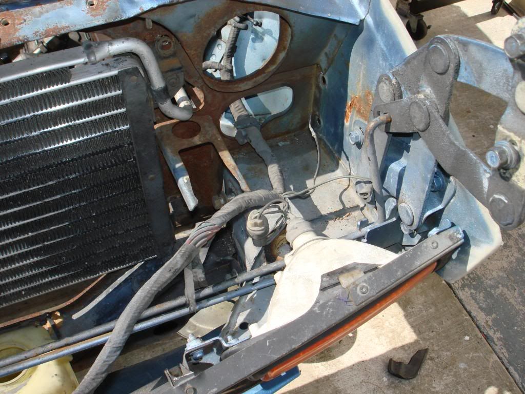

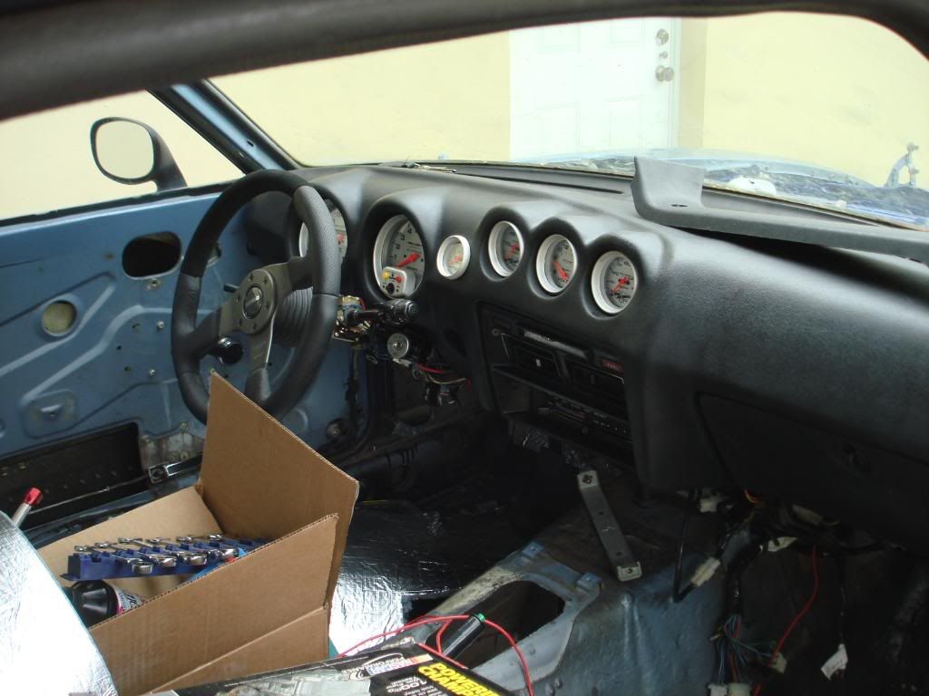

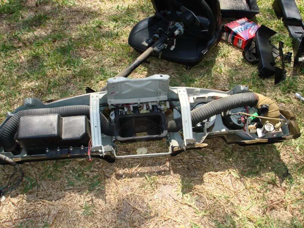

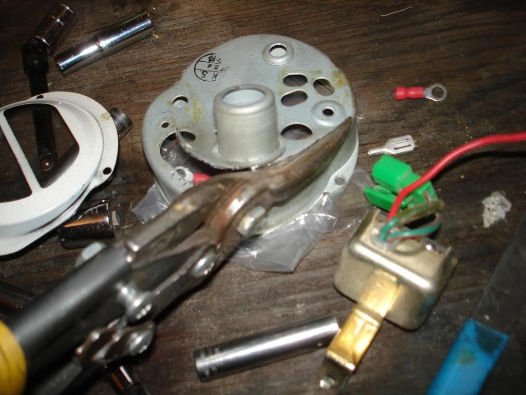

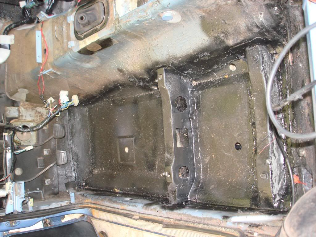

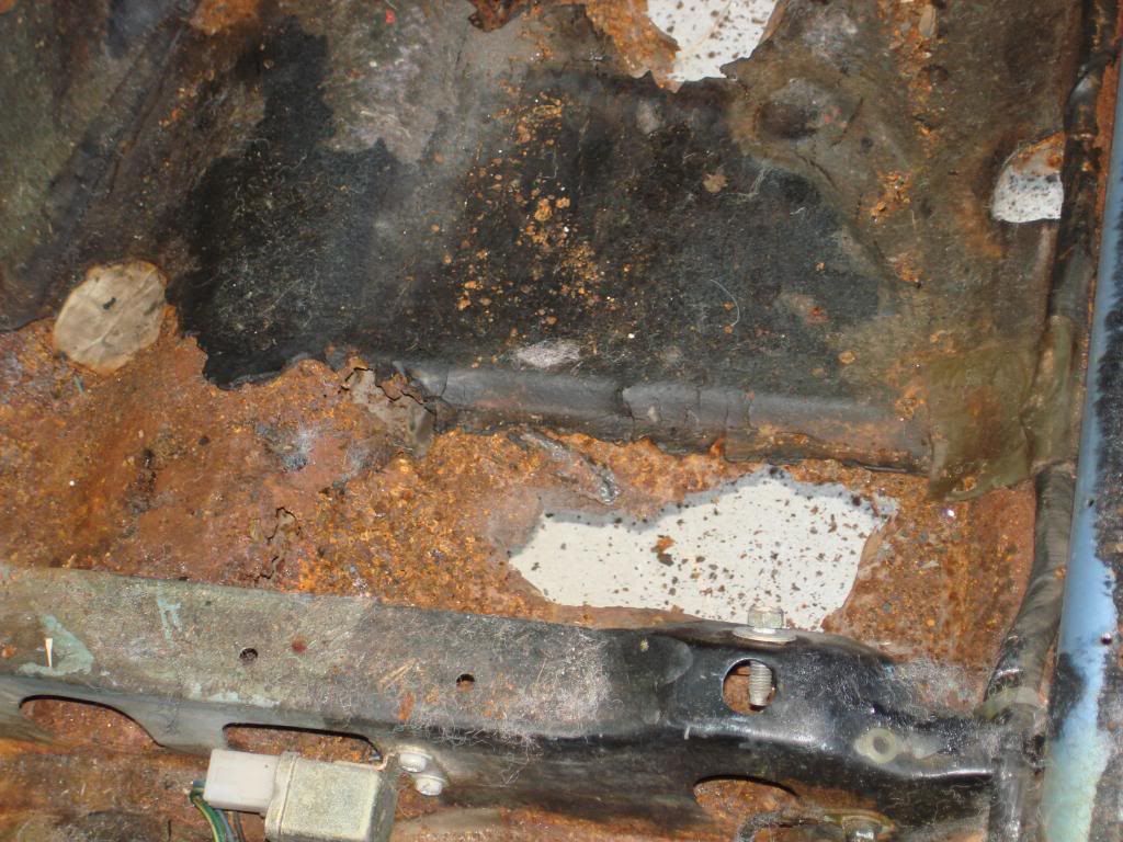

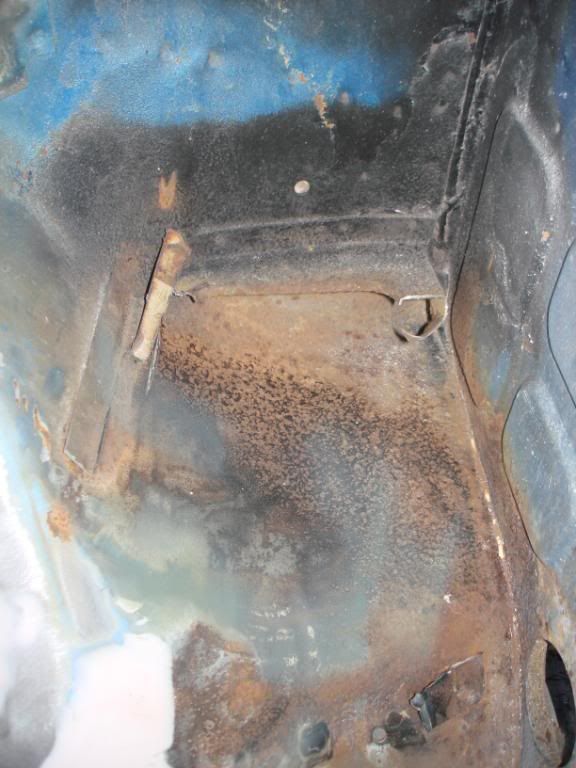

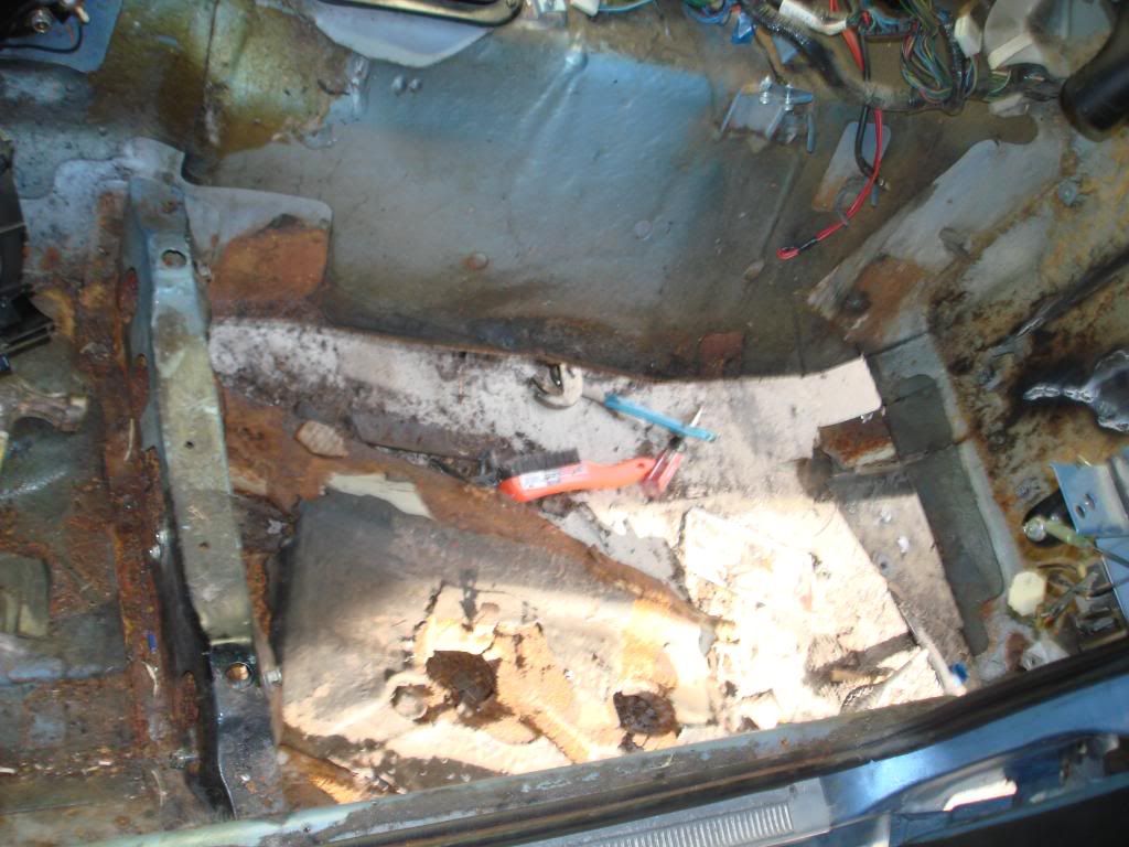

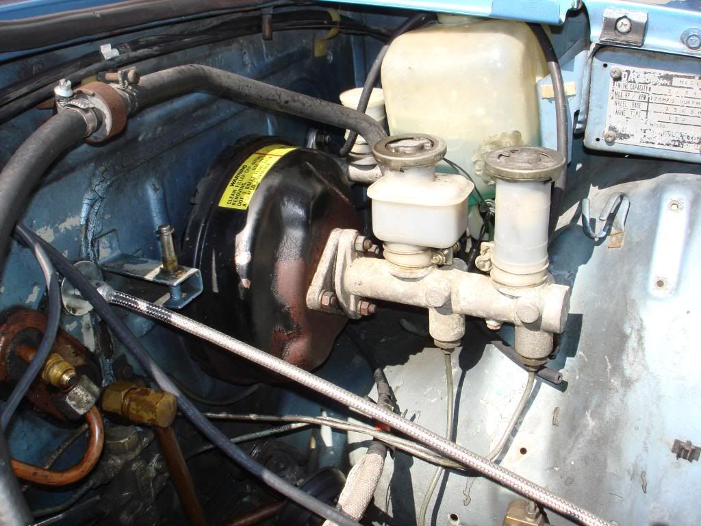

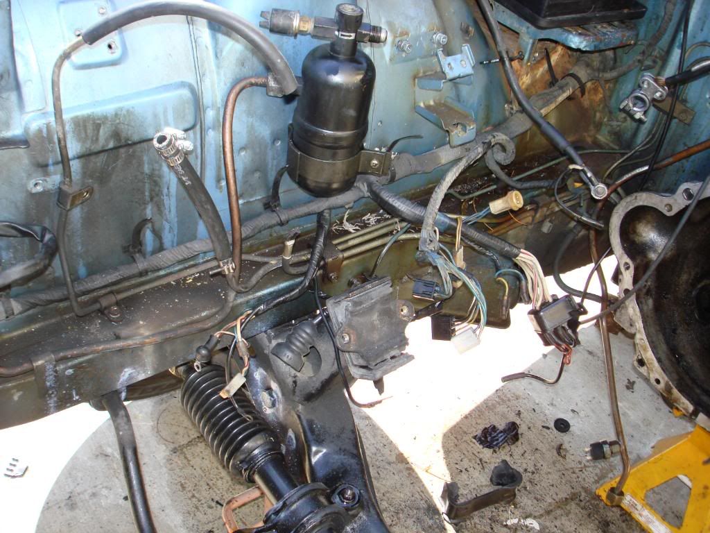

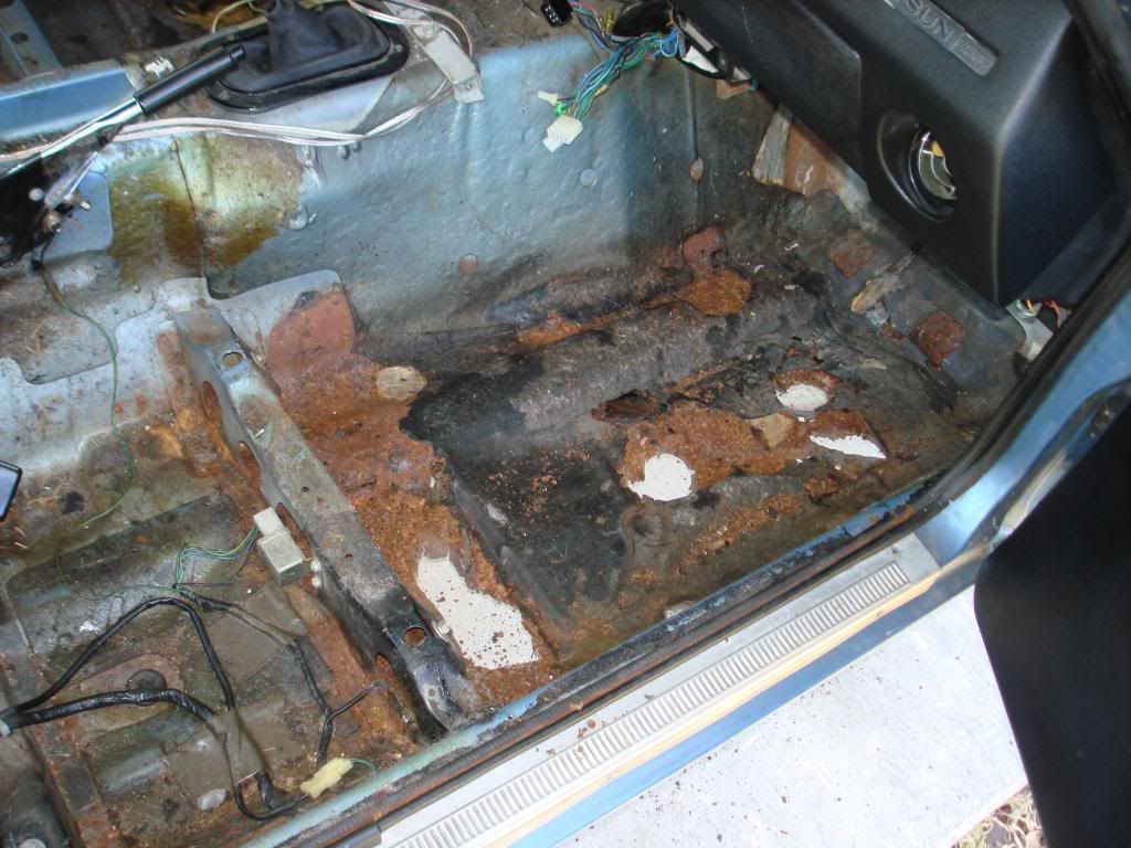

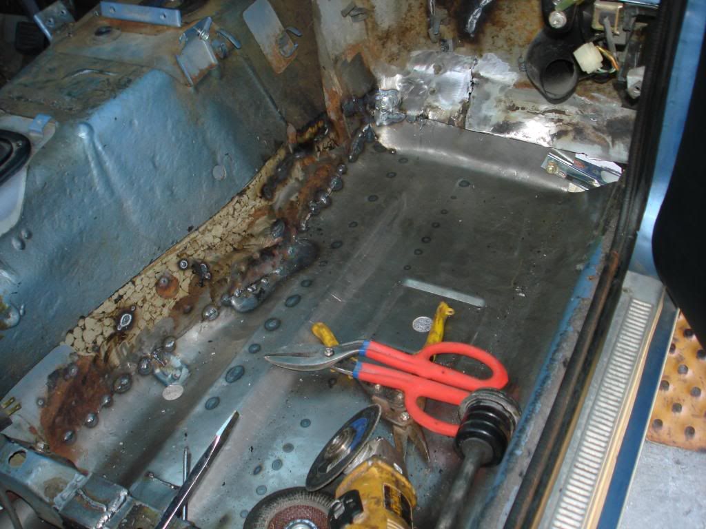

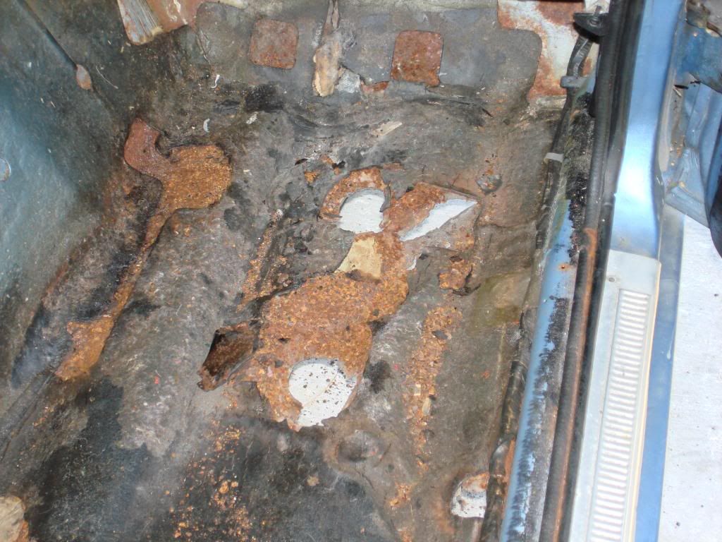

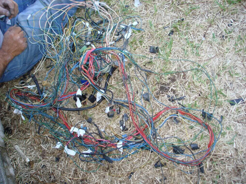

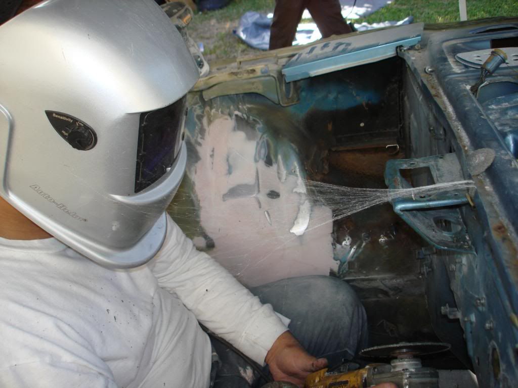

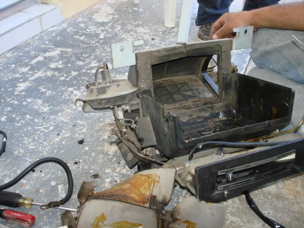

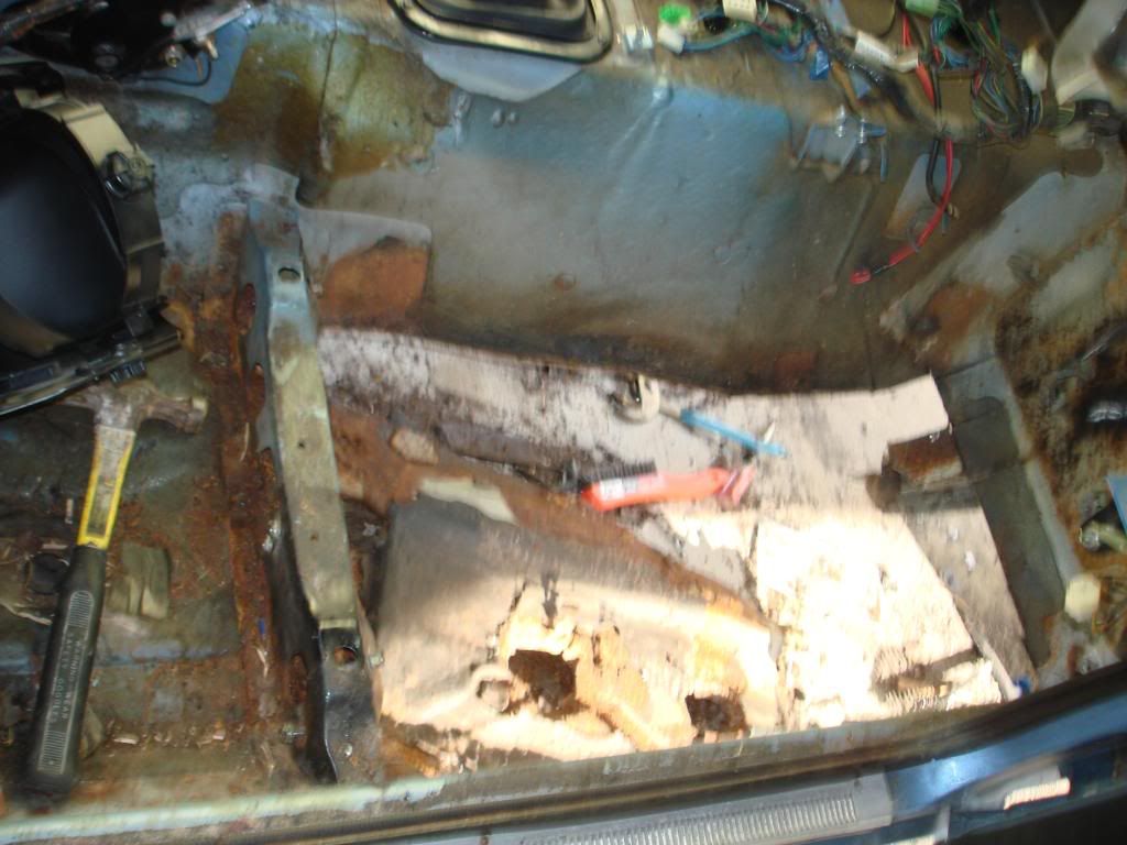

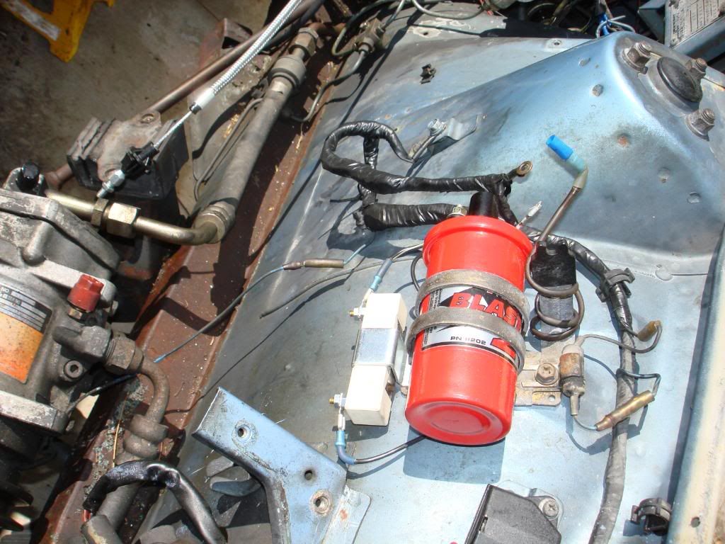

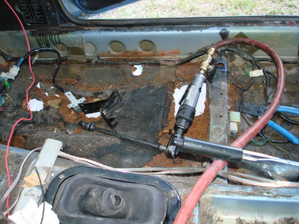

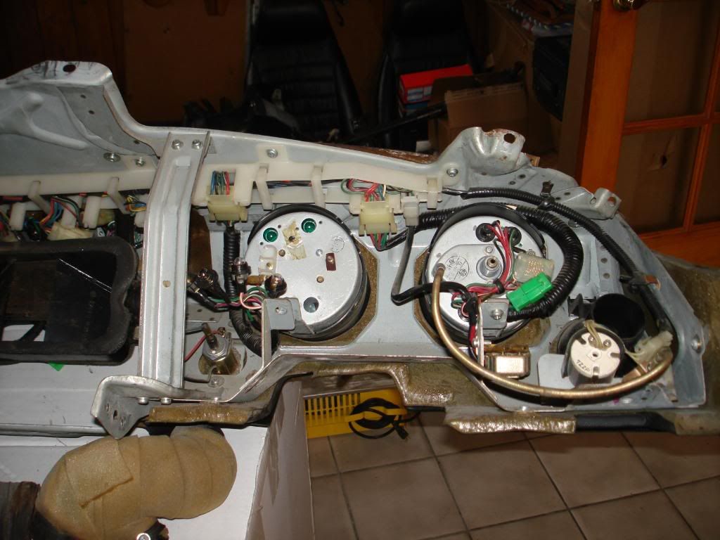

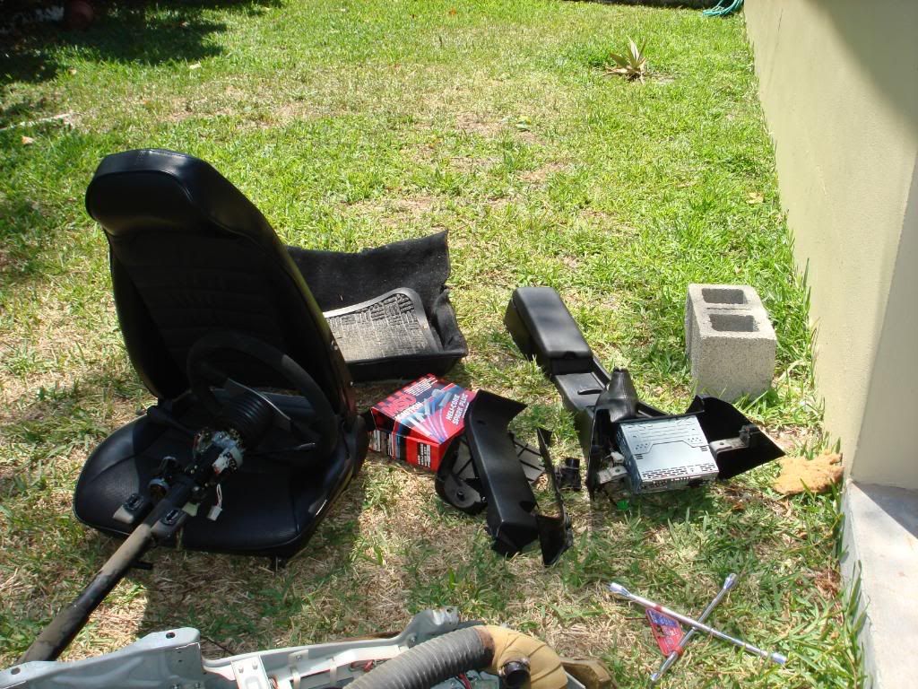

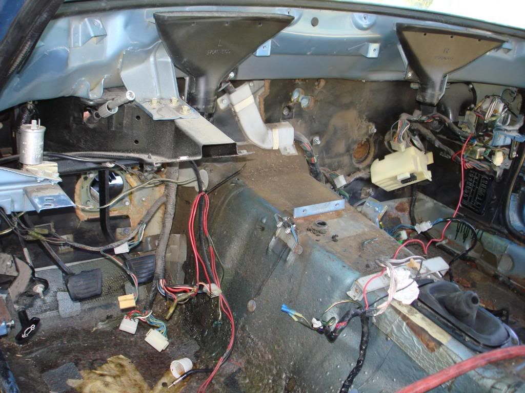

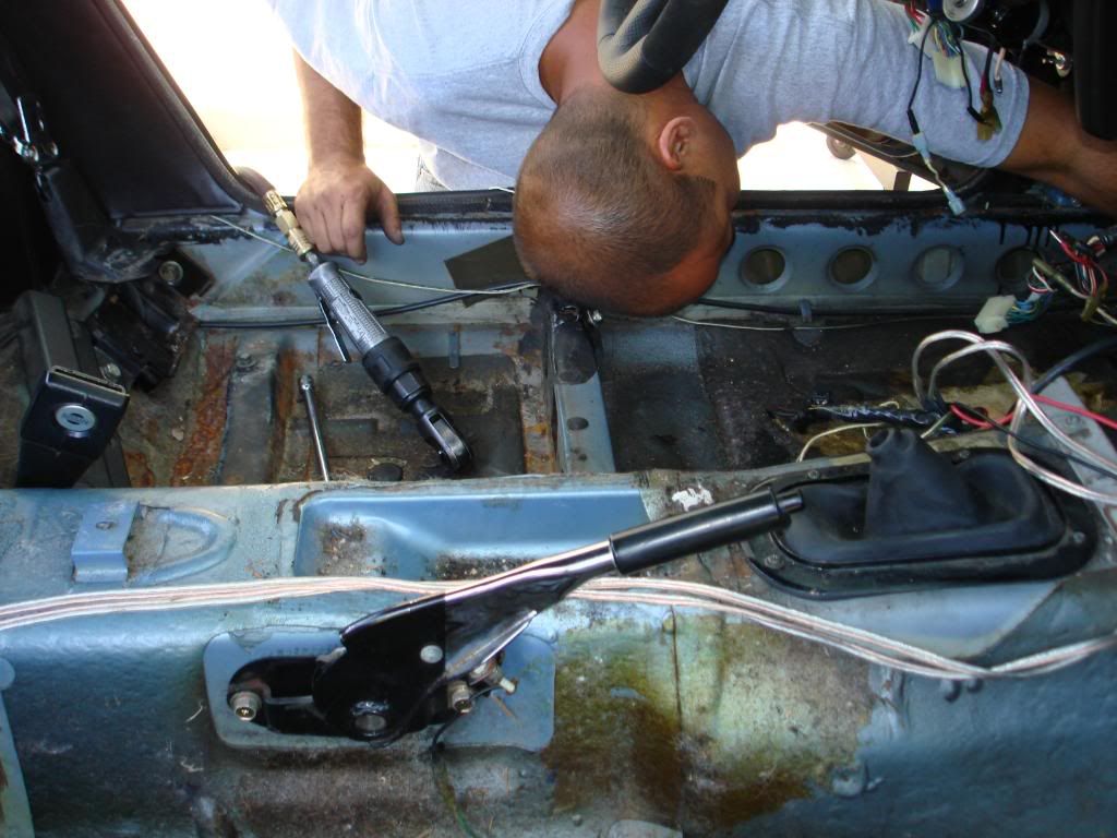

We said why stop there lets do the the inside to. so we riped out the old stuff inside, wiring and all. The floor pans(better said what floor pans lol) were shot, we cut them out too. Here are the pics of the inside.
Edited by cpexcel

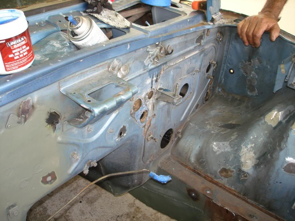

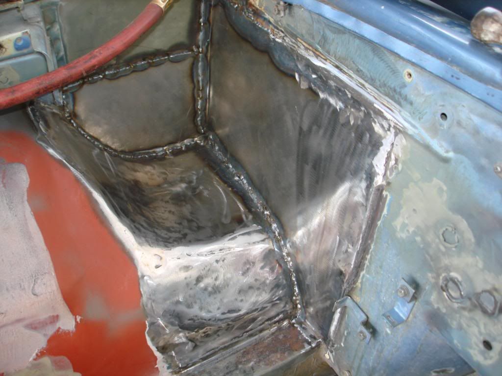

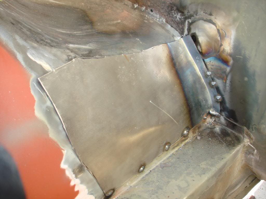

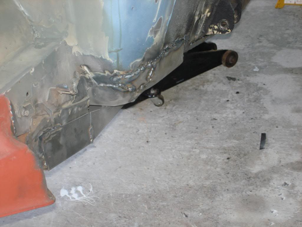

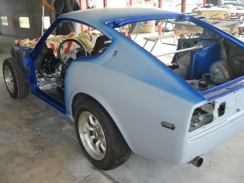

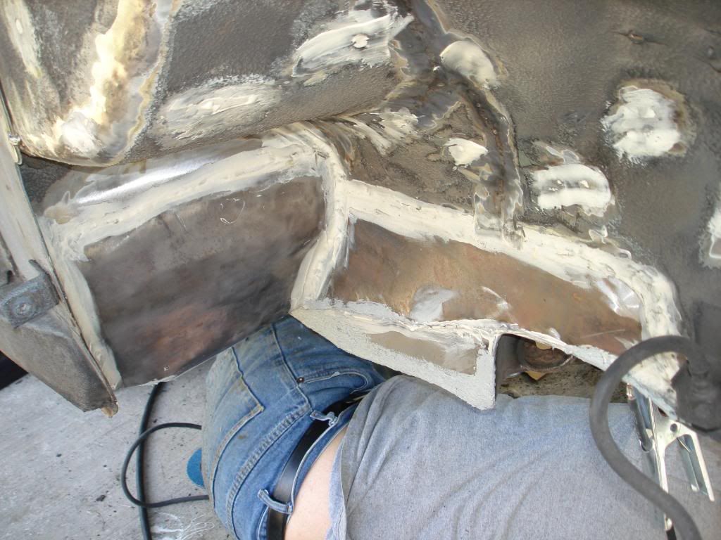

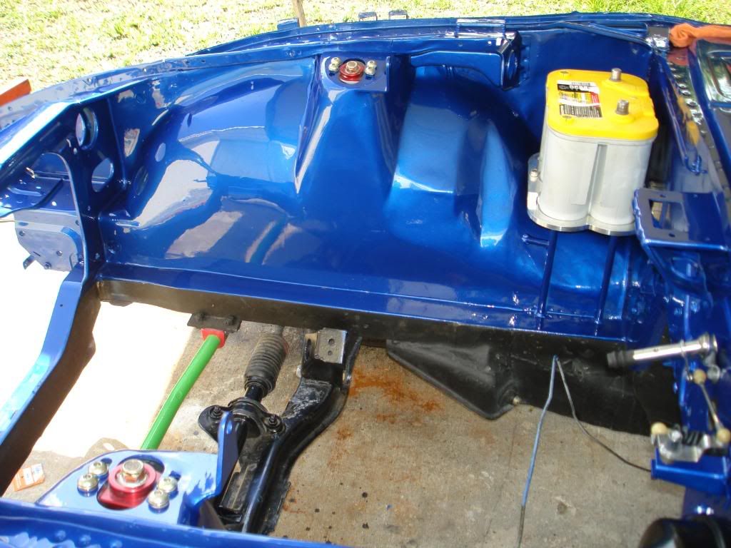

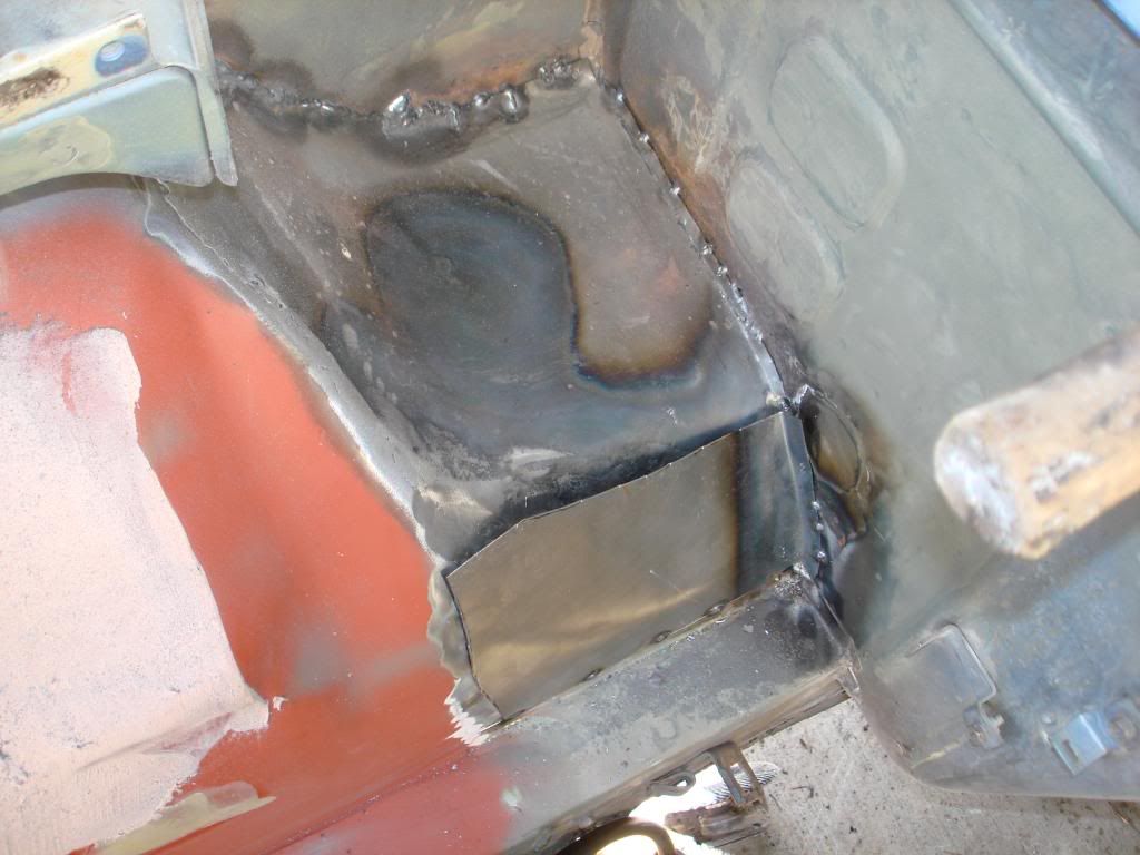

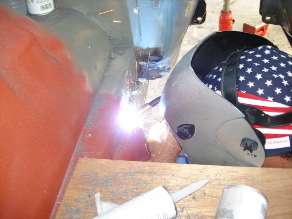

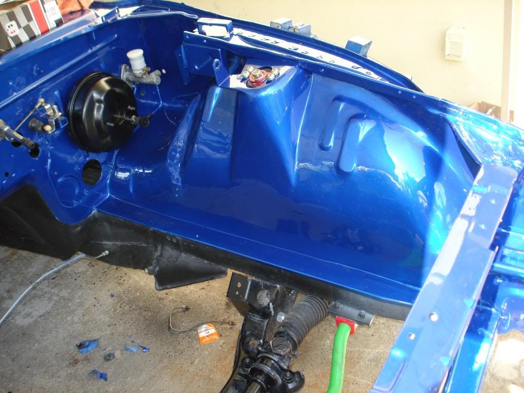

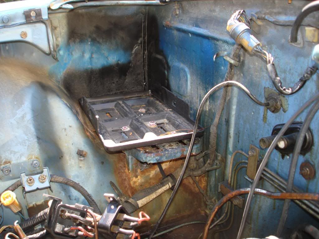

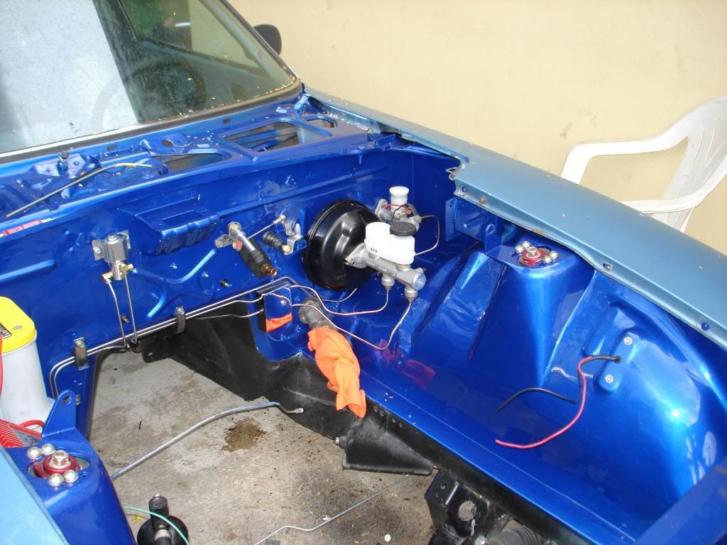

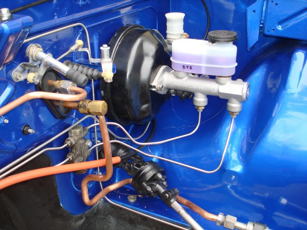

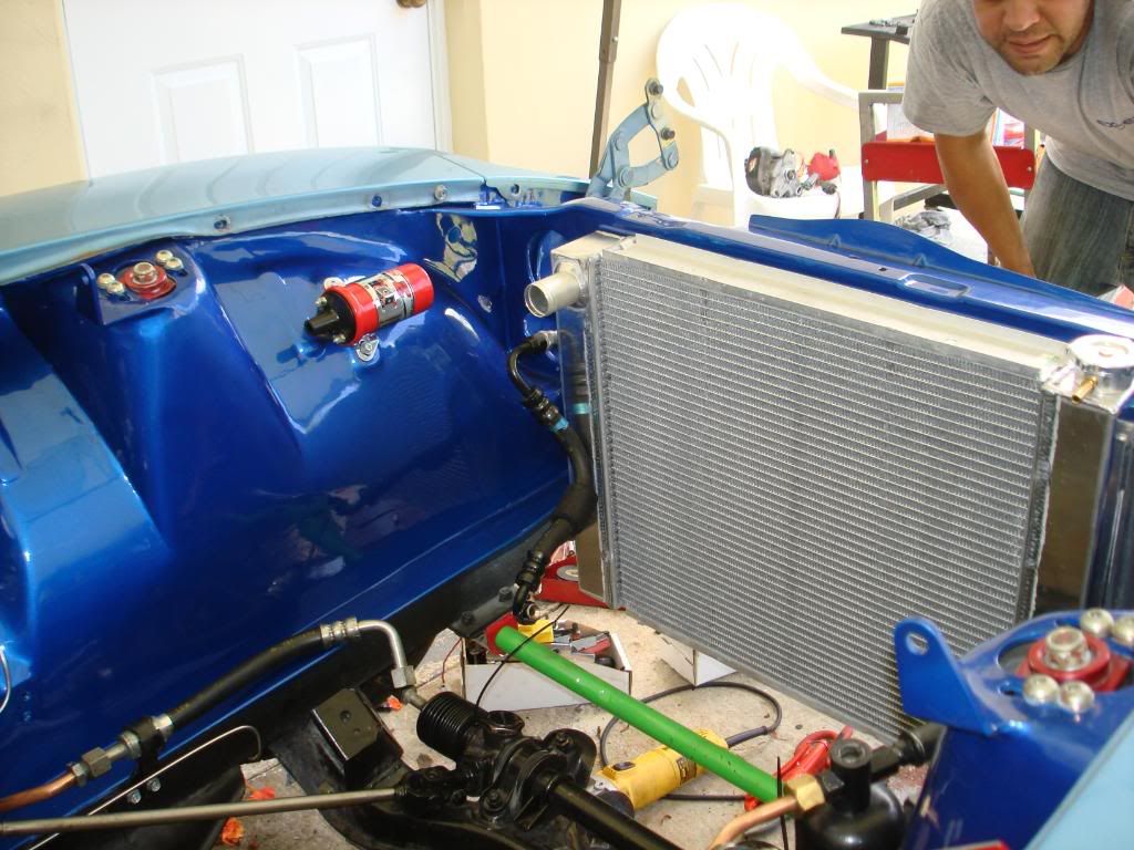

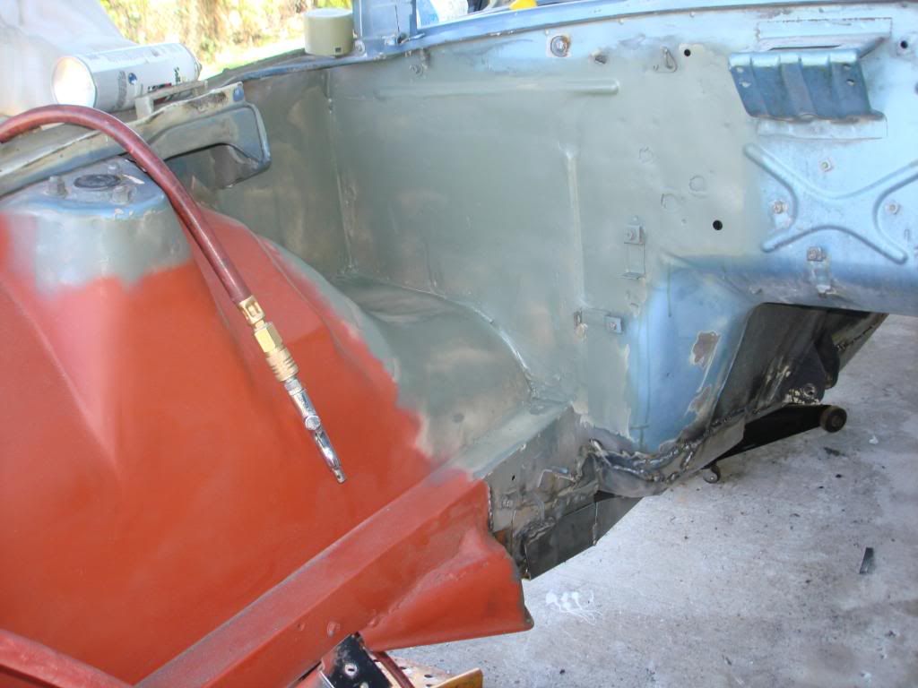

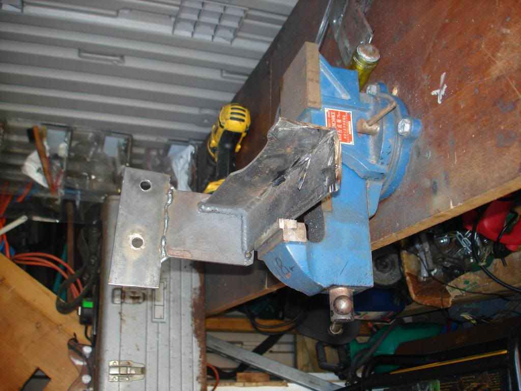

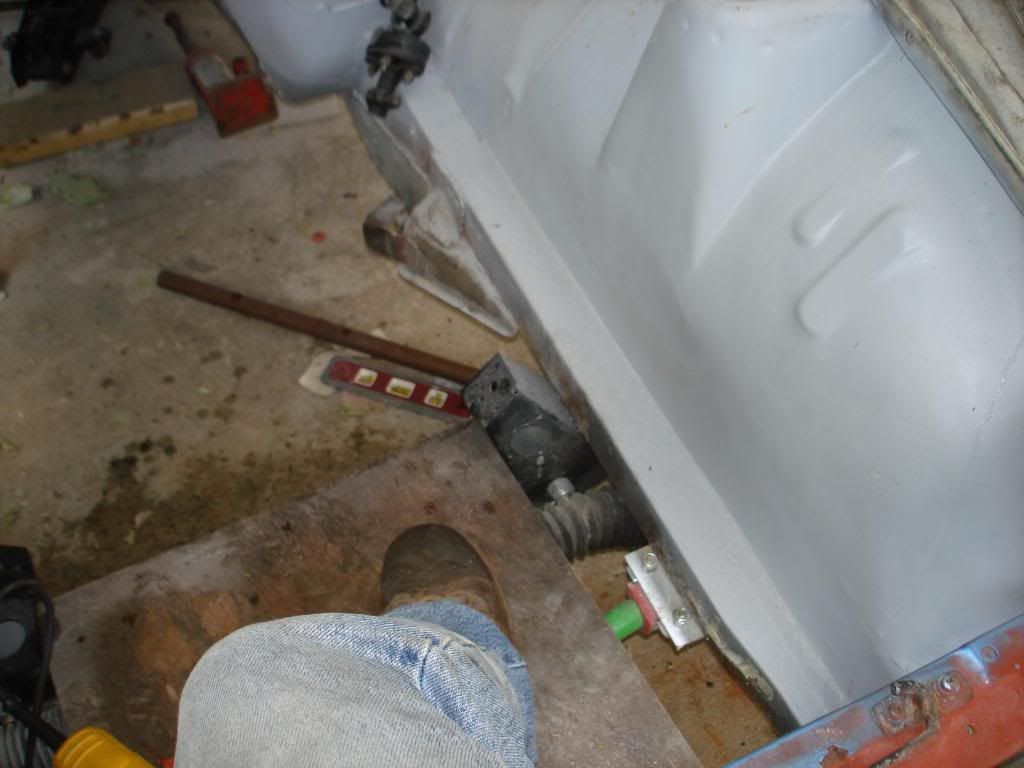

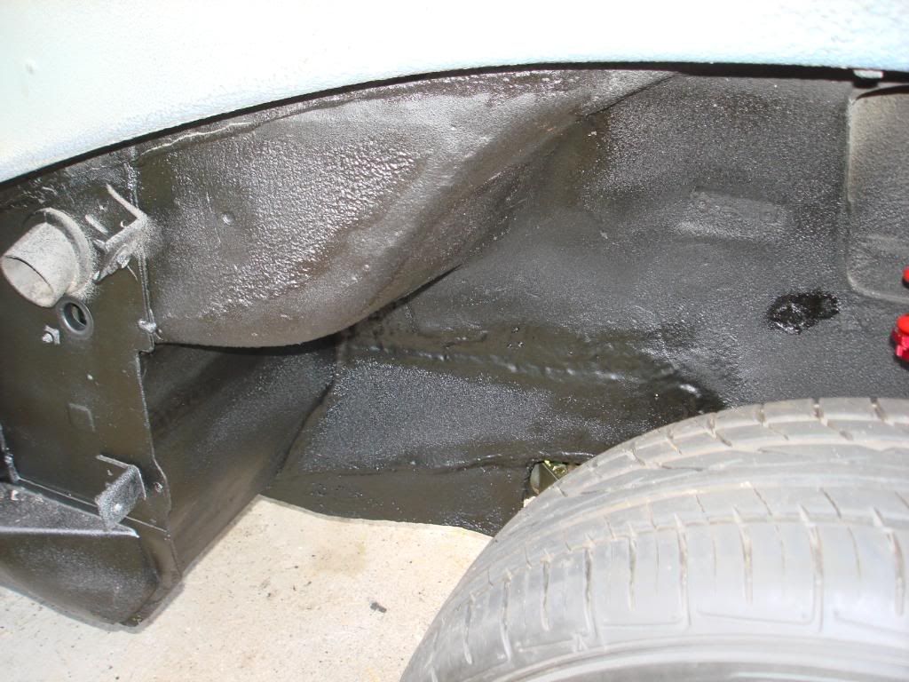

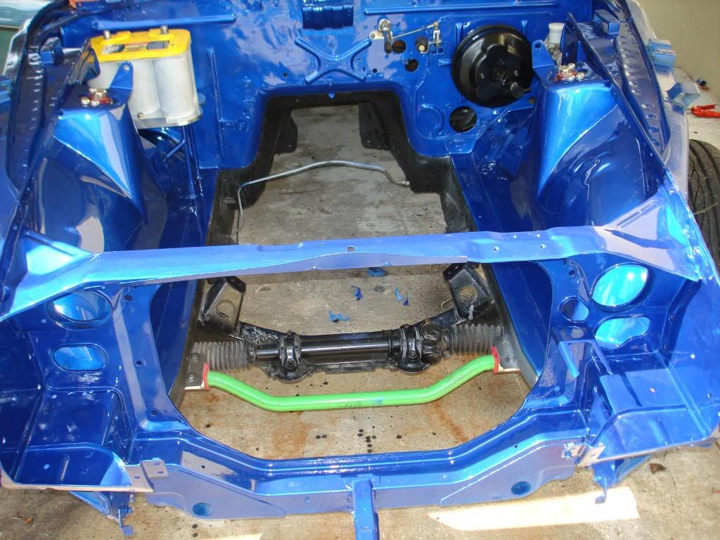

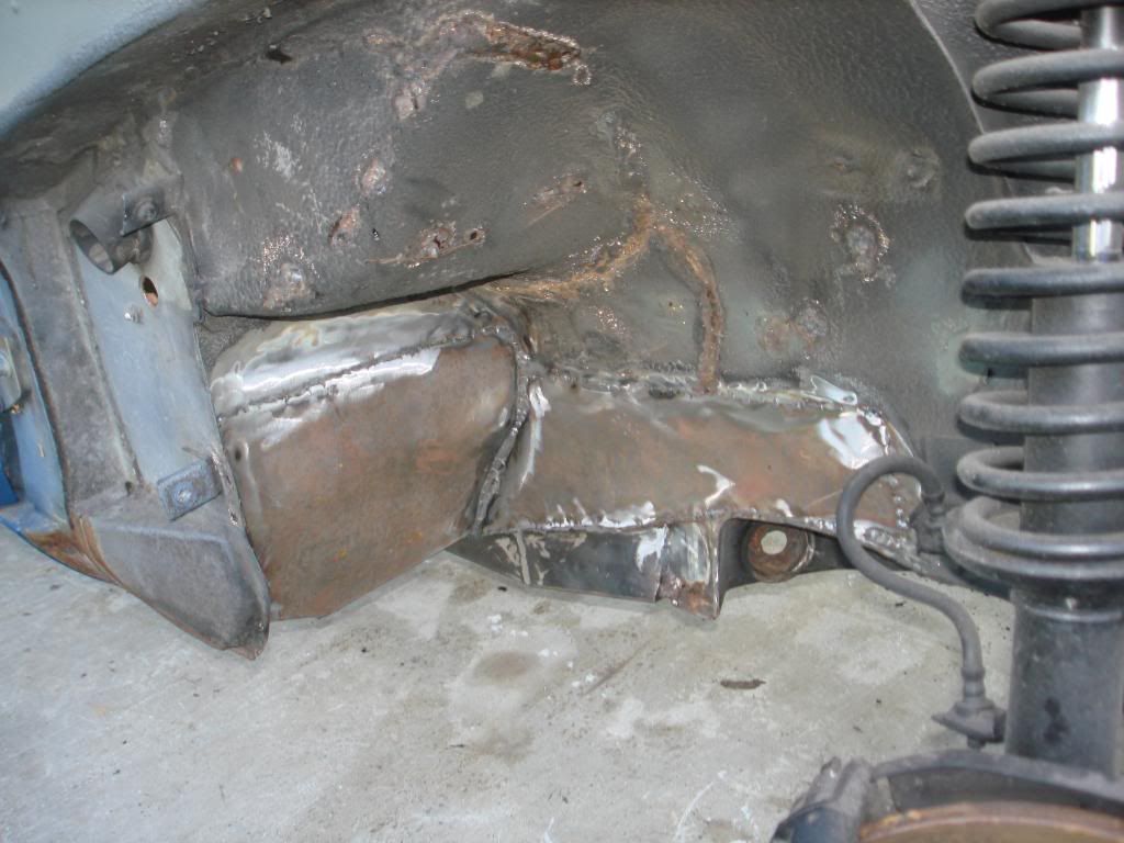

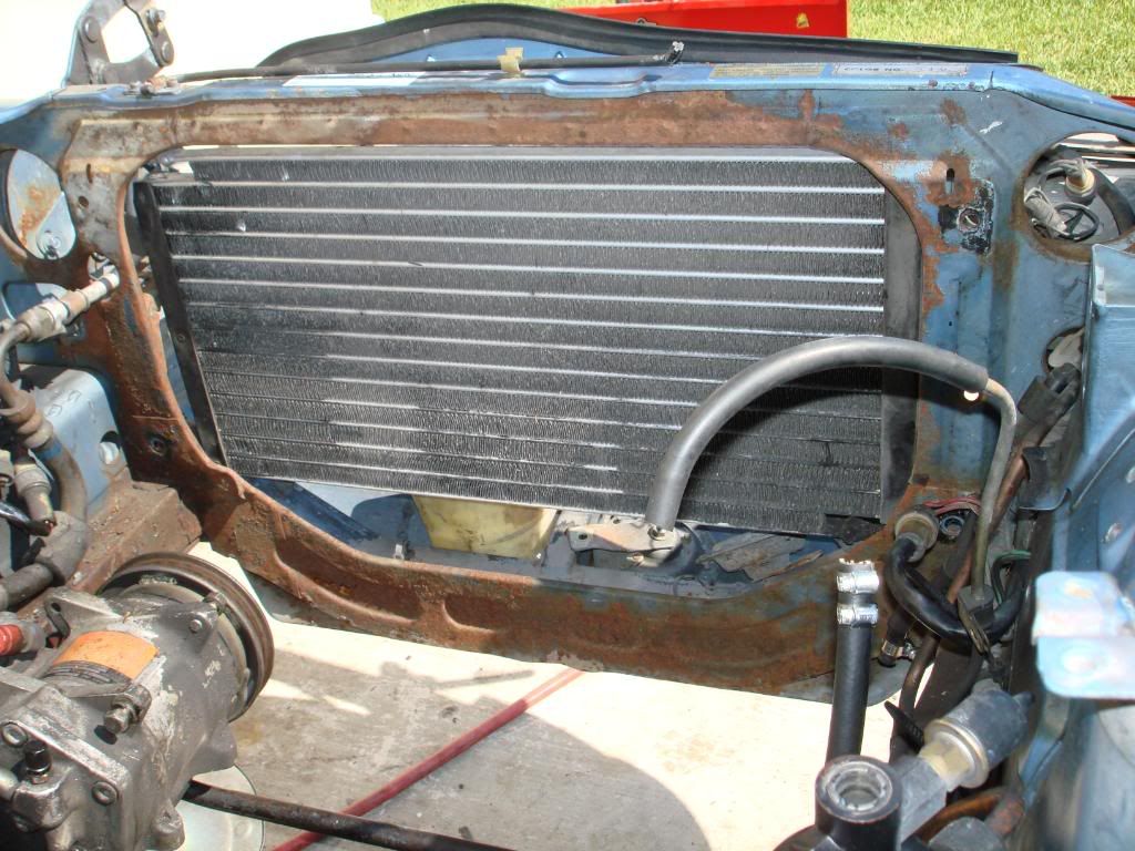

Now on to the sheet metal work. Replaced the floor pans and rails we also did bulldog rail. We redid the battery tray corner , lower radiator suport,

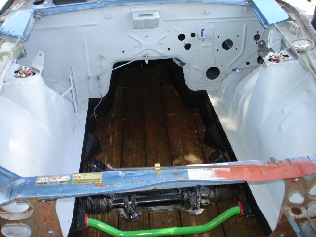

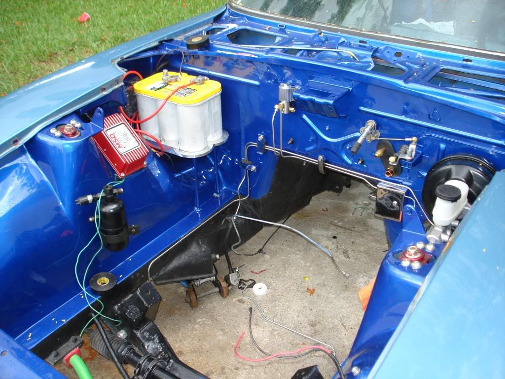

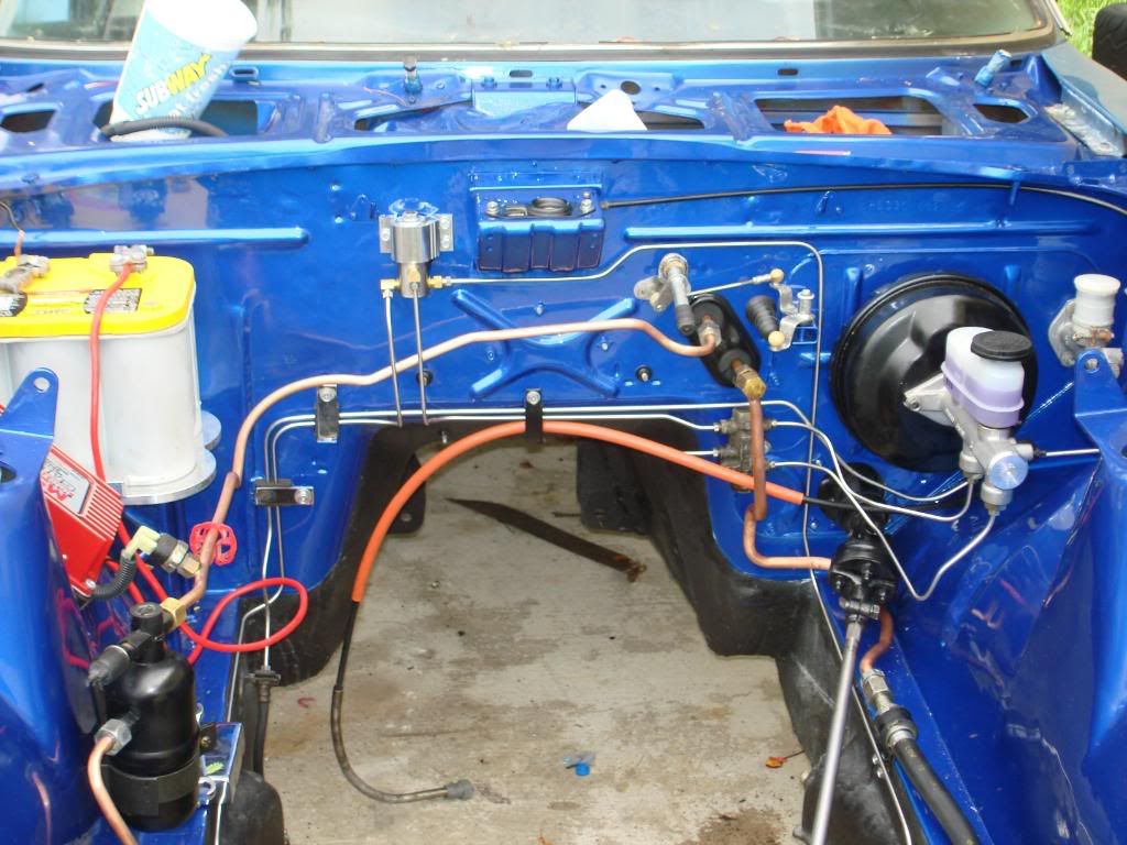

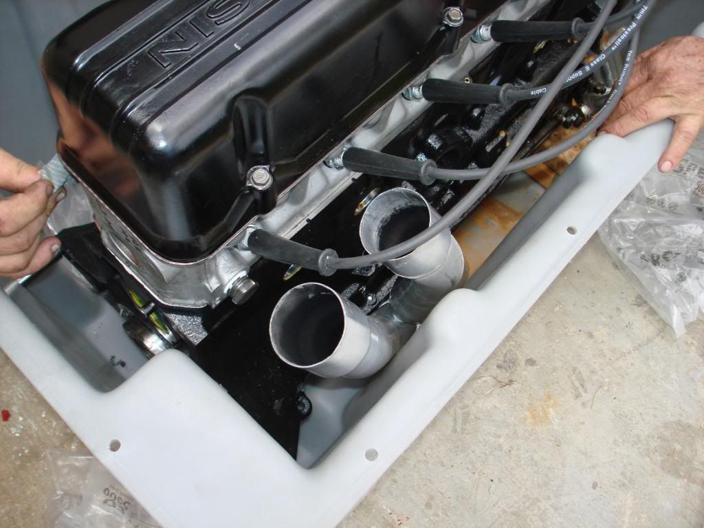

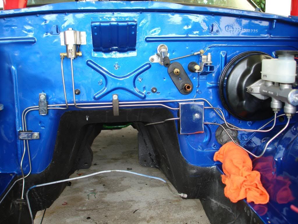

filled all the unused holes and shaved the engine bay.
Edited by cpexcel

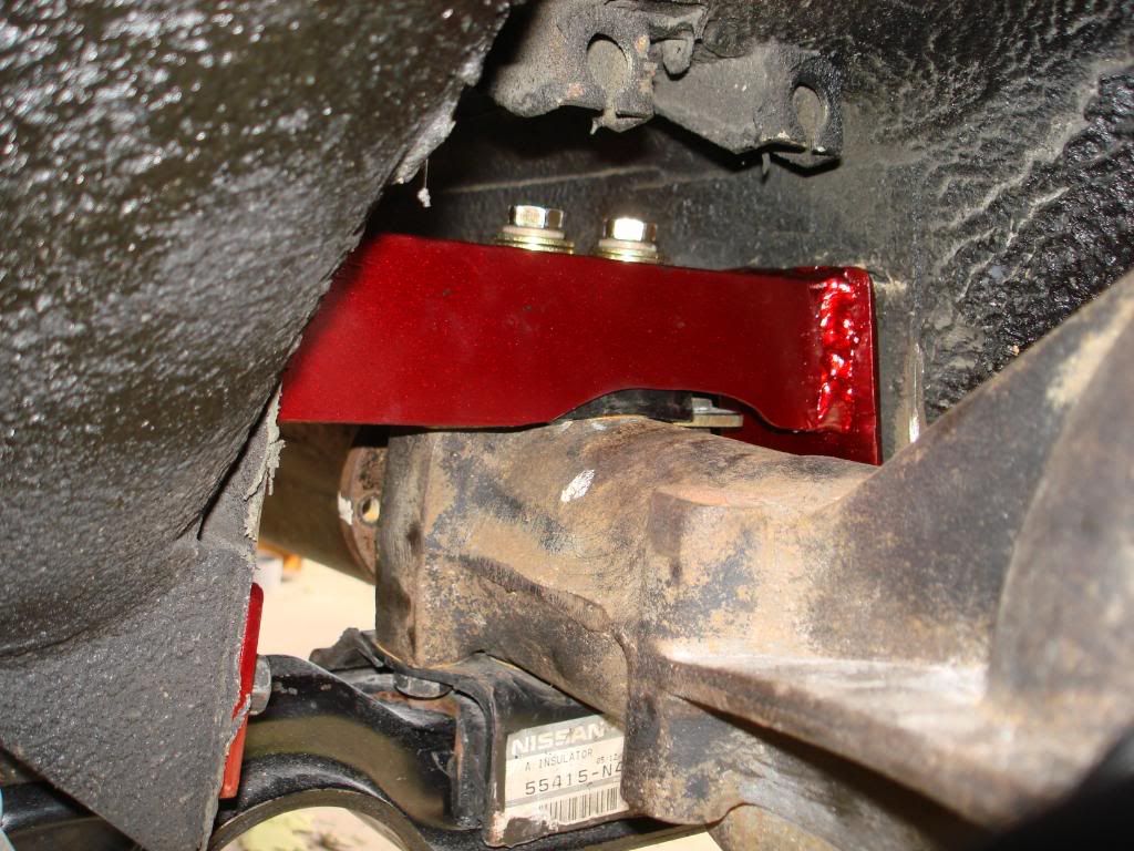

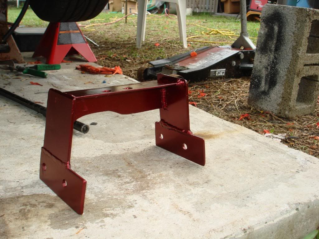

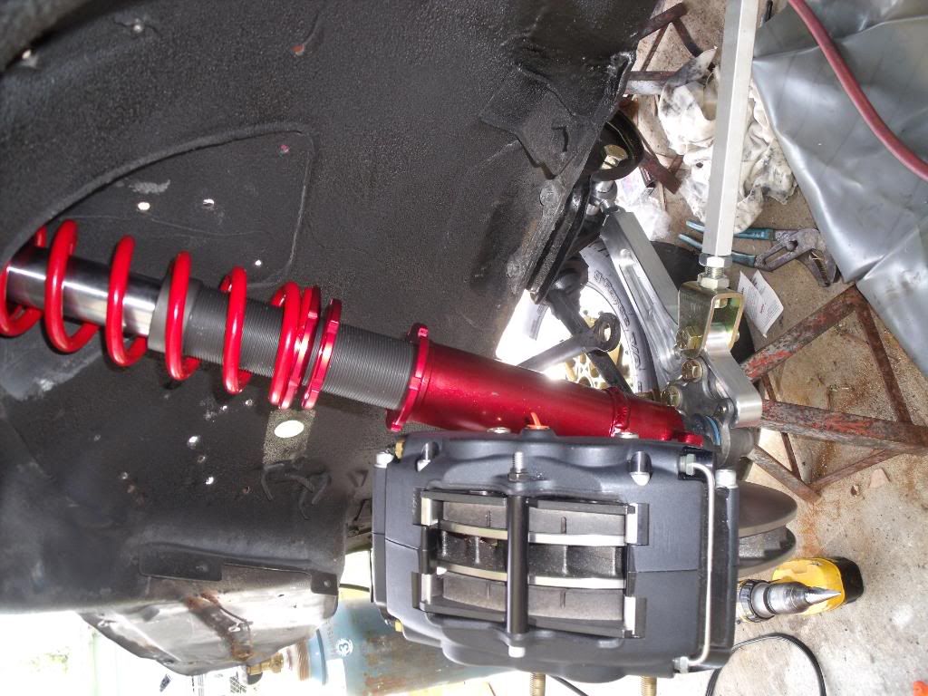

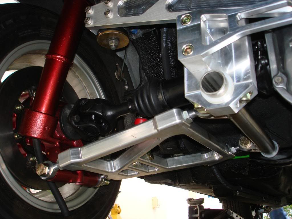

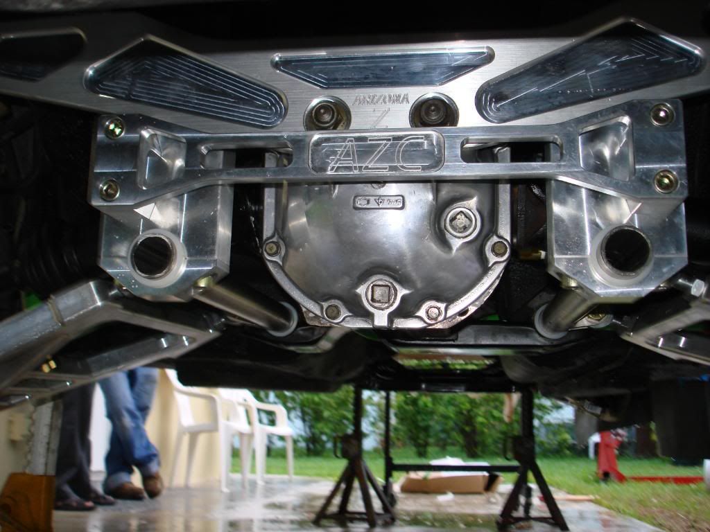

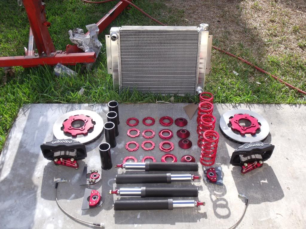

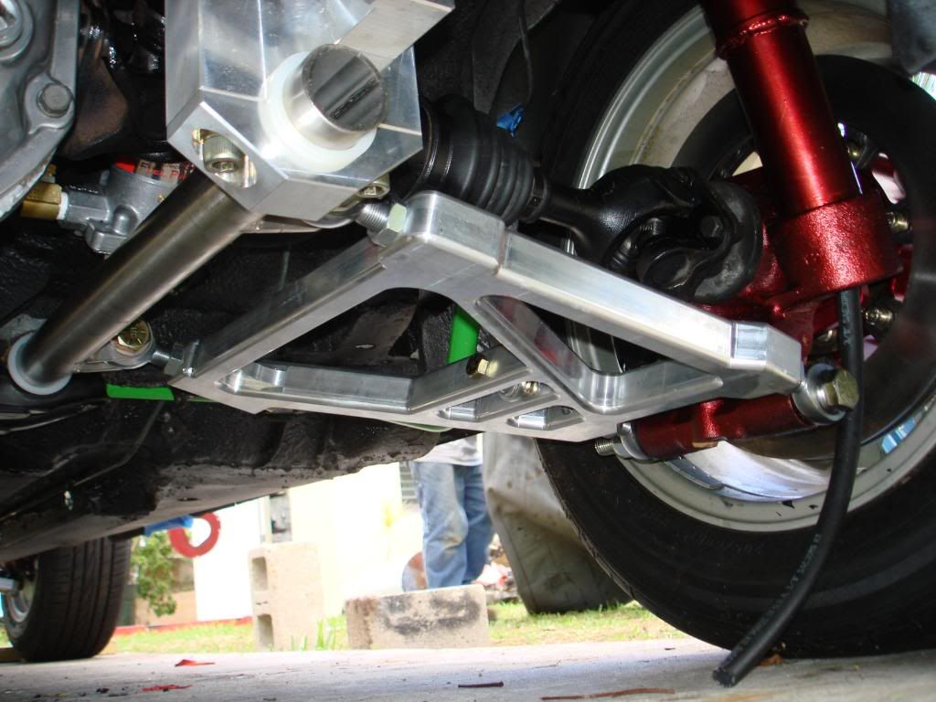

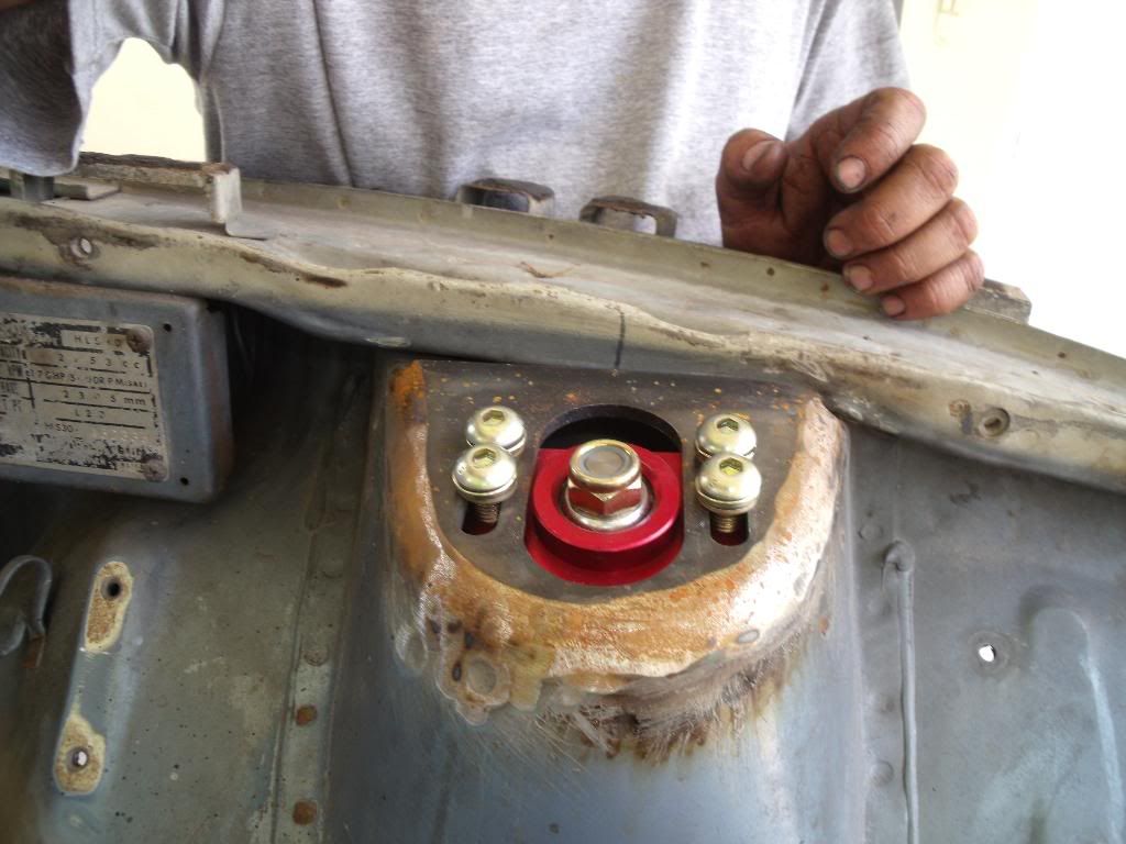

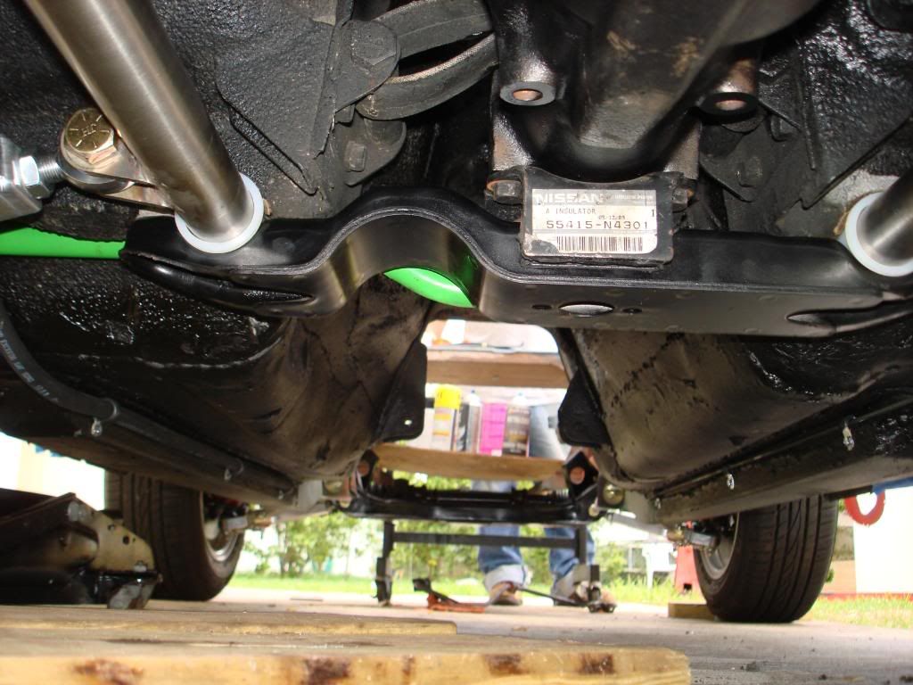

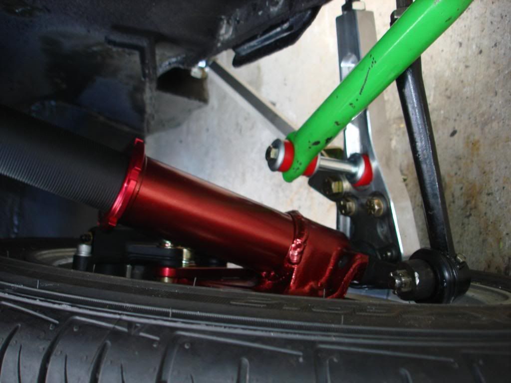

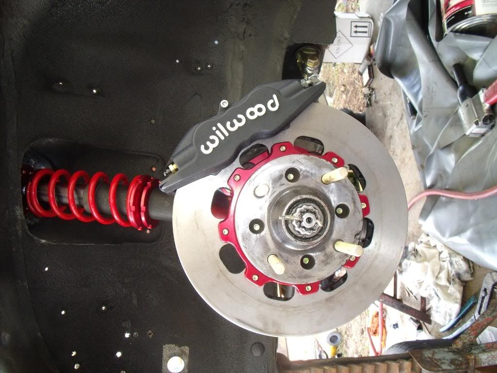

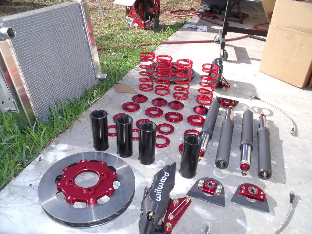

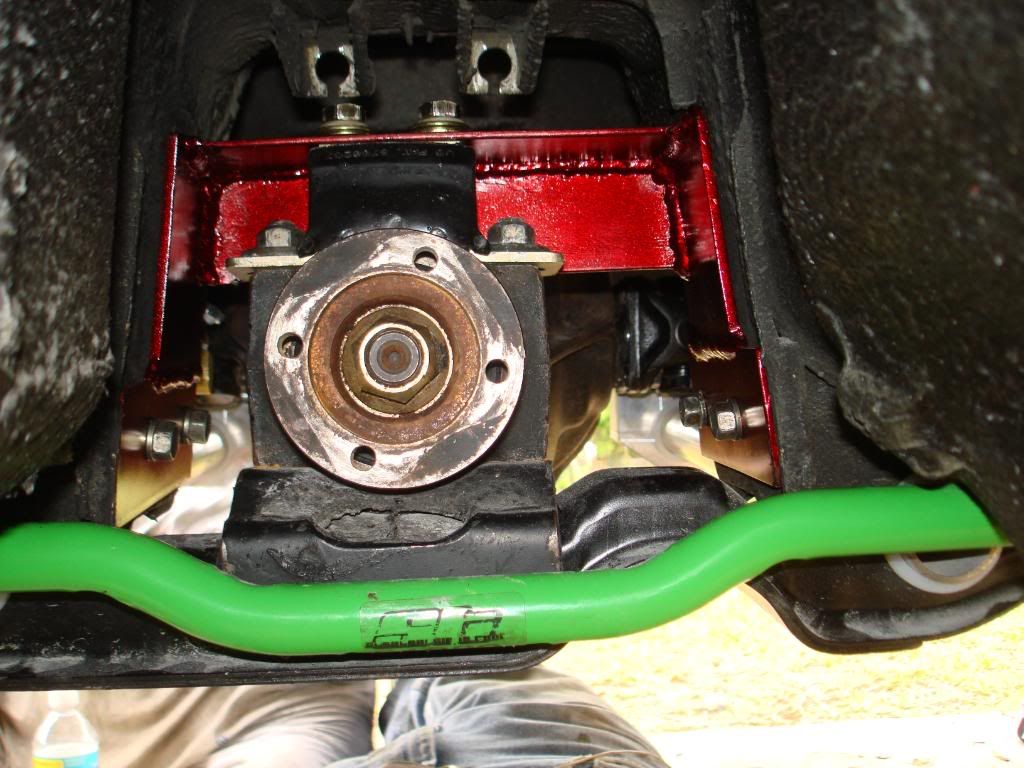

How about suspension..... we got the AZ stuff.Also got rid of the strap over he diff and made custom one.
And Thanks to Dave @ AZ Z car he was a great help on this part.
Edited by cpexcel

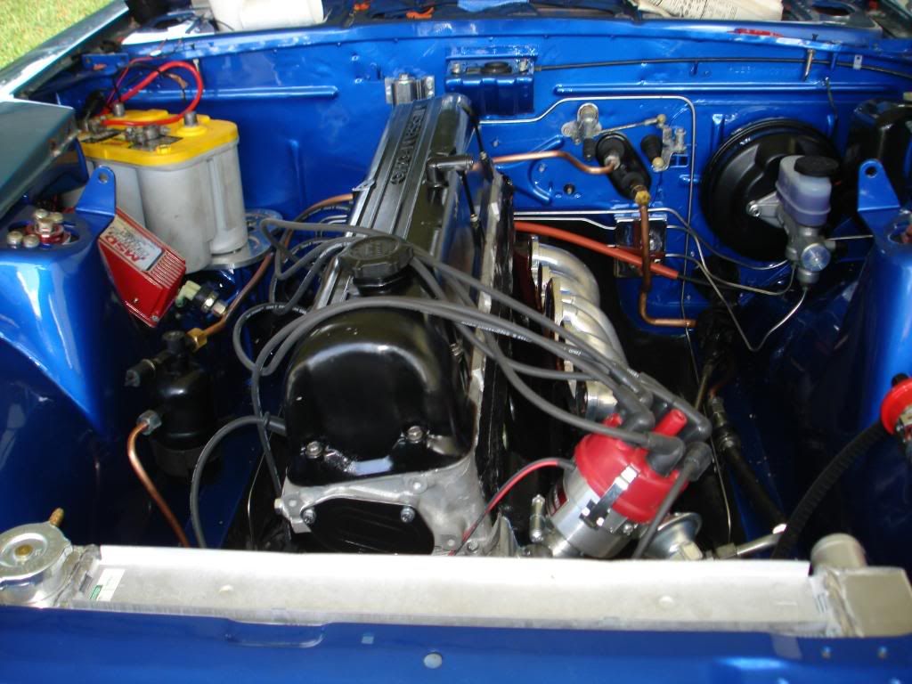

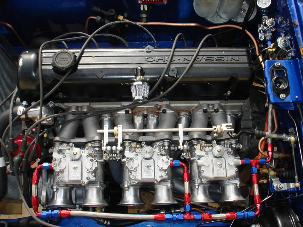

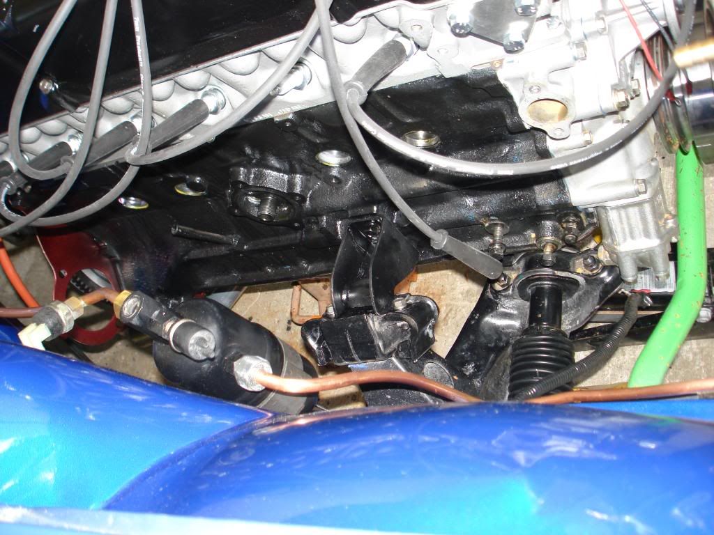

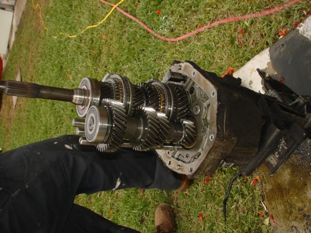

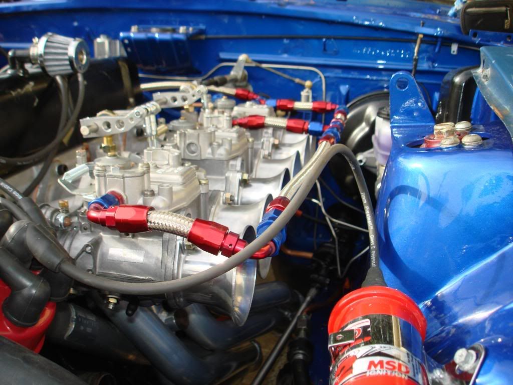

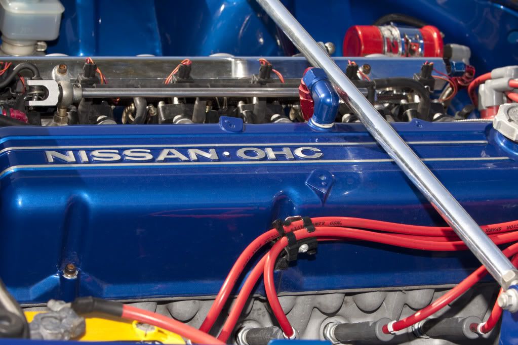

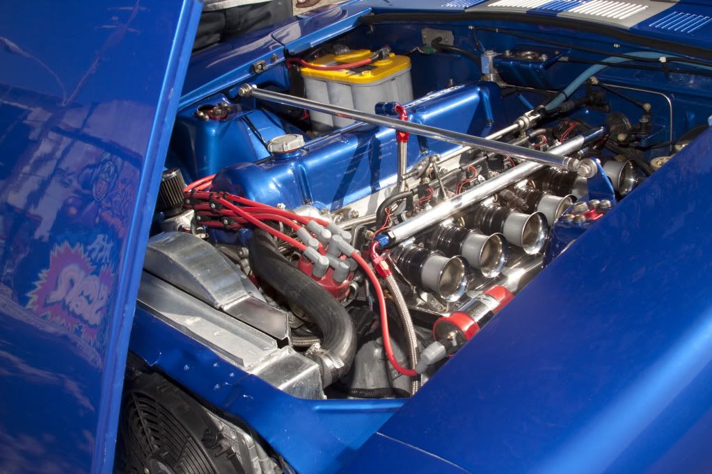

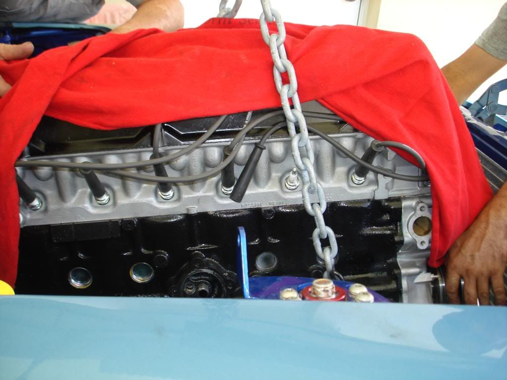

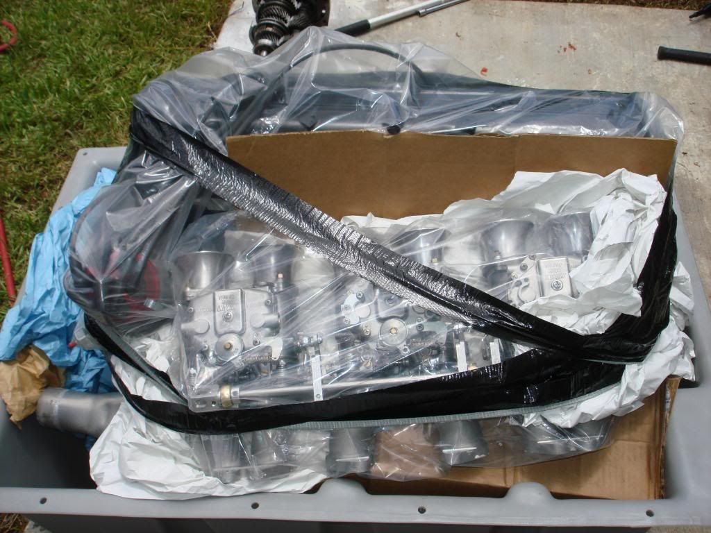

Ok now on to the heart. We called Dave@rebello racing and we settled on a 3.2 :D . We origianly decided on mikunis ( that was a f***ing nightmare). Eventually crapping that idea and going ITB's. Also installed AEM EMS and 100 shot direct port dry. Needless to say I'm much happier NOW. Thanks to all write ups on matting the KA tranny, We now have one as well. It handles this kind of power very well.

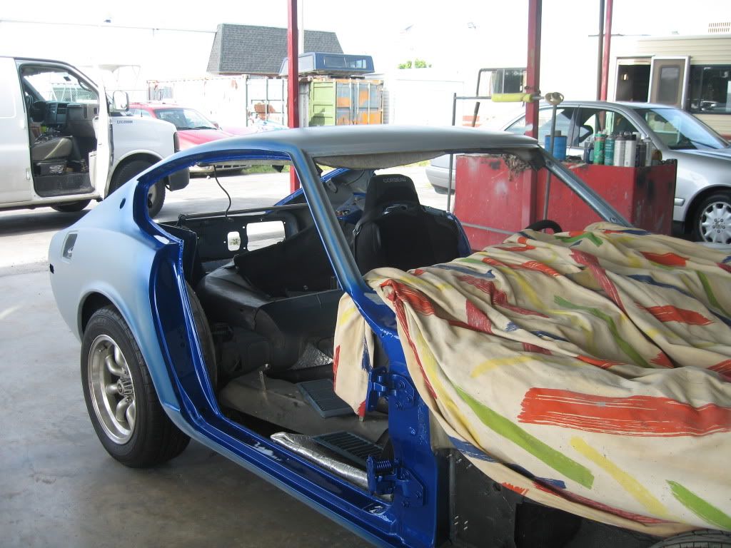

Well you get the picture...I'll post some of the goodies and finish product.

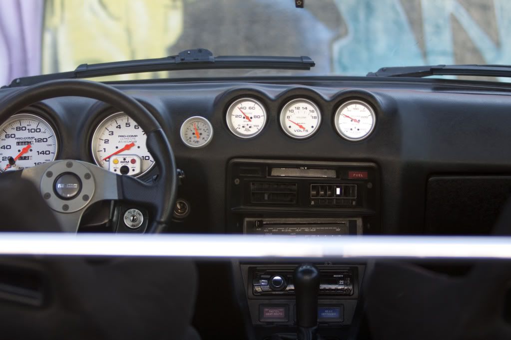

Momo Steering
Corbeau Seats

To keep a long story short...I Had help from my cousins who both happen to work for me. These guys both have project cars as well. One had an integra at 500 HP or so and the other a mustang with internals and spraying. We decided to do the research and give this project a go. Anytime we were slow we jumped on the car. It started in April of 09 and basically wrapped it up by April of 2010(so we thought)...We added the fuel injection since then. Tuning issues with the Mikunis to blame...Also blew a head gasket and decided to go copper. The entire build, paint and all was mid 30's...Read a lot before you get going on a project like this. There is plenty of right and wrong decisions to live with and also consequences.

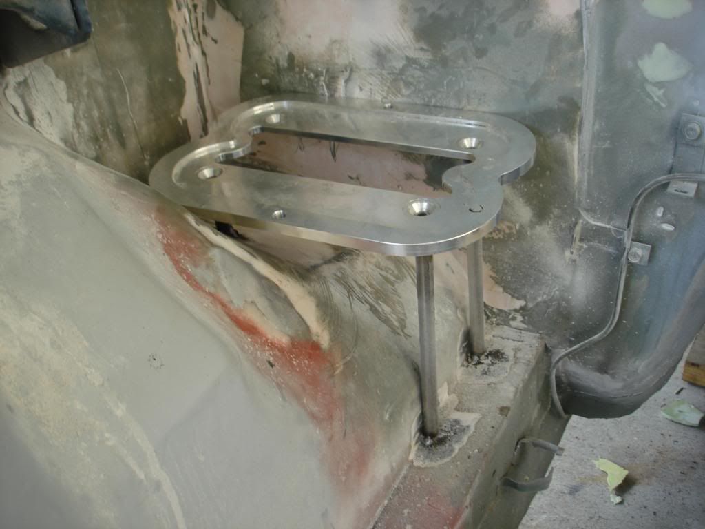

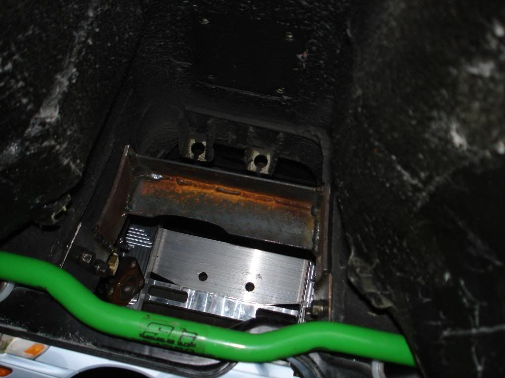

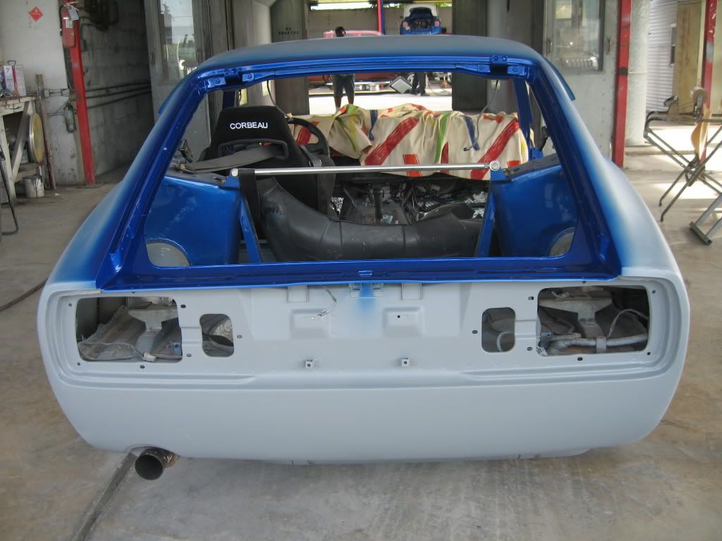

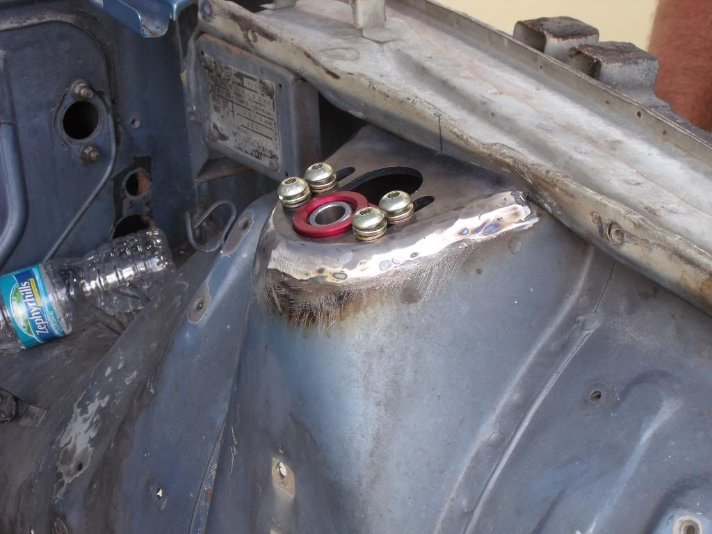

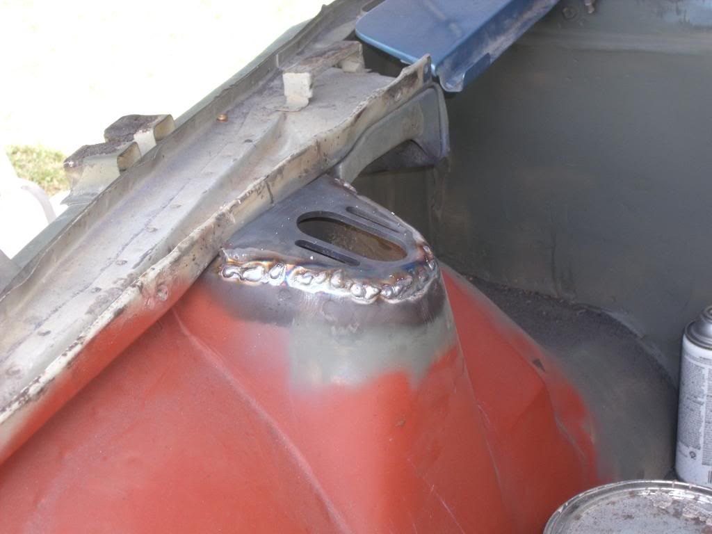

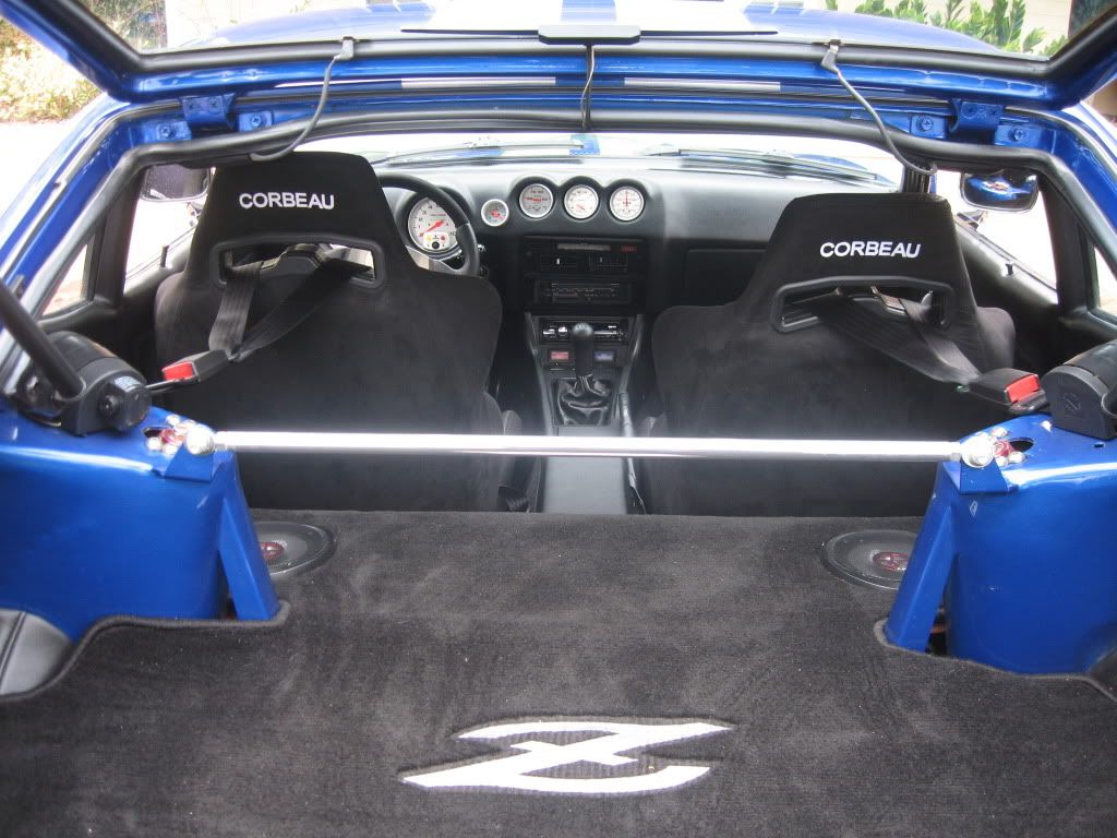

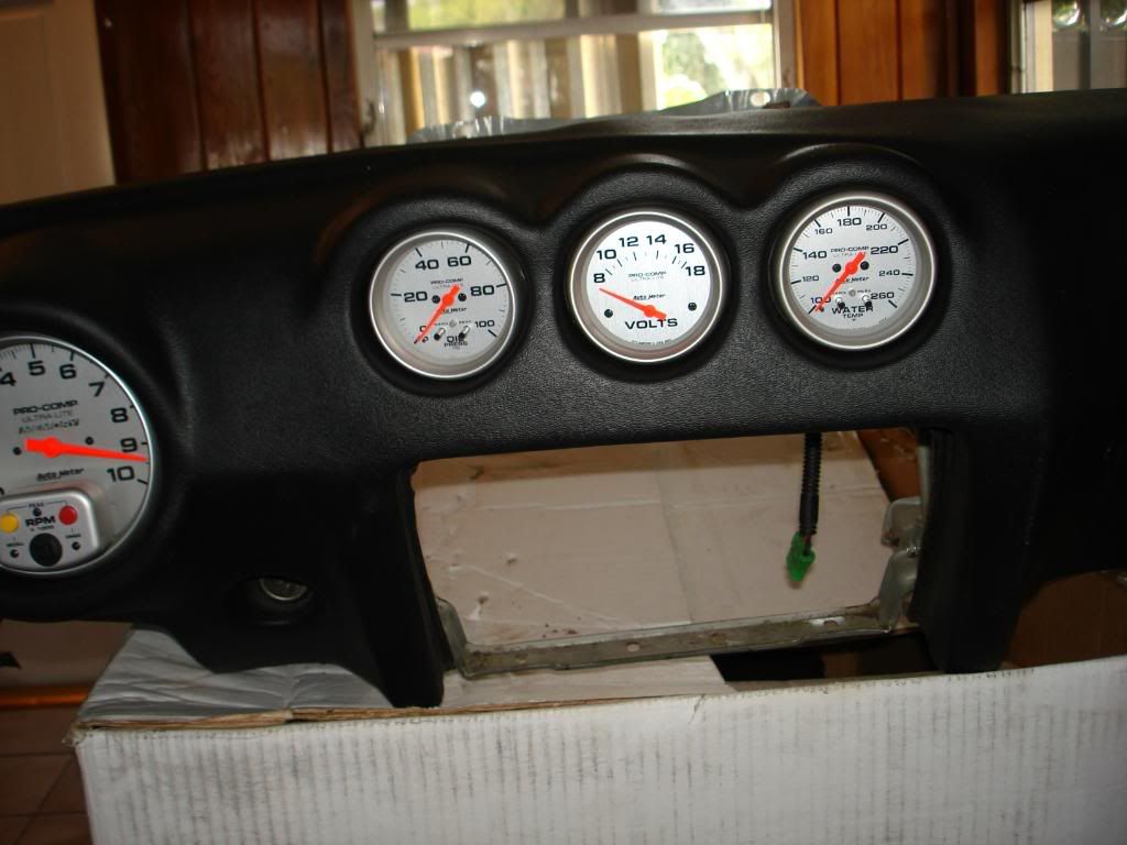

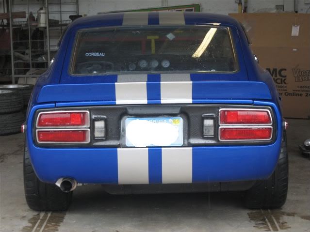

I am LOVING the interior. Can you take some more detailed pictures of your hatch area? I am curious to see how you mounted the "strut" bar, it looks welded.
Also, how is your sound system installed? Any boxes underneath?
The strut bars are welded to the towers upfront and outback as well...To the same piece that AZ mounts their coil-overs. The same picture above that reflects this item also shows a modest two speaker set up. I have a local guy, (Manny's Sound System) who is part of the south Florida Z club and a huge Z enthusiast himself. Eventually the car will get the sound system upgrade thru him.
