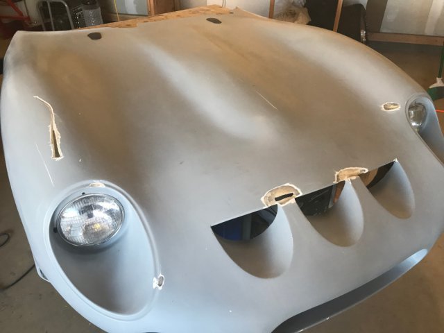

  5. Well, a few things have happened since my last post. 1. I finally pulled the plug completely. I'm officially and completely retired. 2. I built an outdoor patio cover, which means we finally have some shade for those triple digit temperature we get for weeks on end... 3. and Christmas Village 2019 ( in 3D ) is finished. It's so big we had to use two rooms this year. With all that out of the way, I was finally able to begin making repairs to the VR. I spent today removing the bonnet, cutting out the damaged fiberglass... and prepping the repair areas for mat and filler. I'll be making new forms to rebuild the under hood extensions to the sugar scoops. Damn it feels good to be working on this again!!!

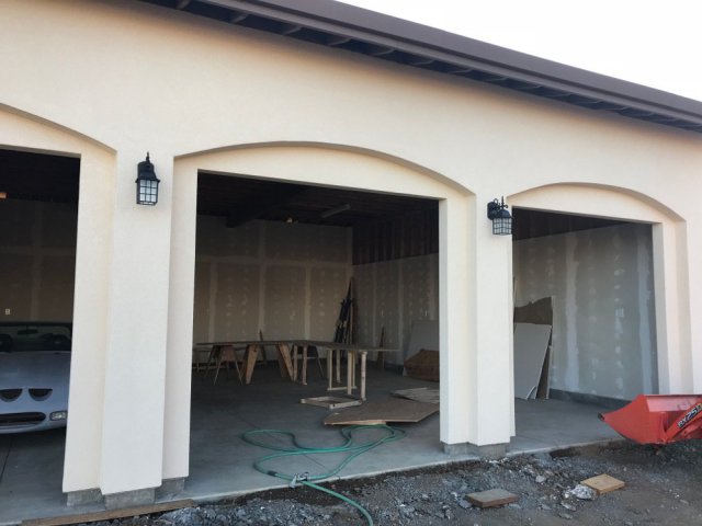

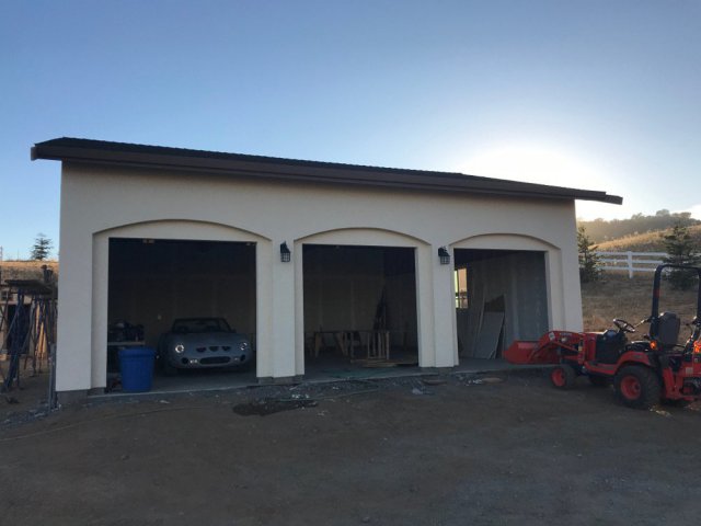

  8. The shop is finally finished. At least as far as the county is concerned. The inspector just signed off on the final inspection!!! Time to get back to work on the Velo Rossa.

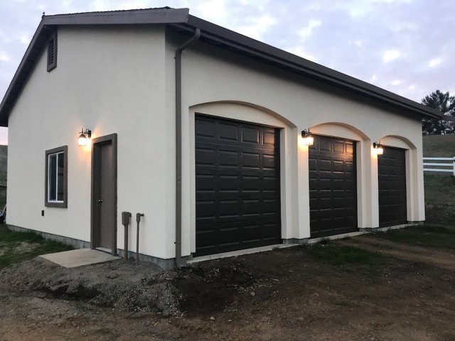

  9. Stretching for the finish line. Garage doors are in and operational.

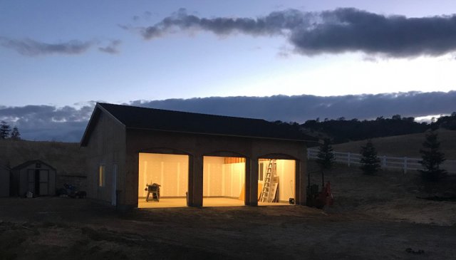

  11. All it needs now is garage doors, down spouts, some trim paint and a final inspection.

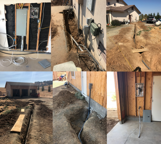

  12. So, after digging a trench 24" deep and 120' long and laying 2" conduit containing my electrical service line..... ...I was able to do this... ...and finally, some of this. Doing a little finish work inside while waiting for my stucco guy to get back to me. Garage doors are also on the "ToDo" list.

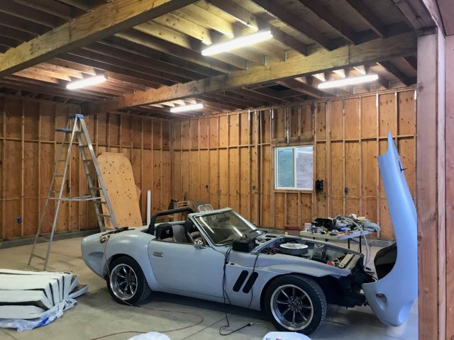

  13. Sounds healthy too. Always a good feeling when it runs for the first time. It’s no longer just a bag of parts. Well done sir!
