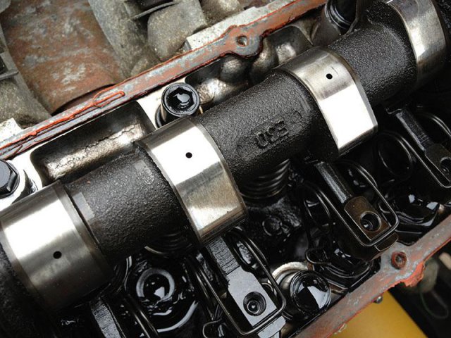

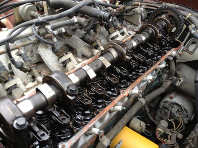

After drain oil, I opened up valve cover.
I expected camshaft might be rusted after 10 years.
Luckily, inside of valve cover is rust free!
Attached File  engine1.jpg   97.83KB   105 downloads Attached File  cam.jpg   100.8KB   107 downloads
Attached File  head.jpg   70.89KB   69 downloads

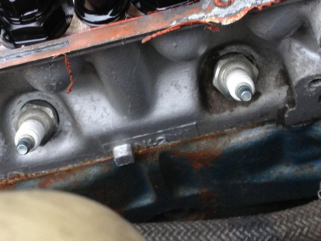

Once thing I'm wondering... My head is N42. I thought N42 has oil spray tube on cam tower, but this head does not have it.
This cam tower could be comes from N47 or later. But is it OK to combine different with them?

Checking cam spec, look for information which cam start having internal oiler.
http://atlanticz.ca/...s/cam/index.htm This site does not mention oil hole.
I found information that '78 cam comes with internal oiler hole, but I'm not sure "E30" stamp on the cam tells something or not for the identification.
I'm not sure just using internal oiler cam with later cam tower works OK or not...

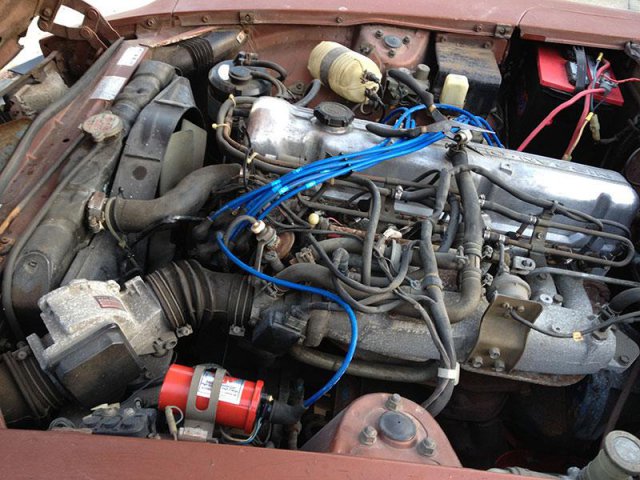

Finally, turn ignition on! .......................... does not start engine as you expected...
Remove spark plug #1 and put it on the top of valve cover with wired.
Turn ignition to see whether I can see the flash on the spark plug. ...... No spark.
OK, change spark plug wire to NGK RC-NE61, and change coil to MSD Blaster 2. I need to order Blaster 2 bracket. original coil diameter is way too big.
I was puzzled whether I need to put ballast resistor as same as what I had on 240z, but for 280z, I don't need it.
I will double check with wiring map later.
Turn ignition again to see...
Attached File  sparkwire1.jpg   100.67KB   37 downloads
:icon10:  I can see flash now :icon10:
Reference of MSD Blaster 2 coil onto stock 280z
http://www.classiczc...28-76-280z.html

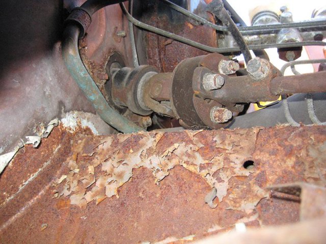

She has two major cancer. Once is floor pan on passenger's side and the other is rear hatch lid.
I was planning to mount R200, L28, install fat fuel line... i realized that decent body condition of 280z is much easier to archive this.
Then I met this lady and decide to just keep one.
Engine is running strong now!
But need to work on brake and clutch now.

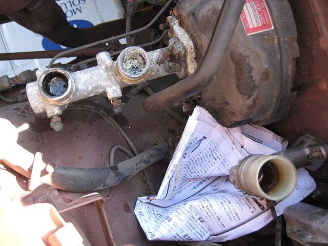

Attached File  BMC_clutch.jpg   86.44KB   56 downloads
Brake fluid is completely leaked out down to the body and paint under the BMC area is pealed out.
I wonder what is the best way to adhoc fix paint for this area...
Attached File  under_BMC.jpg   95.87KB   64 downloads

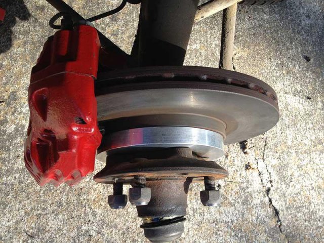

Posted 11 April 2013 - 12:17 PM
Working on rebuilding Toyota 4Runner S12W brake caliper.

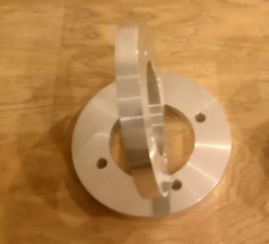

One of the piston got stuck and couldn't removed.
I got advice from ClassicZ folks to mount caliper tot the Z to pump brake pedal to remove it.
Attached File  Brake_Caliper_Toyota4x4_mount_1.jpg   110.42KB   40 downloads
I realized that the spacer I got is for 240z and it's too thick for 280z.
Does anyone want to exchange Slivermine Spacer for 280z version with my 240z version?
Or I will sell this $90+shipping.
Attached File  spacer.jpg   18.23KB   34 downloads

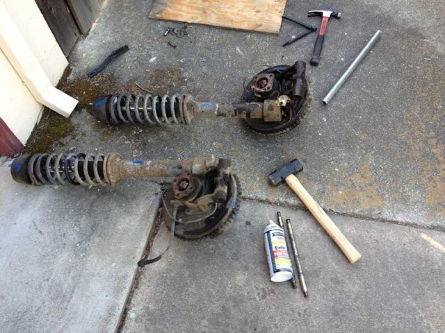

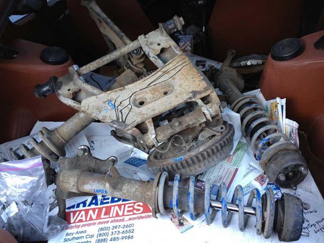

Posted 22 April 2013 - 09:56 PM
Got all spare 4 suspensions from junk yard.
Attached File  suspension.jpg   83.7KB   42 downloads

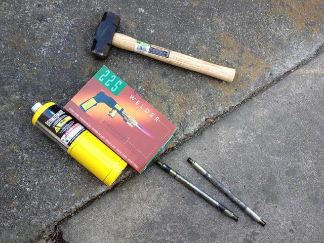

I learned removing spindle pins is one of the hardest work for parting out Z.
Friend of mine kindly let me borrow spindle pin remover tool.
Based on his recommendation, I got yellow bottle of propane tank and big hammer from HFT.
Attached File  spindle_tools.jpg   122.78KB   61 downloads
Oh, boy, the 4lbs hammer is really heavy, but it's so powerful!
I was another lucky guy I can just removed spindle just using hammer with PB Blaster!
It didn't take 40 minutes to remove both spindles from the spare suspension :icon10:
Attached File  spindle_removed.jpg   104.09KB   51 downloads
Next thing is to remove own rear suspension to remove spindles.
Edited by tamo3, 22 April 2013 - 09:57 PM.
