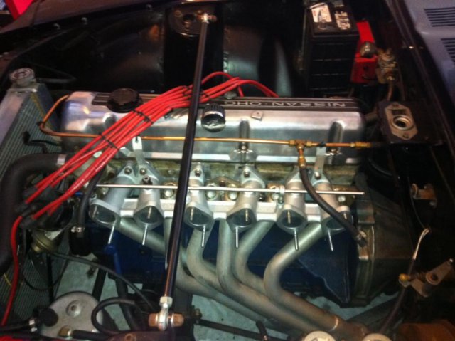

Finally made the switch from SU's to triple webers.  Here's the basics:
3.1L with 470/280 cam,header, exhaust, MSD, etc.
40 DCOE 2's:
33 main venturi
4.5 aux venturi
130 main
180 air
50F9 idle
F11 emulsion
55 exhaust bleed

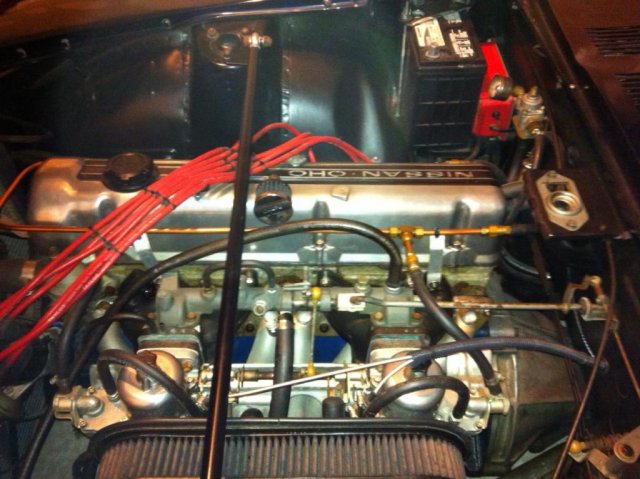

Here's a before pic with the SU's
Started rebuilding the carbs roughly a month ago with a couple of mis-steps here and there.  The carbs looked like they hadnt been touched in over 20 years, and they were filthy with dirt and dried gas.  Between the 3 carbs, I went through about 6 cans of carb cleaner and I still thought they were dirty.  Bought almost all of my replacement parts from Pierce Manifolds...great vendor.  For those who have never rebuilt a DCOE, heed the advice you've read....take your time and dont force anything.  I broke a pump rod due to trying to force a stuck accelerator piston and as I was checking my floats I noticed one of the support arms that holds the pivot pin was cracked.  It broke off completely shortly after.  Hopefully the gas proof "JB Water-Weld" I used to put it back in place will hold over time.
As far as the actual rebuild, it was pretty easy.  Just matched up where the gaskets should go, and referenced the Weber manual.  I took my time to set the floats per spec to 8.5mm/15mm, turned out all of the idle screws to 1.5 turns from fully seated, and lined up the throttle plate edge with the first progression hole on each carb.
Regarding the actual installation, sprayed all the manifold bolts with PB blaster over the past 3 days and went through the tedious process of undoing all of the bolts.  I couldnt see a way to get them all out with anything other than a wrench and 1/8 inch turns at a time...there just wasnt any room!  That or I need better tools.
Got the SU's out and put in a new intake/exhaust gasket and put the redline intake manifold on.
After getting all of the bolts torqued down, things started moving a lot quicker.  I bought the plastic anti-vibration mount with O-rings, but after getting the 3rd carb on, I realized that it would be impossible to actually run the air cleaner I planned to use due to interference with brake fluid reservoirs.  So had to take all the carbs off and put on paper gaskets and re-install.  Hopefully it wont be an issue.  Ran the fuel lines, re-attached hoses, temporarily mocked my throttle cable set-up, and crossed my fingers.  Primed the fuel pump and started checking for leaks.  Found leaks and tightened everything back down, and started cranking.  It took about 4-5 minutes of cranking the engine before it wanted to fire up.  Kept at it and she came to life!  couple of blips of the throttle and it quickly settled to a steady 1000 RPM's.  Success!  Watched it smoke off all of the PB blaster and let it run for about 15 minutes.  Checked my fuel pressure gauge and was at 3.5 psi, and my AFR was fluctuating at about 10.5 - 11 at 1000 RPM idle (using an AEM UEGO w/b).
Revved her a few times to hear the glory, and noticed that I was occasionally getting what sounded like a misfire.  A couple of other blips, and I would get a backfire out of the front carb, on the rear barrel.  It happened twice, and was something I couldnt replicate consistently.  I'm going to try replacing my spark plugs in the next few days and start paying attention to how they look.  Hoping to actually drive the car tomorrow.  I still have yet to sync the carbs, tune anything, or completely address my throttle linkage...I probably should do all of those things...but I just want to actually drive her and see what its like under load!
My initial impressions, this is gonna be a hell of a "project" with a lot more work to go!.  I was hoping I could get the carbs on the car for about $500.  I got the carbs, manifold, and linkage from the PO with the car...with all the other misc pieces and "while I'm at it" stuff...so far I'm about $1600 in!  A lot of the cost came from air horns and new main venturi's (carbs came with 30's), but there were a lot of little odds and ends that added up quick!
I still have to install my heat shield, dial in my throttle cable / linkage, and figure out my ignition timing.  For those thinking about going to triples, you have to admit they look awesome.  Now back to re-reading the Weber FAQ for the 15th time.
