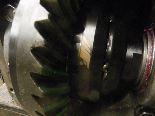

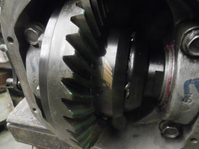

Found a socket that fit in the two washers very close and got them lined up to each other and the axle bore. Got the runnout and backlash down to .001" variance. Ended up with the same shims as the old carrier. 2.30 driver, 2.15 pass. and the tooth contact is good. So back together and back in the car, should be on track in another month. So all's well that ends well.

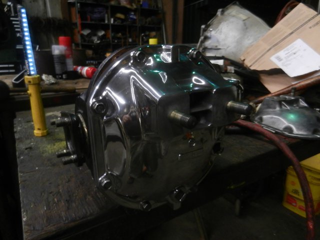

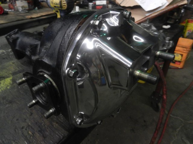

Got the M Factory LSD installed one down and one to go. New Bearings & seals  No Problems,
