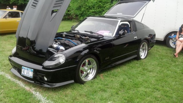

Hey guys it been a while huh. Well me and xnke went to the drag strip last Saturday and the first pass out i was joking and told him i was going to cut the tree down on him. My reaction time was 0.422 and i hit it hard out of the hole. The car shook so bad my sun visors came down and it threw my keys out of the ignition into my lap. I found out about the keys when i got to the staging lanes and went to shut the car off and the keys were gone! They were found under my crotch in the seat. Any ways some back story for you guys that dont know my car. L28et big cam Turbonetics To4e 50 with stage 3 turbine wheel .63 turbine housing. Im also running megasquirt ms1 v3 at 16 psi that night. The last time we went i had the same setup but still had the stock diff (open) and it launched hard with little to no hop just some tire slip. I have been running this obx diff for over a year no issues until we hit the track. I checked my axles and driveshaft today at work everything good and tight. After all the shaking thought it was worth looking because it was the most violent tire shake i have ever experienced in any car. Do any of you guys have this problem? Im going to switch all my rear bushings to poly next week to see if it helps when we go back on the 29th. All i could manage was a 13.4 at 104 and last time with open diff same boost ran 13.1 at 108 but without wheel hop giving me shaken baby syndrome. Thoughts

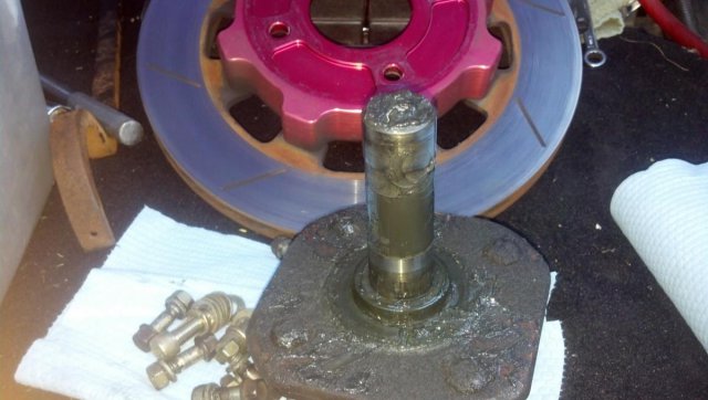

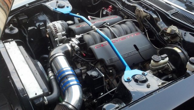

I have a 83zx with a ls1 in it with 400whp. I was having the same problem with the wheel hop which was causing me to snap stub axles. a guy explained to me as the car squats it toes in causing it to lose traction, as the suspension unloads it gets grip again causing it to squat and repeat the vicious cycle. I also feel it was because I was bottoming out the struts which cause the rear to bounce back up...I have poly bushings, quife rear diff, whithead performance 300m stub axles (which took 8 months to get), with 300zxt half shafts and I have had custom springs made a couple times and now im up to 420lb springs. the car still rides pretty good and it only squats a lil bit. it runs consistent [email protected] with 1.75 60FT times. the car hooks so good with 235 wide tires. I hope this helps. I am curious exactly what you did to move the rear subframe back. I have been wanting to do that for years.
