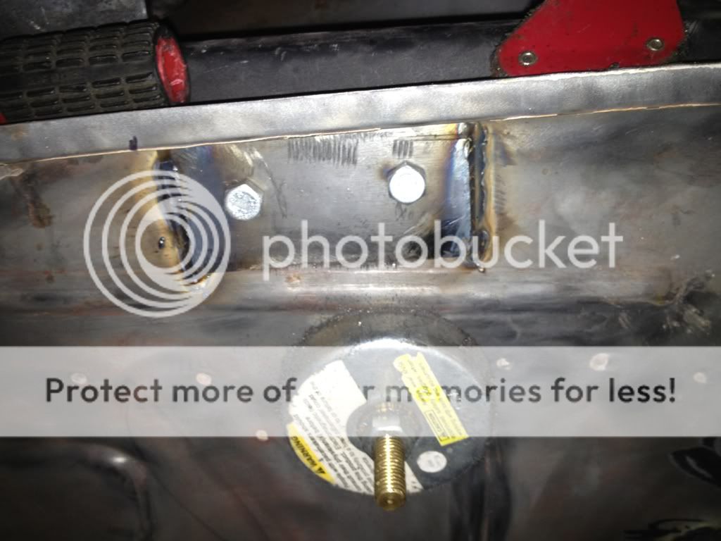

Mind if I ask how you attached your bedding posts to the bottom plate?

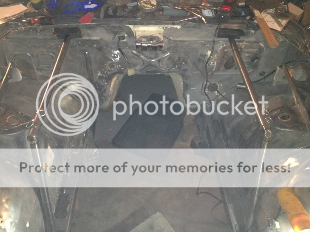

Thanks for the comments. I am pretty proud of my creation. The design is nothing radical but I believe the use of CF tubing is.

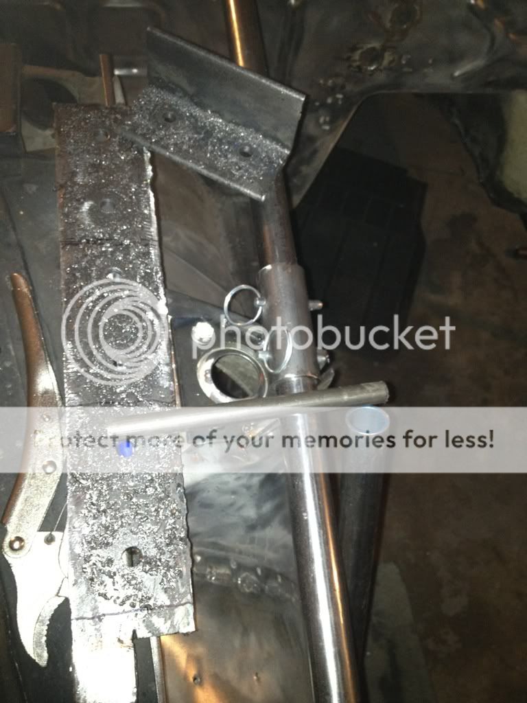

My design has the bedding posts flush with the underside of the frame rail. The sway bar top plate and clamp rests against the bottom of the bedding posts therefore the posts take all of the clamping force. The threaded centers protrude from the frame rail and plates enough to get a nut and lock washer affixed. Unfortunately I do not have an image captured from the underside to show this.

Litman: I see, I did the same but I guess I'm worried that they might fall over if I try to extract them and be lost inside the frame rail. Probably being far too paranoid again.

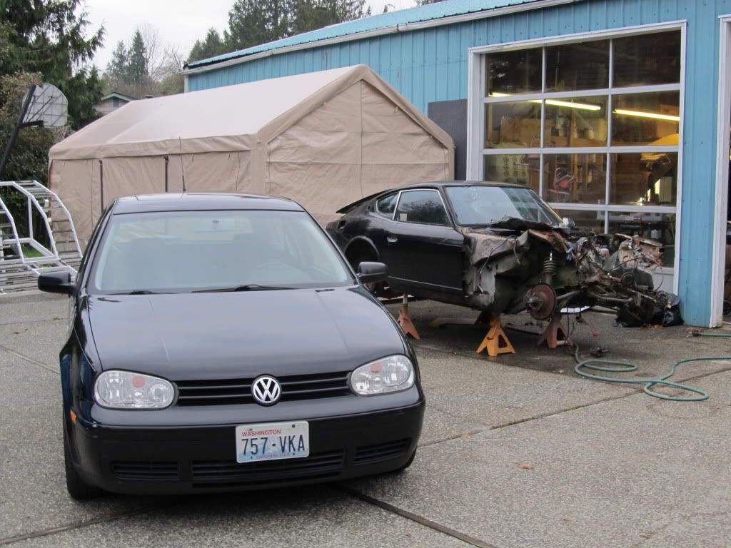

Pictorz
I guess I dont have any photos of the huge vented lighted paint booth, so heres a little bit of it with the parts z and le gti vr6

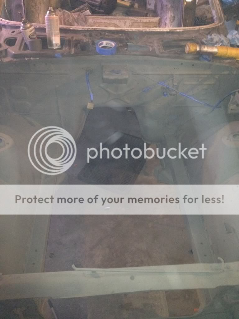

I finished my last final today, thought I'd head into work and grab a few hours before I head home to sleep a bit. Then wake up and finish up the passenger side I never finished.
Body filler is almost done, just need to putty some small holes. I'm pretty sure I have enough primer and undercoat, just need to grab some truck bedding to finish off the interior.
Started spraying the rear end and realized that I couldn't spray the engine bay until I mount the clutch slave cylinder (bracket was welded on somewhere), realized I couldn't mount the clutch slave without knowing where it's suppose to go (if I remember correctly, it goes somewhere on the frame rail near the battery tray?) trying to find a bunch of reference pictures for engine bays and transmission tunnel.

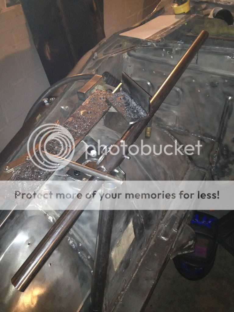

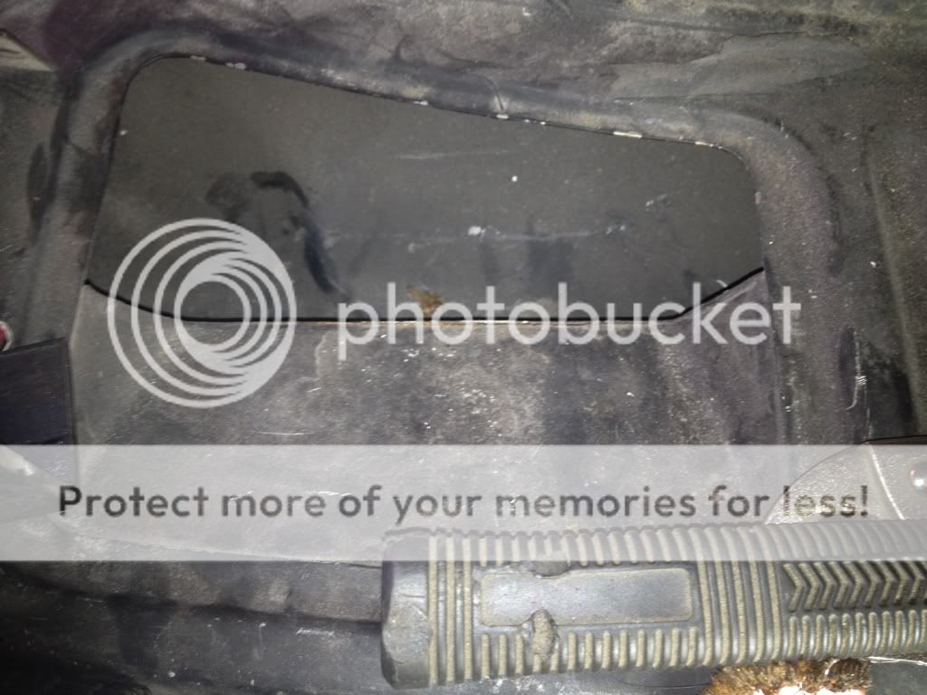

So not sure if anybody saw this coming...but the passenger side is different.
It has this little cover, and underneath the cover is an intricate layer of metal with the purpose of providing fresh air for the fan to pull through when using the heater.
After much contemplation, probably about half an hour or more going back and forth, feeling around, generally debauchery, and swearing, I came up with this solution.

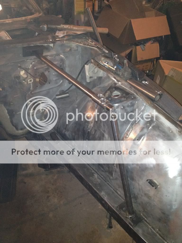

Mount it like I did for the harnesses.
And voila, can't really do the cross strut brace until the engine and hood are in to check clearance, but a tad more body work to do, a little more welding up front, the rear strut brace, and the fuel cell cover plate flap, and we'll be on our way :).

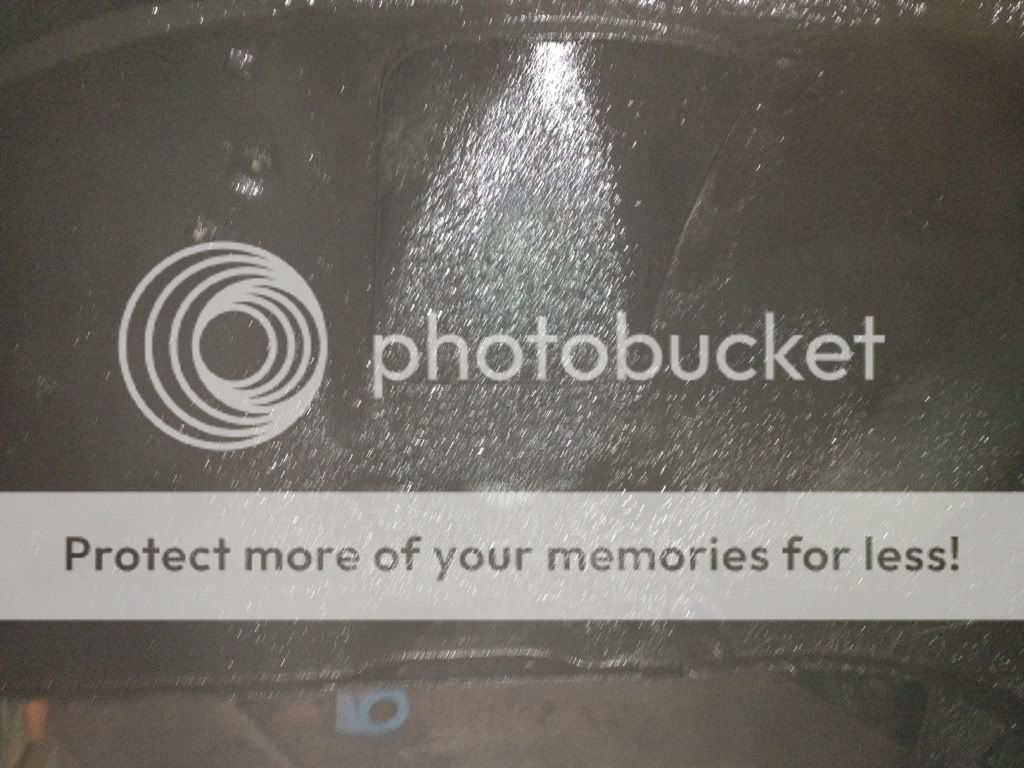

Been working a few hours every day; I can see why people end up using so much body filler, it really is an endless process trying to get the curvature just right, etc etc. I think I'm finally done unless I choose to revisit two or three spots. We'll see by the time I get there.
Sorry this isn't where the car is currently, but to show I'm in a step in the right direction...
The front strut brace is primered as well, I figure it would be pointless to paint it, only to bring it back down when I weld in the cross brace.
As of now, I used some caulking on the engine bay, some 3m fire retardant stuff. I'm not too happy with how it applied, but we'll see how it cures. The front 1/3 of the car is primered/undercoated, I'll be applying the paint for the engine bay tomorrow along with taping off the rest of the interior after grinding down some spots underneath. The first white spot may be appearing tomorrow if all goes well :).
