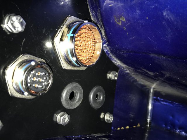

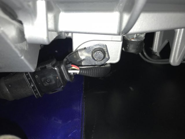

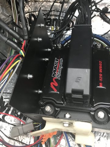

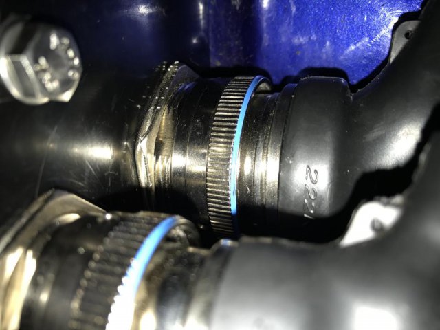

Moving along at a turtle's pace but moving along. Got a new job and I'm doing quite a bit of traveling therefore the car will not get worked on as much as I would like. I was able to finally get the plate I had made for the Mislpec wiring harness bolted in place and the harness fitted. The plate fits under the battery tray at the firewall and it's not visible from the engine bay. Used a rubber gasket between the plate an firewall in order to ensure water does not come in to the cabin. Working on the fuel tank next.

Those connectors are pretty slick!  I like that idea!  Are those pictures in the engine bay, or the cabin?

Thank you, they are Milspec connectors. Real easy to engage and disengage. The pictures are from the engine bay side right under the battery tray.
