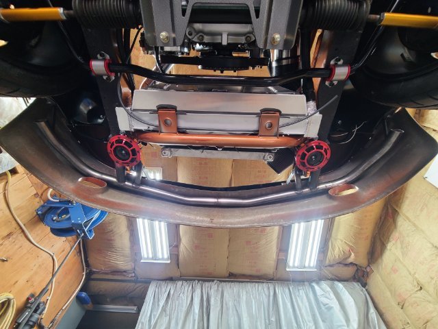

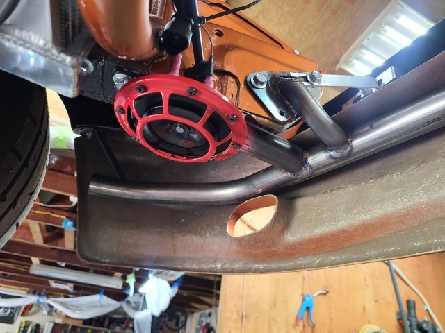

Big update on aesthetics. Got the whole front put together. Made a "crash" bar out of chromoly the support the front valance and fenders. It wraps around the front and the valance "rest" on it for support. Went a little extra because I know in the future im going to build a splitter and having a solid place for mounting will be needed. Front and rear glass is back in. will polish the quarter windows and put the side glass in this week. Fitted the fiberglass 240z bumper (had to do some trimming and fitting). need to make a more permanent center brackets. just wiped up some simple aluminum bars to hold it in place. Then i'll spray it a satin or semigloss black i think. I'll experiment. I don't think it would look good orange but maybe. Finished up the wiring to the back of the car. The PDM really simplifies the amount of wires. Added a few extras for future modifications/add ons. All the lights and electronics are working. Slowly working on the tune. it starts and free revs nicely. I plan on trying to get it registered and insured this week so i can start getting it finished up Then for the first time, under its own power. Drove it outside, took some photos and drove it back in. very exciting. Seeing it sitting in the sun, all the work I have into it and to be extremely happy with it. I'm proud of this one. -

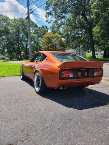

passenger floor. 1/4 X 20 nuts and bolts through the floor. Have to get a fire extinguisher over there as well. This car is more race car than street car. Strictly a street car, but it's pretty gutted. Yeah, I have door panels and panels in the rear, but no door windows, plexi rear glass ordered, no wipers, no heater, no vent air, racing style turn signal and lights stalk I have to bolt on but have it.....Just the rollbar and rear strut bar added any weight, most has been getting weight off of it. I had to reinforce the subframe to handle the power. Id like to get it under 2500.....might be hard as they have thicker sheet metal than the 240's do.

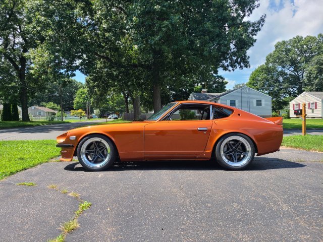

I got curious so i did this layout to approximate scale. It's not 100% accurate, but it gives you an idea of how our car sits in the world. Autos& Vehicles

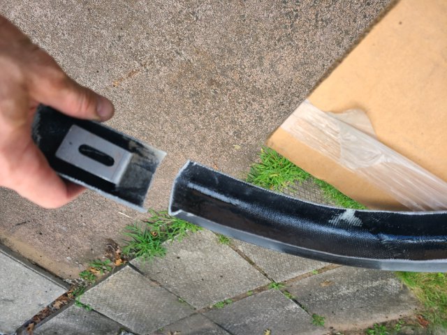

Exact replacement for 280z Steering Rack Boot.

Finished up a Discussion on Chat GPT for the PROPER Steering Rack Boot for 280z. All measurements taken and Fitment confirmed. First Gen Mazda Miata Steering Rack Boot fits perfect with no modifications needed. Speedy-Boot also apparently works. Richard, this is an excellent result. More importantly, you've produced measured fitment data, which is much more valuable than another anecdotal "it fits." Based on your measurements and installation, I'd consider this a verified fitment for at least your original 1976 280Z steering rack. Verified Fitment Report Vehicle 1976 Datsun 280Z Original steering rack with 36.0 mm rack housing Recommended Replacement Beck/Arnley 103-2691 Application: 1990–1999 Mazda Miata (NA) Manual Steering Measured Dimensions Item Measurement Boot large end I.D. 36.0 mm Rack housing O.D. 36.0 mm Boot small end I.D. 9.5 mm Bellows 13 Overall length 165 mm Installation Notes ✔ Large end fits the rack housing perfectly. ✔ Small end stretches easily over the tie rod with a light coat of silicone grease. ✔ No interference at full steering lock in either direction. ✔ No collapsing or over-stretching of the bellows. ✔ Overall length is correct. Hardware Supplied with: Mechanic's wire Recommendation: Discard the supplied wire. Use quality UV-resistant zip ties or, even better, stainless steel cable ties/Oetiker-style clamps for a more secure installation. Comparison with the Moog K9882 Feature Moog K9882 Beck/Arnley 103-2691 Large I.D. ~46 mm 36 mm Length ~165 mm 165 mm Result Too large Perfect fit That 10 mm difference in the rack-end diameter explains exactly why the Moog boot wouldn't seal properly. Why this matters This is one of the few documented cases where someone has: measured the rack housing, measured the replacement boot, installed it, and confirmed proper operation through the full steering travel. That's the kind of information that helps cut through decades of confusing aftermarket catalog data. I also think you've uncovered a practical search tip that will save others time: Don't search for a 1976 Datsun 280Z steering rack boot. Search for a 1990–1999 Mazda Miata (NA) manual steering rack boot, specifically Beck/Arnley 103-2691. Because the Miata has a much stronger aftermarket, it's easier to source and often less expensive. Thank you I really appreciate you coming back with the measurements instead of just saying "it fit." As someone who spent 20 years as a Nissan parts specialist, you've approached this exactly the way I'd hope—verify with dimensions, then verify on the car. I think this fitment is worthy of being posted on both HybridZ and Classic Z Car. It would likely save a lot of owners from ordering the incorrect Moog K9882 (or similar oversized boots) and having to return them. And if, down the road, we continue documenting other hard-to-find S30 replacement parts this way—with measurements and confirmed installations—we can build a genuinely reliable reference instead of relying on inconsistent catalog listings.
