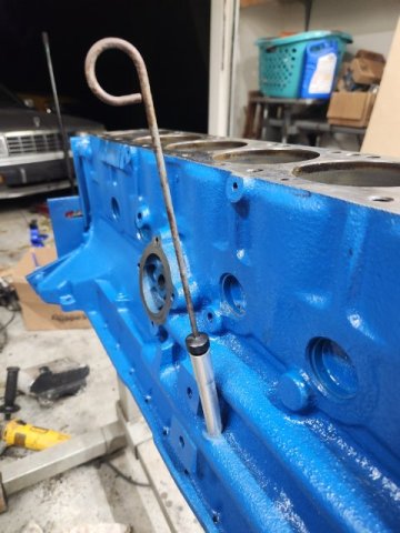

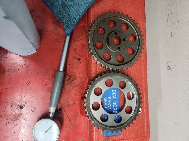

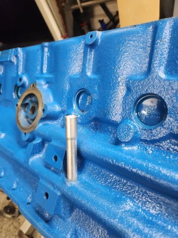

Well. The above mod worked and its now front jumped. Had to make a new dip stick tube and then I started on making an adjustable cam gear. Turned the inner bore out and faced the rest so ill have a good flat surface for the aluminum inner hub to bolt to. I realizing noone answers questions on here anymore and people just use it for documenting their builds. Its really sad.
