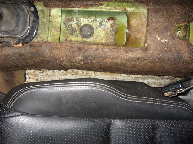

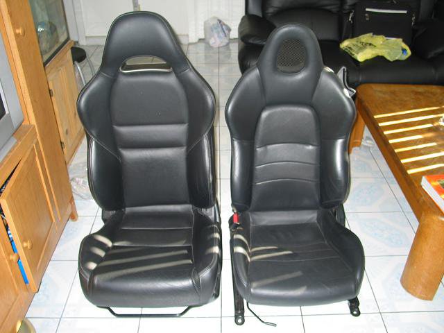

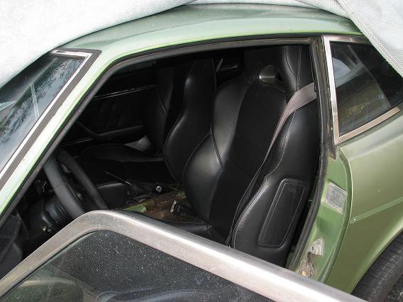

  4. I posted pictures of my RSX 2004 Type S seats in this other thread: http://forums.hybridz.org/showthread.php?t=121121&page=4 Recommendation: Go S2000. I had to change over to a 13 inch steering wheel, or else no leg room with this swap.

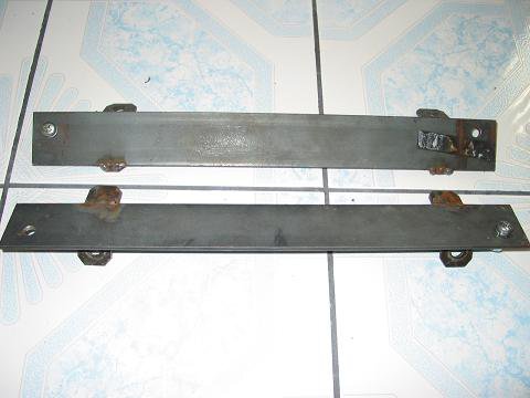

  5. These are 2004 RSX type S seats. I did the same thing the member with the S2000 did on his. Bang down the tranny tunnel on the driver side. The 240z's tunnel doesn't have that extra bulge like the 280's does, which you guys probably already know. All i did was chop off the RSX brackets on the sliders, and made custom brackets using the OEM L brackets from the 280z's sliders. The seats barely clear, but fit in the car just perfectly. My cousin put S2000 seats in his Z, so i was able to compare the difference. You get less clearance to the ceiling as you can see with the RSX seats. The RSX seats are also a lot bigger and weigh probably 2 times as much with all the junk in it ie:airbags, heater, etc. S2000 seats are also much more comfortable....maybe i made the wrong choice. If i had to do it again....S2000 for sure.t
