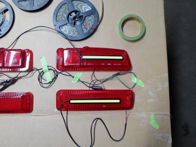

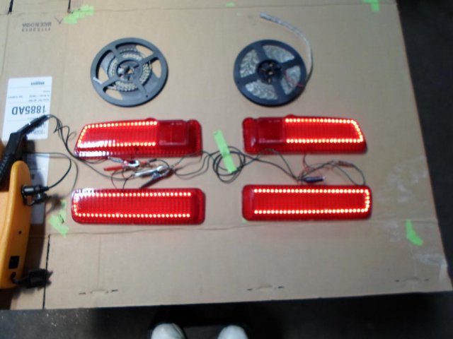

	What do you guys think about dimmer effect as suggested by Pharaohabq ? The running lights , at the moment , are very bright , more like brake lights . The more I look at them , I like them the way they are without adding anymore LEDs . Thinking of dimming the LEDs for running and full power for turn/brake . Did that earlier with an inline 120 ohm resistor , cut the light output over half ( still visible ) .
	Test ran the LED sequential modules today and , with my luck , one module is bad .

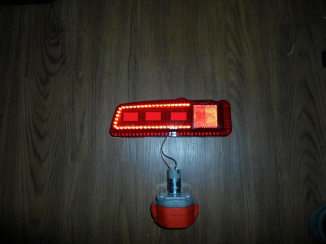

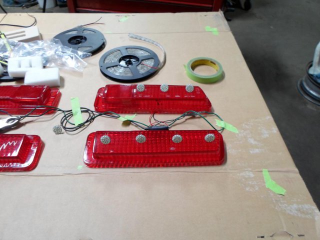

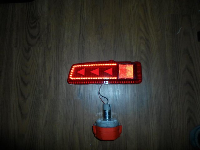

	Will be using light bars , since I already have them , for brake lights . Turn signal will sequential with round LEDs . Here are 3 patterns that I'm thinking for the face plates . Please vote . A . B . C . Here's a blank one for your design .

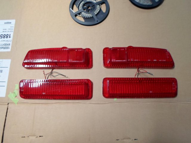

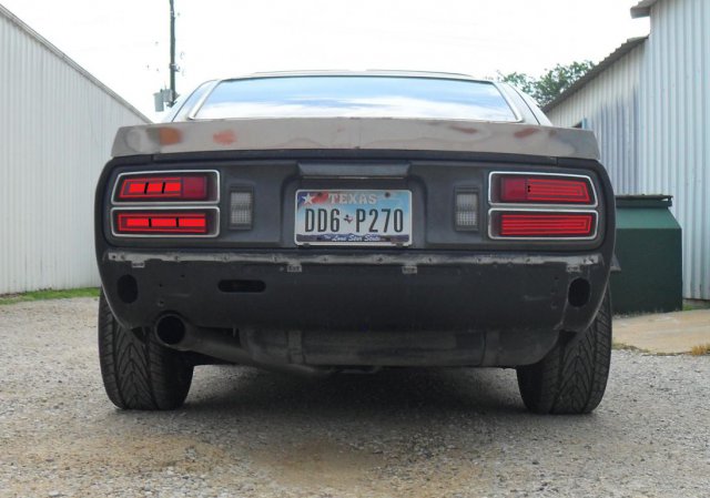

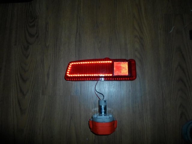

	Running lights are done . Still have enough LEDs left to do another set or two . Turn and brake ideas . Need some ideas , people . I'm thinking round so I can have sequential turn signal . And with round LEDs , I can cut out face plates with any shape or pattern .
	Halos are running lights .
	Here are few night shots , not completely dark outside . It's hard to see the halos , too bright . With headlights on , can't even see them . They look better in person , too bright for the camera to pick up the halos .
