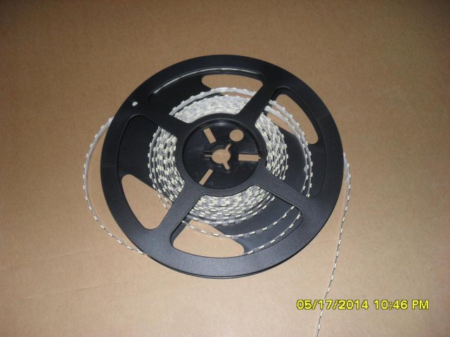

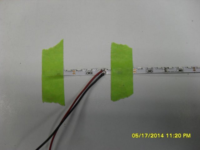

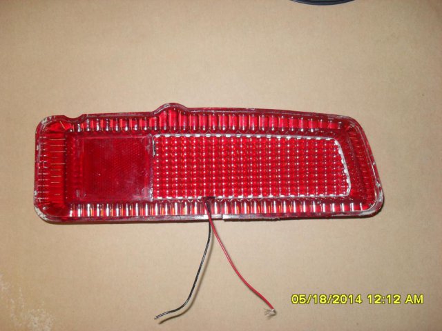

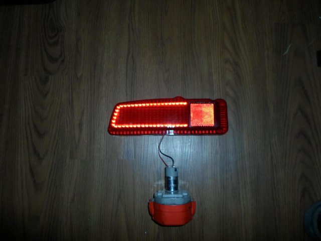

  1. Running lights . Side emitting LED strips , $45 for 5m w/ 600 LEDs . Cut to fit lenses . Soldered wires . Peeled tape and installed . Added power and enjoy .

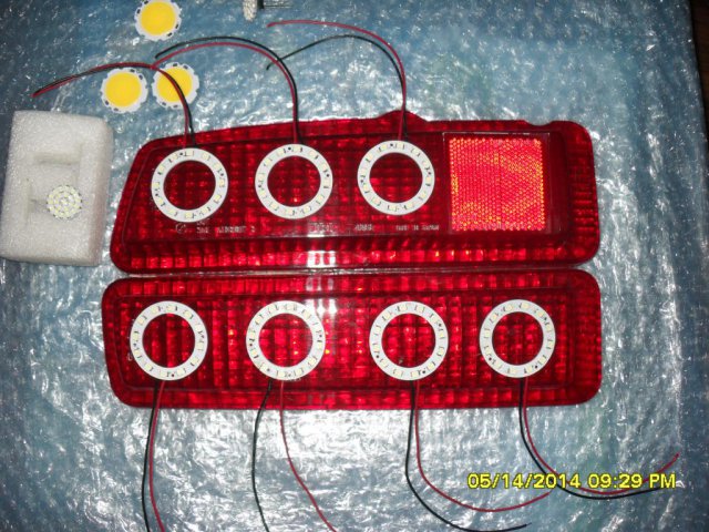

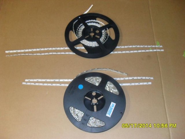

  3. Here's a blank one for you guys to copy and fill in . Side emitting LED strips just came in . I'll be doing running lights soon , going with option " A " . Please post your ideas on turn signal and brake . Keep in mind , my sequential module ( for turn signal ) can only drive 3 LED sections/groups . My friend suggested doing starburst turn signal but I don't think there's enough room on the lens for that .

  7. That's my plan . The perimeter = running , top 3 round LEDs = sequential signal , bottom 4 ( maybe 5 ) round LEDs = brake .

  11. Playing around with turn signal and brake lights ideas . Need inputs , people . Option 1 with COB LED light bars , no sequential turn signal . Option 2 with LED rings , sequential turn signal . Option 3 with round LEDs , sequential turn signal . Welcome all ideas .

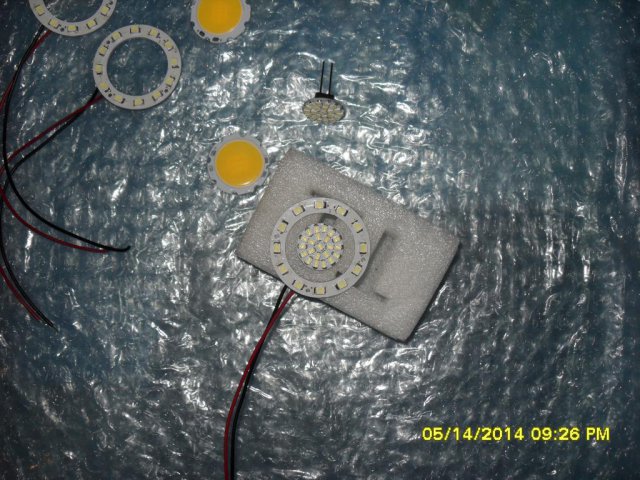

  16. Thanks for the info on the driver chip . I thought each light module ( ring ) has everything in it , just supply 12V and go . I do like the idea of dimmer effect too . Thanks .

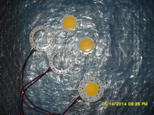

  18. COB LEDs replacement came in today , still waiting on side emitting LED strips . This was the original plan , with COBs . Here's COB replacement . Here's the plan with sequential signal ( top lens ) . Your thoughts . I kinda agree with Hypertek . Second plan is to use side emitting LED strips ( running ) on the perimeter of the lenses , similar to Charger and Challenger , and small round LEDs in the center ( signal and brake ) .

  20. I think 140mm is the OD . That's how they are listed on eBay . The next larger size , if there is one , won't work with the Z 7" headlights . The rings are glued on the outside , don't recommend to do this without headlight covers but I think they are waterproof , not 100% sure .
