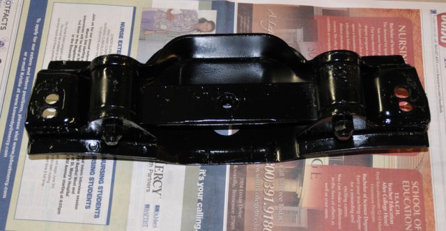

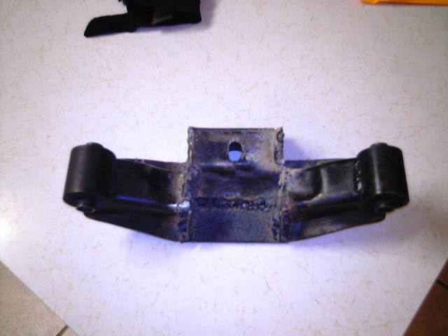

Haha, yeah it sure is That pic is going to my mechanic on wednesday when he fabs up the same thing for me You said it was your first welding piece ever, but i have no welder so they are doing it for me. Seriously, that looks fine to me. Make it a bit tidier on the welds and joins perhaps and it would be what i am hopeing to have on my car. I don't know why the guys were bagging on you. I have that thread bookmarked in my "Z gearbox Swap" folder -

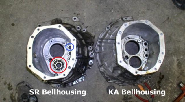

I am in the process of doing this swap.... Infact i just picked up my modified bellhousings today from the shop... The bearing and shaft holes are the ones that need fiddling with. The SR bellhousing has a larger bearing hole than the l28. HOWEVER, the inside diameter of the two different bearings are the same. Therefore, just use the SR bearing, the L28 shaft will fit on/in properly. The only other thing to contend with then is the fork hole. It is 16mm instead of 14mm, so you will need a 16mm outer diameter, 14mm inside diameter spacer to wedge in there. The other 2 holes, not circled in the picture above, do not need altering. THAT IS IT!!! One more thing.... WHY?! Seriously, the drive shaft will cost you MAX $150 to have it shortened and balanced with new cv's and the dust cover taken off and the SR gearbox is TONS stronger than the L28. My N/A L28 is punching 180rwhp, 240rwnm and i've been through 4 gearboxes in 18 months. The Z gearboxes are just getting old. The NEWEST Z gearboxes are 30years old.... Their at the end of their servicable life in my opinion. The SR gearbox is an UPGRADE, and the SR gearboxes are about half the price of an L28 gearbox.... (well in AUS anyway)... So whilst, YES, you can do it, and it wont be difficult (see above), i just dont understand why you would want to do it when it will be far easier in the long run to just make a new driveshaft and tranny mount. If you have a 240 with the tranny mount that bolts upwards, then all you do is turn the original mount around, and drill two new holes ~5mm further back on the mount, and your tranny will bolt straight in (the Z tranny mounts fit on the SR20 gearboxes). If you have a 260, where the tranny mounts are parralel with the gearbox tunnel, simply cut the centre section of the tanny mount out and re-weld it 35mm further back. Viola, tranny mount lines up. Another thing. Why not put the SR20 as far back in the engine bay as possible for weight distribution? Friend is doing this, the tranny mounts (SR20 box) are basically the same procedure as i just described, and the tail shaft just has to be shortened the correct amount. PICS. (see attachments) side by side comparison gearbox bellhousings 260Z gearbox mount modification 240Z gearbox mount modification Useful link: How to install an SR20 gearbox into a 240Z http://home.comcast.net/~zheimsothtn/transmission.htm -

	Cheers Flexicoker! The gearbox guy said the shaft would bend and twist, I figured that this would put the mesh out and would be bad. No good about it. Well armed with everyone's ammunition I went in and spoke to the machine shop. When I originally got them to do the work I supplied a photo of a completed bellhousing (http://home.comcast.net/~zheimsothtn/Transmission2.htm) that had measurements on it. I told them to ignore the measurement of the bearing and said that 'this one' (i supplied a bearing) should fit in this hole, but total work should look like the pic. They promptly forgot that I said ignore the gear measurements and went by the directions on the photo and put a 4 tho clearance on the bearing. My fault for not crossing it out I suppose. They are going to score the bore on the bellhousing to reduce the clearance and reccommended I use locktight to hold the bearing in. I also supplied a new bellhousing and they are doing the work again with proper bearing clearance (0) this time. Total cost for new bellhousing and scoring the bore $100 less than the original bellhousing. I'll use the good bellhousing and sell the patched one to someone who isn't racing their car. This is my first project on the car without outside assistance from my old man, so if it costs me $200 on a $1200 project to learn these leasons then I guess it coulda been a lot worse. Thanks again for the help guys! Tom.
	Ok, well before i go in tomorrow and make a fool of myself is there any other reasons why a bearing shouldn't be this loose? The gearbox guy was saying (and it makes sense) that the wobble would allow the shaft to bend and twist under load. The gears are essentially trying to push themselves apart with the force from the motor and this wobble will allow the shaft to twist. This would allow the gears to come out of mesh and they would literally eat themselves apart. Is this possible or rubbish? Sounds feasible to me... Tom.
	Cheers dan5138. I'm not too comfortable with glueing the bearing in to be honest. Certainly sounds like it's too loose though. Oh well, I will speak to them on wednesday and see what they have to say.
	G'day, I'm in the process of putting an nissan 'C' box in my car and I have had the counter shaft bearing hole of the 'B' bellhousing bored out to fit the larger bearing in the C boxes. I just picked it up from the machine shop and it seems like it has a LOT of play for a gearbox bearing. It slides easily in and out of the hole, you can wobble it slightly, however there is no visible verticle movement. Comparing this to the main shaft bearing (not bored) that has to be tapped in and is a PAIN to remove, I am not confident that the work is any good. However, I am not an expert on this and would like some advice. Do I continue and use this bellhousing, or do I have to get the work re-done by the machine shop. These guys are driveline specialists and they know what the work was for, so one would think they would know what they are doing. However, from my powers of observation this bearing seems much looser than any others I have dealt with in these gearboxes before. Thoughts much appreciated!! Tom.
