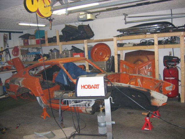

I ran into the exact same problem. I ended up hammering that bend flat and rebending where it needed to be. I did it with my bench vise and a hammer. Not to hard but took some time to get it to fit right. Here's how i got the final shape right. Take a thin piece of metal (1/4") and bend it over the rocker to get the shape that the panel needs to be. Take that piece to the bench with you and work with your patch panel until you get the right shape. Final fit was not perfect but it can definitely be worked with. Nothing some final hammering and light bondo can't fix!! Good luck!! -

Wow! have fun! Don't expect perfect fit. I had to work my stuff to get it to fit right. Tim from Tabco never called me back. Ball is in his court now. Here's some pics of my finished product (before and after shots) Still some "fine tuning" required. All in all though, i'm happy with the results. -
