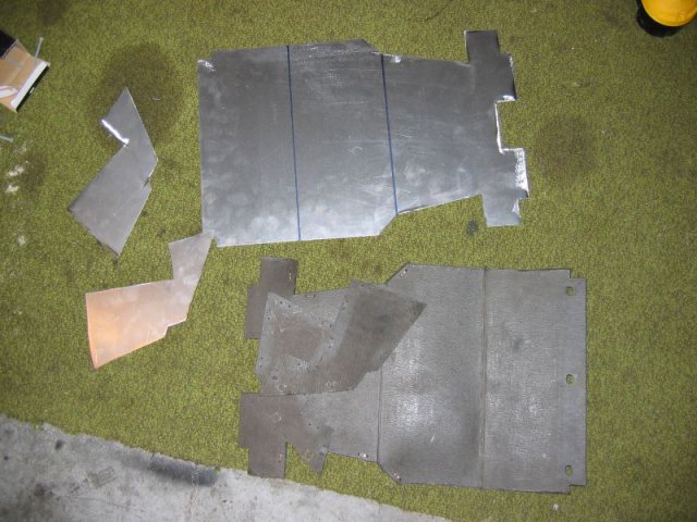

  2. Working on autocad plans now. First run soon... hopefully. New ones will have better fitting joints and crisp bends and laser cut edges/holes for installation.
  3. Exactly what I thought. It's like a 1/8" rigid cardboard like material. Don't know why they would have chosen that. Metal/plastic seems much more logical. Can't believe no one has made a replacement in any other material either... UNTIL NOW!! I think the pattern that I have is only good thru '73. I'll have to do some more research for the later years to see if I can make some for them also. Anyone know have any later model boxes that they would mind donating to the cause? I'd pay shipping.

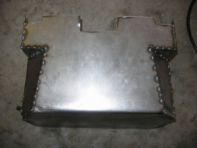

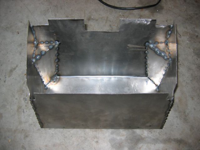

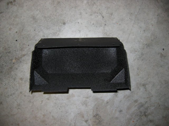

  4. Hey all, I have pics... it'll be a few days before I can get them uploaded though (holidays/no internet at home). I guess the benefit of the metal box would be in the replacement of the flimsy paper one that seems to deteriorate over time. I'll need to do a bit more fit tests to be sure that this thing can be installed without removing the dash. My dash is currently out of the car. There is a weight gain from the metal box but I imagine it's negligible. I suppose if folks are interested I could ship it "unassembled" and folks could weld it themselves if interested. The box I built however does not have the overlapping flaps that are used to staple the box together. I removed these during fab so the seams could be butt welded. Adding these overlapping flaps would most likely increase fab costs at the metal shop. Right now my plans are for a simple pattern with two breaks/folds (trying to minimize the shops handling to reduce cost). I've coated the inside of mine with rubberized undercoating. I may hit it with some trim black paint to match the dash as well. I could ship these assembled but without coating if needed. I also know a powder coating guy out here so I’m sure I could have him coat something to whatever color you'd like. Sounds like there is at least a minor amount of interest... so I’ll go ahead and continue with drawing up some plans for the laser and figuring out costs. Metal guy said the first run would be more expensive for the labor time to enter the pattern/etc. Next runs would basically be cost of metal and a small labor fee. Again,... holidays coming up so give me some time to get things going. Keep PM'ing me your interest and I’ll do my best to keep tabs of who's interested. Thanks ya'll Merry Christmas!
  5. Patience, Drax.. Pix to come... as said though form/fit is the exact same as stock.... meaning... looks the same and fits the same as stock, but in metal. actually, welding is the cheap part. i'd be doing that myself. It's the cutting and bending of the metal that takes a large amount of time. that's why i talked to the sheet meatl guy.
  6. I replaced my paper glove box (73 240Z) with a 18ga metal one I fabbed up. Any interest in these? I spoke with a sheet metal laser guy that said he could cut the parts for me. I'd weld them together and send them as is or like I did mine with rubberized undercoating inside. Form/fit is exactly the same as stock. i'm thinking maybe $50-60 +shipping (depending on what laser guy charges me). Covers my cost and time. PM me if interested. If I get enough interest i'll try and plan things out and get a run cut.

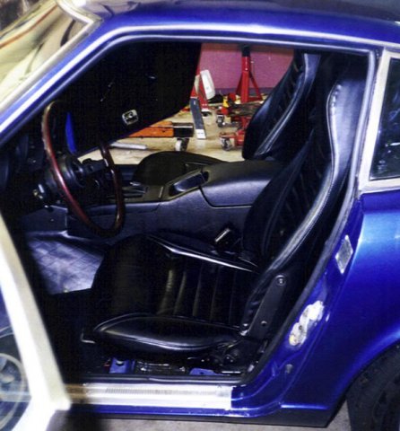

  11. Maybe you had the earlier style seats (like from the 320 or 2002?) O don't htink i can take the rails off without losing alot of the functionality of the seat. I'll try and post some pictures soon.
  12. Cool. Can I pick your brain on how you installed yours? They sit higher than the stock seats so it looks like i'll be removing the stock seat mounts. I planned on bolting some 1x2 rectangular stock to the floor pans (with a backing plate on the underside of the car for front and back as support). This seams to be the simplest way to get these things in. They'rs comfortable seats, however, not meant for a guy who's a few pounds over!!! Incentive to lose a few I guess!
  13. Buddy just sent me a set of 1988 BMW 325is seats he wasn't going to use. They're in great shape and look great in the S30. Look like they're supposed to be there and have lots of adjustments. I think i have the mounting fgured out. Should be pretty simple with the use of some 1x2 rectangular stock and the removal of the current seat mounts. I'll update when i have it figured out.

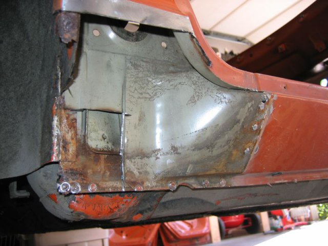

  15. My car was originally a california car... lucky me. Rust at the battery tray, rear lower quarters and on the underside of the lift gate. That's really it. Here's my progress: (Thanks to Rags for supplying the sound battery tray area for my repair!!)
