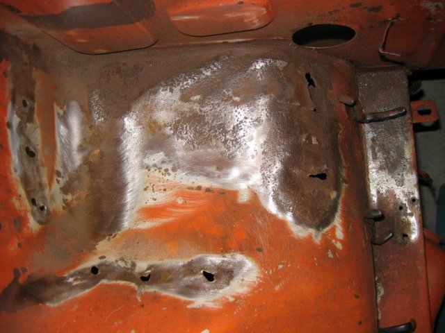

  13. Well, I was cleaning everything up, got most of the rust out and thought I should test the area to see how thin it was. I put a putty knife right through it! Sooo, area has been completely cut out and is currently being preped for replacement/welding. I did end up shooting some rust converter into the junction of the firewall and innner fender though. i figured that sand blasting may not even get in there and that a liquid seeping in there may do a better job. Only time will tell! Thanks all! I'll post some pics soon. Also, I made a home made spindle pin puller with galvanized pipe parts from home depot. Cost me about twenty bucks. Worked pretty well on one of the pins but I can't get the other one out. I'll try and post plans for the puller some time soon.

  16. Yeah, i've considered sand blasting it. Don't know if that's neccessary though. The photo I posted is prior to a more aggressive surface prep. Everythings really in pretty decent condition (with the exception of the holes/mess I made while removing the battery tray). The area i'm mostly concerned about is the junction of the firewall and the inner fender. Doesn't appear to be anything more than surface rust there. No rust thru on the inside of the firewall either. I think i'd prefer to clean up the area as best as possible and hit it with some rust converter. Any suggestions on a good brand or are they all pretty much the same (something I could get from Autozone/Advanced is preferable).
  17. Hey ya'll, I'll be cleaning up my battery tray area shortly and need some advice. I've done a rough cleaning/stripping of the area and have found a considerable amount of pitting but otherwise things look really solid (See photo). I'd like to treat the areas I can't get to with some rust converter (pits and the junction where the firewall meets the battery area). I'd then like to touch up the area with some bondo to smooth things out. I'll be welding up the holes where the spot welds were removed from the battery tray. Any other suggestions/ideas? Any problems with applying bondo over a rust converter? Any suggested rust converters?
