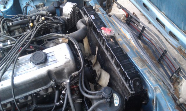

  1. Also, thoughts on an aftermarket fuel pump (walboro 255) with the stock FPR? Edit: Screw it. Bought a walbro 255, also purchased a new center console to go with my dash cap and new door panels.

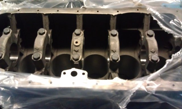

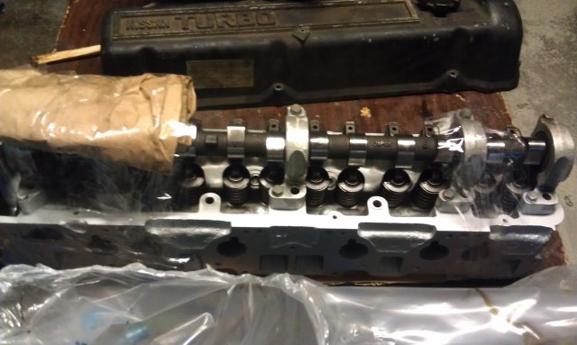

  3. Got the block and head back, cylinders look perfect... head looks great. I'll have it assembled next week. Also.. going to paint the block, valve cover, timing cover and oil pan red.

  6. Radiator broke.. Friend had a spare s130 radiator... Was too narrow and too tall so i did some drilling and made it fit.

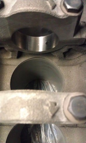

  12. Hi, I'm about to start my turbo swap, so now is a good time to start documenting some real work being done. My car as it sits: Got a f54/p90 today and disassembled, going to send to machine shop for a cleaning, honing and a valve job on the head. Look! Still has cross-hatching So my l28et plan is: 440cc injectors (already have) Shaved (non-erg), Polished intake (already have) 240SX TB (Have) Megasquirt 2.2 (Have) Wideband o2 sensor + gauge (buying this week) Going to use stock rebuilt T3 turbo at 10 PSI for now (Have an ebay T3/T04, will use when I can use my intercooler) Volve 740T Intercooler (I'll be using a j-pipe at first until I get some piping) So a pretty mild l28et build, I'm hoping to be able to make 250 HP at 10 PSI with the stock turbo, but in reality i'll be happy to get the thing running.
