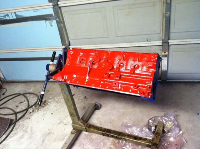

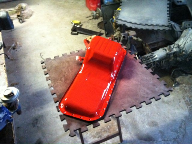

  10. Block and oil pan painted. Oil pan came out a little runny.

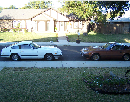

  14. Heres a shot of my white ZX next to my dad's 83 s130.

  16. Just bought my 280zx today, I have s30 as well. Heres the pic next to my dads s130 (mines the white one)
