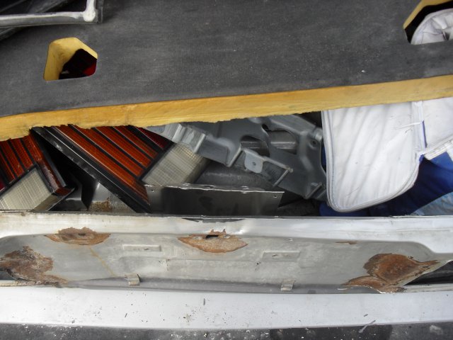

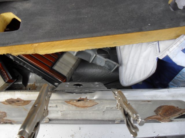

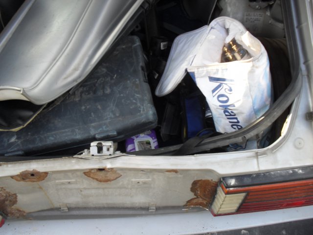

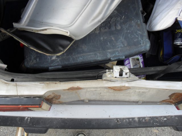

  8. I got it to the right place my way, i know its not perfect but its a hell of a lot better than it was. I have big plans for it any way. Now that the lights point the right direction im going to fix up the rust and put a flat panel there and shave all that uglyness. Ill post some picks tomoro of it fixed. I can cut bend weld bondo and paint but im no hammer And dolly body man so this is my way of Doing it haha
  9. ended up drilling the spot welds for the support and straightening it by hand
  10. its not that easy though, the support where the hatch latch is is to stiff to do that, it would just bugger up the sheet metal, i need to bend the support and the rest wiil come with it
  11. oh dont worry, iv tried hammering. thats the idea iv been looking for! thank you. the P/O's E brake cable snapped.. after that its time to fix the rust
  12. i need to straighten out the hatch latch tailight area, but i cant think how to pull or push on it to straighten it out ps, if you think thats rust you havent seen my parts car
