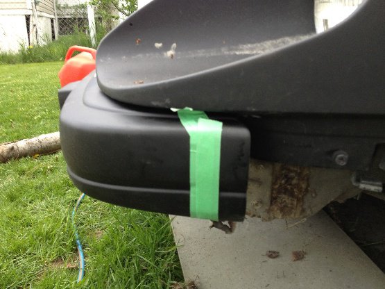

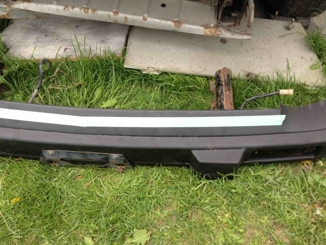

  2. looks great, i went a little conservative on the front only about 2.25" im planning to go all in on the back because the plastic wont look all funny after a severe trimming, id like to remove the tumours sticking out to but i have enough body work atm (join the club right)

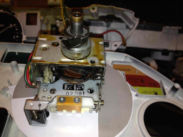

  3. 82 turbo, was a 3 speed auto when problem was created. whether the vent was plugged or something doesnt matter its in the garbage in lou of my 5 speed but anyhow my speedo is full of atf, and reads way off. if i clean it out is my oily speedo cable going to oil it up again? has this happened to anyone else. i have another cable in another car but thats a pain in the ass
