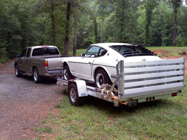

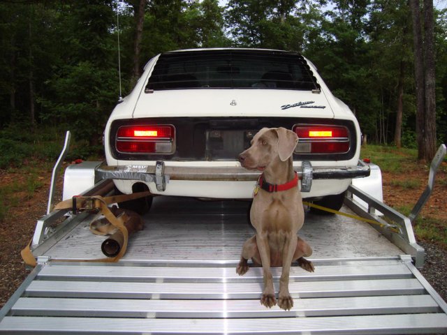

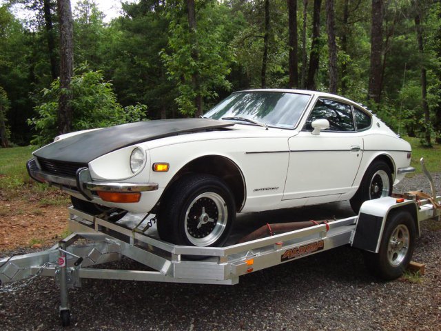

	It's in the $2500 range. This one has a 2200lb axle....they also offer a 3500lb axle. 1 man can easily lift the tongue and walk this thing around. It's decked with solid ribbed aluminum. This is the shortest one you can get a Z on and close the ramp....but they offer a range of sizes/options. Google "Aluma" to learn more and where to buy. I think it's the model 7712 on this page.... http://sale-fire.com/Aluma%20Trailers?p=gcp&gclid=CO6u1YvR7sACFQqGaQodkikA6Q I attached a couple more pics....
	This "Aluma" is what I use when hauling my "Z". Easy to load and pulled effortless behind my 4.7 in the photo....I now pull with my 5.7 and it doesn't know it's back there.
