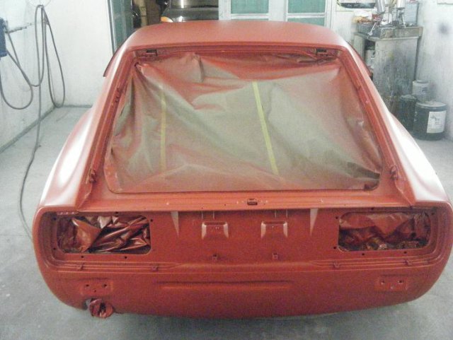

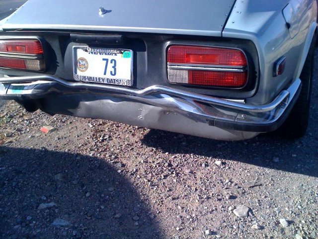

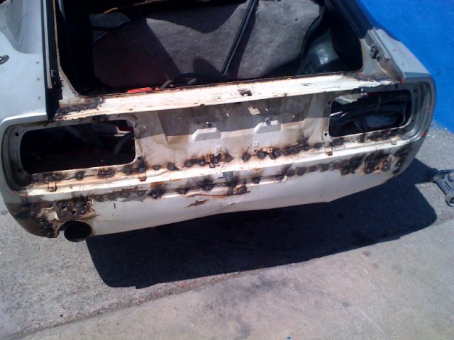

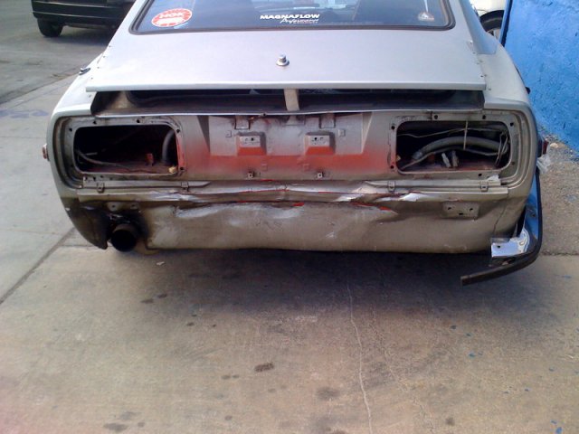

  23. Oh, almost forgot that the Z got rear-ended somewhere in the middle of all this. At least it happened when I was about to repaint it...

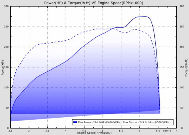

  24. Wow, I guess an update is long overdue. I ended up getting a MAF off a 96-98 Maxima . I've put about 15k miles on the motor and everything is good so far. My goal of having a functional MIL is not looking like a possibility. Even with the "secret squirrel" fix, the ECM has codes for the traction control system. Hopefully I will be able to acquire the stock boost control components someday soon. Even on 6psi of boost, it pulls incredibly strong and is a blast to drive. The Bosch 280ZX fuel pump seems to have no problems feeding the motor. It holds 11.9 all the way through boost. We'll see how it does once its running full factory boost. Under average driving conditions, I'm seeing about 25mpg city and 32mpg freeway...
