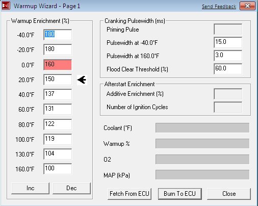

Sorry about that, I am actually in the military and stationed in Southern California. So it has been pretty warm lately. Here is what my warmup wizard looks like currently.

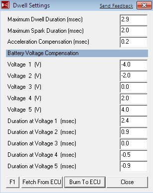

I believe my dwell is set at 2.9 which ought to be about right. I will double check my MSQ and report back.

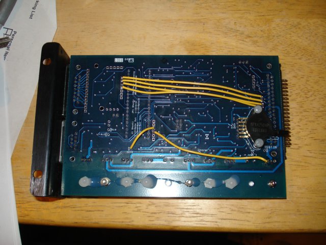

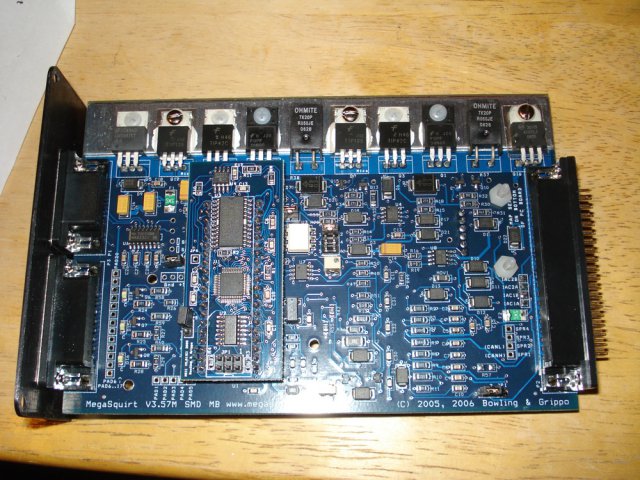

Alright, guys, I got it running. Just to make this clear to anyone who may read this thread in the future: When using a BIP373 module, the wire from JS10 will go to the leftmost button on the BIP373 which is the same as the IGBTIN. There is a patch of printed circuit going between the two. It is probably better to just use IGBTIN as that is what it is there for. Alright, so it runs. Great. It runs like crap though and I am looking for suggestions as to why. According to my wideband, I am super rich. Also between runs I messed with the timing a bit at the distributor and that seemed to help a little. I feel like I may not be getting spark on all cylinders. I have posted a new datalog. I am also including some pictures of the MegaSquirt unit itself, as requested. 20090309.zip

Yeah, I have a BIP373 module on Q16. So, I should not have any other wires connected to the BIP373. The wire going to JS10 should be going to IGBTIN. Correct? Sorry if I am coming off a bit dense. This information is not very apparent to someone who is not intimately familiar with the MegaSquirt boards. I am piecing things together from multiple sources and just want to get things right.
I just found this information on a VW forum. This will all depend on if you have Q16 installed or not (ignition driver transistor). If installed: JS10 needs to be jumpered to IGBTIN Spark output set to non inverted If not installed: JS10 needs to be jumpered to the location Q16 pin 2 (center) Spark output set to inverted

That didn't work. Still no spark. Also, I opened the MegaSquirt. The wire to the middle pin on the BIP373 module IS going to JS10. This is correct, right? Any other suggestions?
