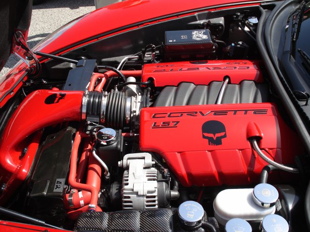

  7. Gentlemen, I see a lot of controversy between 1 7/8 headers vs 1 3/4. I have a 07 Z06 Corvette (pictures attached) with the 427 LS7 and I chose to go with LG's 1 3/4 long tube headers and I could not be happier with the results. When you step up to 1 7/8 you will loose low end torque unless your car has a blower. take it from me, I have owned several LS motor cars and 1 3/4 headers is the way to go specially on the street. The 1 7/8 headers will make more RWHP but only at higher RPM (depending on your cam and other set up) but you will loose low end torque. A lot of people get sucked into RWHP numbers and loose touch with what that means on the street. Torque is king when running aorund on the streets unless you are going to do 80 mph roll ons which in my opinion is not racing. I have raced my buddy who has the same car except he has 1 7/8 headers and a cam and I consistently beat him down the quarter mile even though he is putting down 60 more RWHP but his power band comes on too high into the RPM. He starts to run me down towards the end of the quarter mile but a little too late. I make a lot of torque down low and the 1 3/4 headers is a large part of that. Cable I'm interested in these headers for my 280Z that I will be doing and LS2 or LS3 install soon. Great job on the headers they look awesome.
