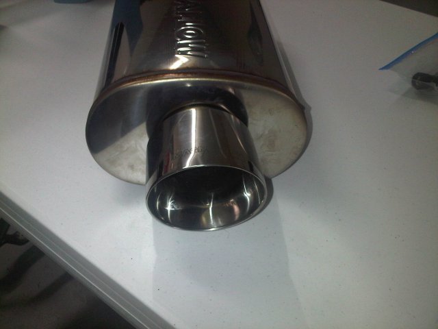

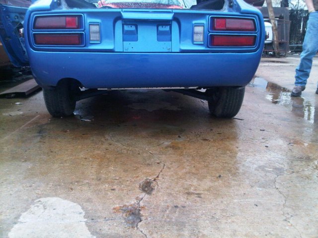

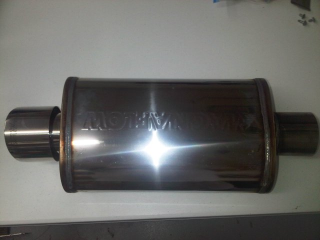

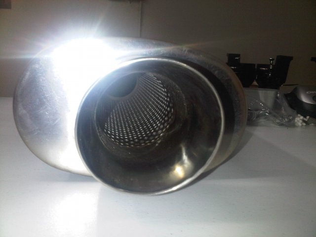

I thought the same thing about the 4" tips but when I put it up to the back of the car they looked good to me. I will post a clip of how the car sounds but I'm a long way from that. I have not even ordered the motor yet and it may be 4 to 6 months before I get my car back from the restoration shop. I just needed the mufflers in order for the restoration shop to cut the proper holes in the rear pannel of the car.

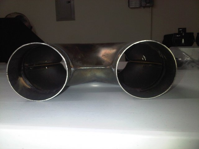

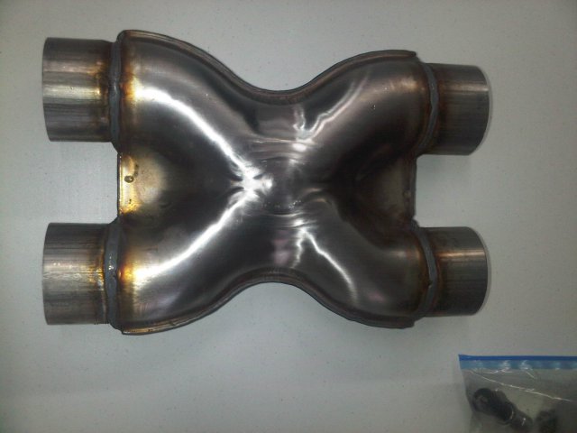

Received some more parts today. Magnaflow 3" X pipe and Race series 3" in 3" out muffler with 4" tips.

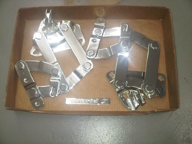

Not much progress but at least I got the hinges back from plating. Drove by restoration shop and they began stripping the body down. Ordered Magnaflow 3" X pipe and 3" polished race series mufflers with 4" tips.
Thank you, I'm picking up the hood hinges Saturday and will post those pictures. Those guys do good work, I just wish they were not so expensive.

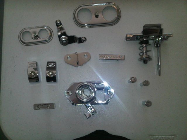

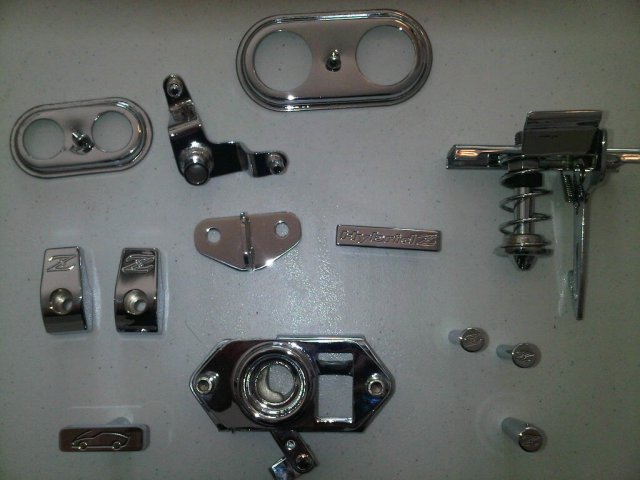

Not much progress but got the ZTEK parts back from chrome plating along with some other parts. Still waiting on the hood hinges.

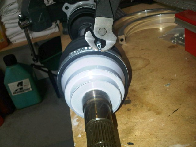

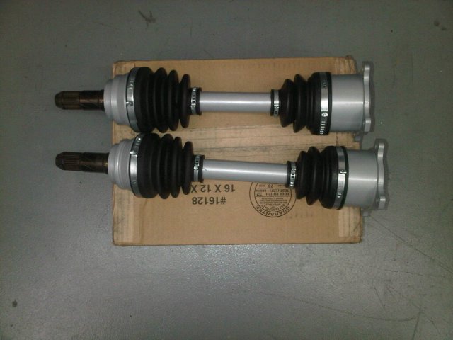

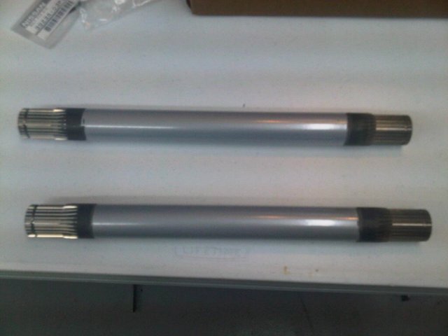

Well after some research I decided to get the M2 shortened axles. I have read about too many axles being a tight fit. I figured I have way too much money invested in the differential to take any chances. Ordered new boot kits since a friend came over to help me disassemble the axles and cut all the boots in half to take them off. Pretty cool of him especially since the boots he cut were new. Needless to say he was relieved of his helping duties immediately. Received M2 axles and send them out to be powder coated to match the rest of the drive train. Got axles back from powder coating and assembled them, this time with no help from any friends.....LOL

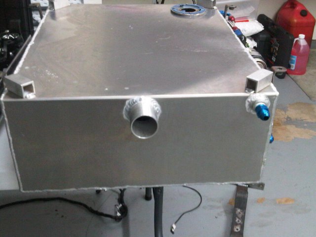

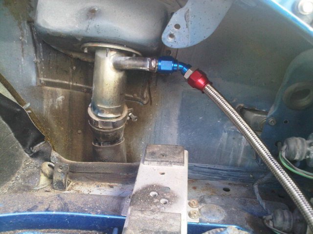

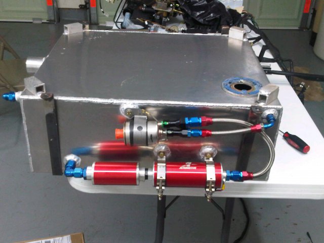

Today I took the car from the fab shop to the body shop. I removed the fuel sending unit and sent it in to be rebuilt. I have attached pictures of the tank on the car and out as requested. As you can see the tank design is simple but does all I need it to.
Do you have a video or pics of how your other LED lights look? Did you have to go to a digital flasher due to the low load of the LED's? Awesome looking tail lights.
I just spoke with John Harrison at the fab shop and he said he can make another tank just like mine for around $400 as long as you are not using the factory fuel sending unit. It cost me more since I wanted to use the factory sending unit therefore they had to cut the top section of my original tank where the sending unit mounts to and integrate it to this tank. He can do that if you wish you would just have to send him that section of your original tank. I'm picking up the car this weekend to take it to the body/restoration shop and I will remove the fuel tank before I drop the car off at the body shop. I need to remove the sending unit and send it in to be rebuilt. I can take pictures of the tank out of the car and post it if you would like.
