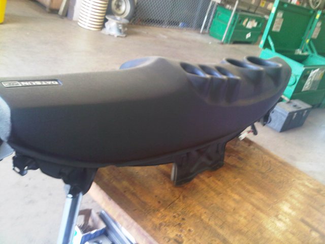

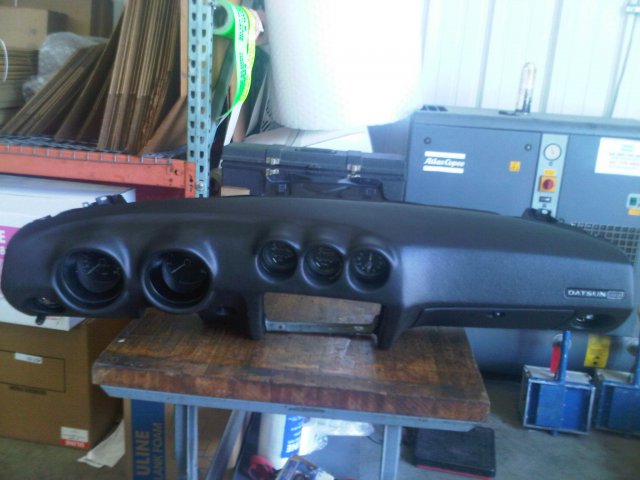

Finally after 7 months of waiting I got my dash back. I'm very happy with the finished product. Now it's time to send the gauges to be restored, painted with white faces and chromed vessels. Hopefully that does not take as long as the dash.

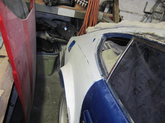

Thank you, The flares are fiberglass, I bought those about 20 years ago from Jim Cook Racing. I agree with you, they add attitude but not overkill like some others I have seen.

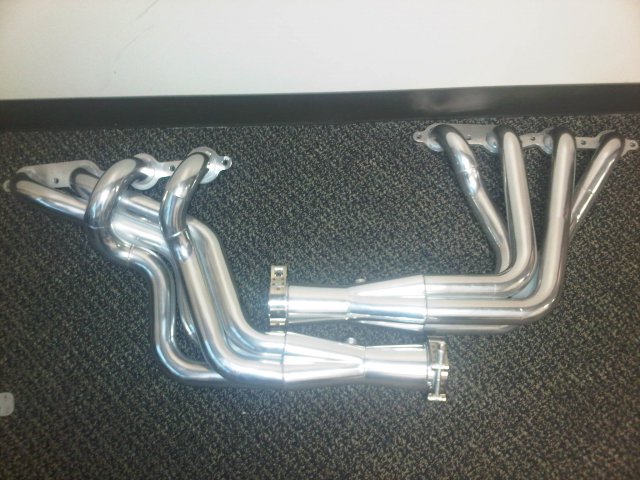

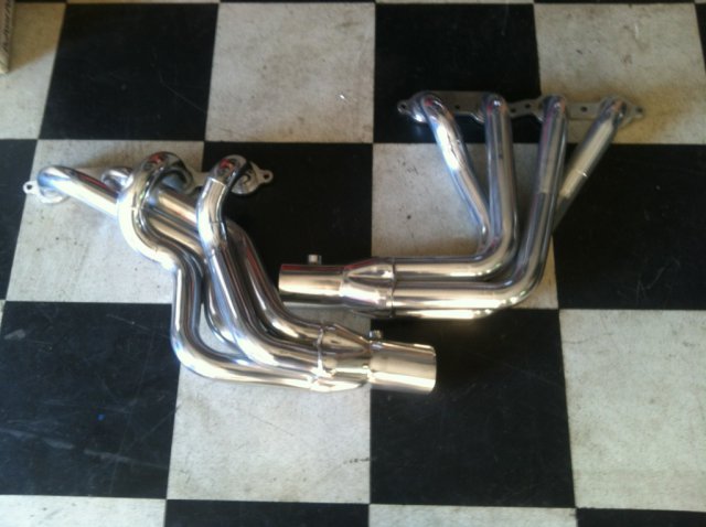

I had someone near Springfield yesterday and had them stop at 417 Motorsports to see if they could get my headers. Turns out there is only one technician working there and he says he knows nothing about our headers and to contact Blake on his mobile. I then called Blake a couple of times and no answer as usual. I was frustated and txt him stating that I had a guy stop by there and he was not able to get any answers as to what is going on and if I drive from TX to MO I expect not only answers but either the headers or my money back. I also mentioned to him that I called FED-EX and no call tag was issued from his shop address and that I was tired of being feed BS, also that we need to get this sorted before things get out of hand. He txt me back right away apologizing for lying but according to him the truth is that the merge collectors have been on back order and they just came in Friday. He says he was just trying to buy some time by telling me they were ready to ship. He mentioned that 78 LS2 Z has received his already and sent me a picture of RebekahsZ headers that are going out this week. (attached picture) He claims I should have mine by the end of the week as well. I really wish things did not have to get to this point but when you call a business or it's owner for several weeks and get no reply you start to think the worst especially when the stories you have been told about your parts are not true. It looks like only 2 of us are missing our headers now. We will see how things go. -

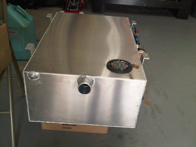

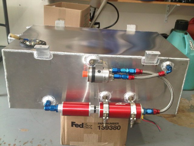

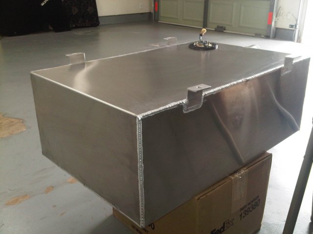

Well after taking some measurements and giving it more thought I decided to re-do the fuel tank. The first tank did not allow much room in between the differential and fuel pump/fuel filter assembly. Making difficult for maintenance. It also was too shallow for the factory fuel sending untit as the unit would not reach it's intended travel therefore it would not give accurate fuel level readings. This tank is now 28X18X10 and about 21.8 gallons and still allow enough room for dual exhaust. It will hang down 2 inches more than the other one but I'm OK with that.

Well I finally spoke with Blake last friday. He says he has been trying to reach the 4 us that have not received our headers. Funny my phone never rang. I call BS on that one. Anyways he claims he issued a FED-EX call tag that monday and he is waiting for them to pick up the headers. I know FED-EX picks up call tags daily or at the very least the next day. It has been almost 2 weeks since the so called call tag was issued and guess what? Of course no headers. I'm planning to make a trip to Blake's shop towards the end of the month if the headers have not arrived which I'm sure they won’t. This is a major inconvenience for me since they are in MO and I'm in TX about 11 hour drive. For those of you that are still waiting for your headers, if you want me to pick them up for you and ship them to you I would need authorization to do so in writing. -

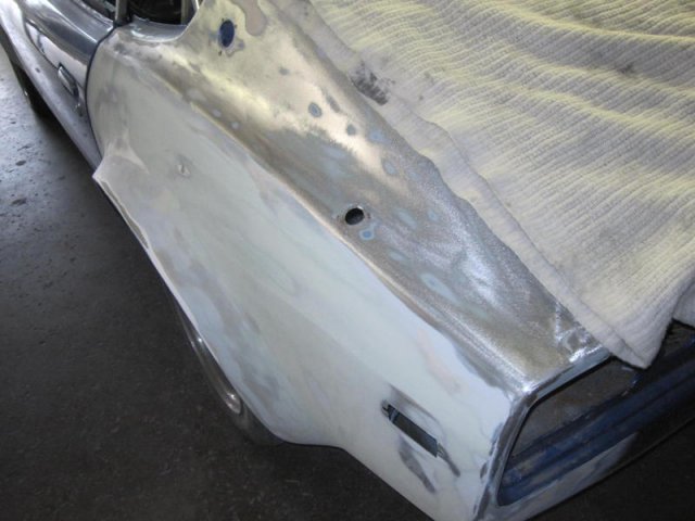

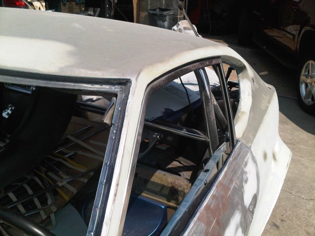

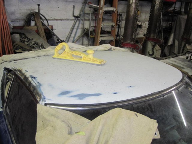

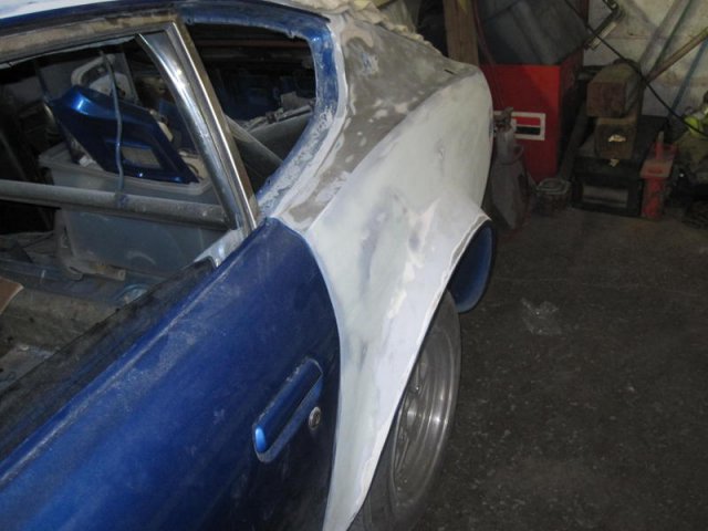

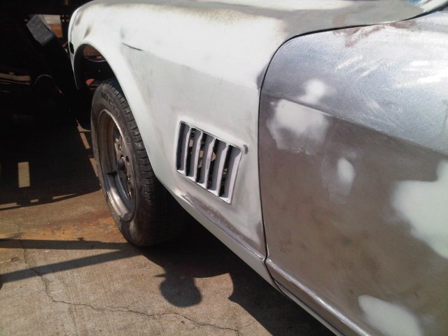

I can see why Nissan bailed out on the restoration. To do it right it cost a lot of money. Here are some more pics of the roof without the drip rails and the fender louvers re-shapped.

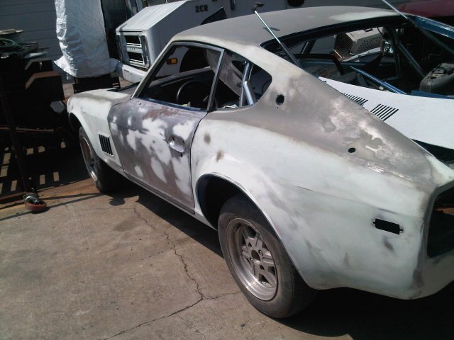

Just got some pictures from the body shop. They have completed re-working the rear flares and removed the drip rails from the roof. That should give the car a good slick look. They found some unexpected rust behind the headlight vessels and one fender. They are taking the car down to bare metal one panel at a time and working it as they go. I wanted to make sure there was no rust behind old filler that could surprise me later. Ordered a complete weatherstripping kit from vintage rubber, dammm they are expensive. It looks like we are heading the right direction, slower than I would like but at least it's being done right. 157 labor hours and we are a long way from paint....ooooouuuuch.... Who said restoration work was cheap?

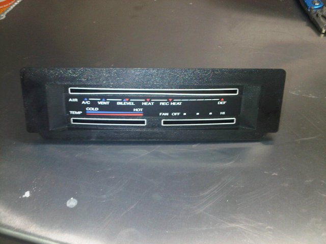

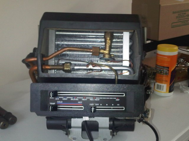

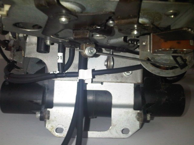

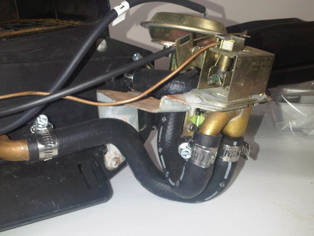

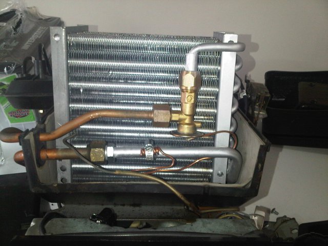

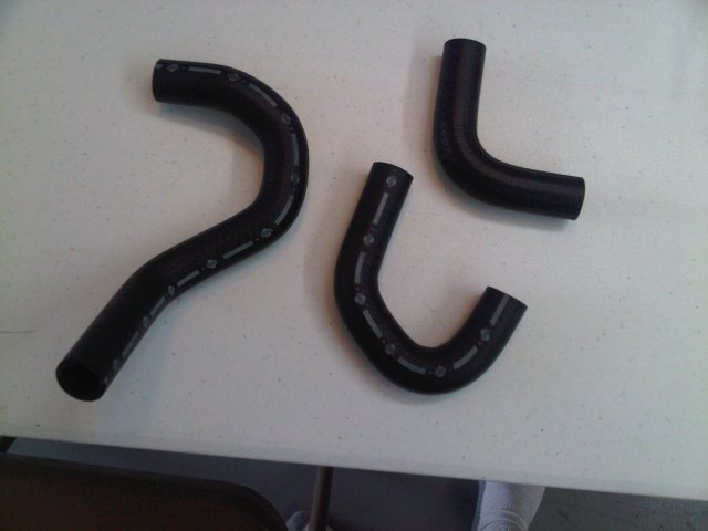

I finally got some parts in that I have been waiting for a long time. The heater core hoses, A/C control face plate and knobs were ordered from Japan and are original Nissan parts. Nothing fits better that's for sure but hang on to you wallet. I also received a new evaporator with expansion valve from a different source. I replaced all the vacumm lines for the A/C system and fitted the evaporator in place. Now it's waiting time again.
