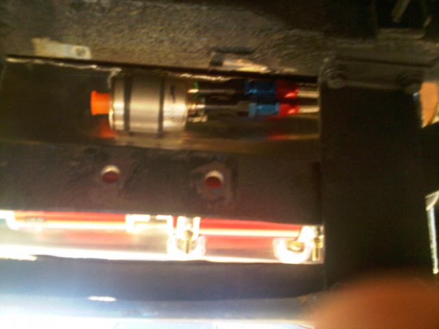

Thanks, they did a good job, I was surprised when I saw it. Yes the tank is internally baffled and it's 24X20X8.

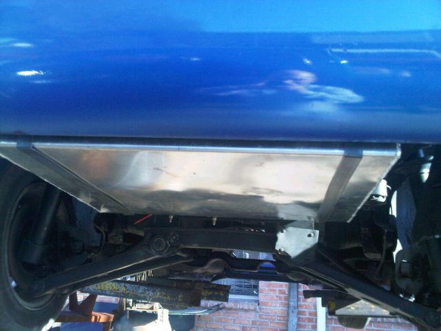

Just came back from the fab shop. They have installed the bad dog frame rails. They have also completed the fuel tank and also notched the front differential mount for dual exhaust. Tank is 17.5 gallons (more than I expected and it does not hang down much past the rear valance. Still have to remove the tank to send the stock fuel sending unit to be rebuilt. It seems nobody makes those anymore and I want to keep my stock gauges. also would like to have the straps that hold the tank in place powder coated or chromed, I have not decided yet.

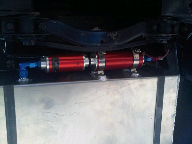

Why is it necessary to ground the fuel filter?
alainburon replied to RebekahsZ's topic in Gen III & IV Chevy V8Z Tech Board
What type of fitting did you use for the outlet of the fuel filter to be able to connect to the elbbow shown in the picture? And where did you get it? My set up is very similar to yours and I have been looking for a fitting like that. -

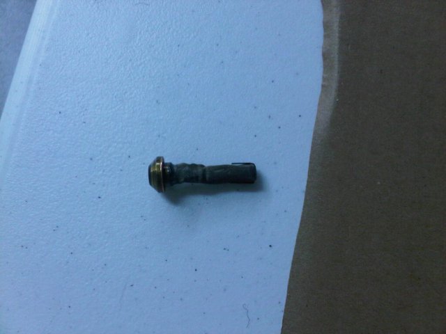

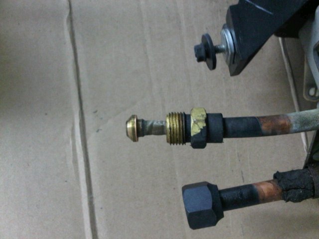

Thanks for the info. I spoke with the A/C company that I'm buying the evaporator from and they claim I don't need that filter since the evaporator they are selling me comes with an expasion valve and it has it's own built in filter. I will try a local pick a part and see if I can find it. I hate to leave it out and ruin a new compressor, evaporator and condensor. If I can't find one I may try your advice and try to straighten it out from the inside. It's not that badly damaged. Thanks for the help.
I tried a local Nissan dealer already and I may as well have gone to Taco Bell to ask for this part. They dont know a thing about these cars but if you have an Altima you are good to go. I will try Motorsport or a local A/C shop as you suggested. Thanks for the input.
I'm replacing my Evaporator as part of the restoration I'm doing on the car. Found a new evaporator with an expansion valve included. On the small line coming from the evaporator there is some sort of screen looking filter at the point where the hose from the A/C dryer connects to the firewall. I accidentally crushed the screen during the removal of the evaporator and can't find a replacement. What is the purpose of this screen and can it be removed? I have attached some pictures of it.

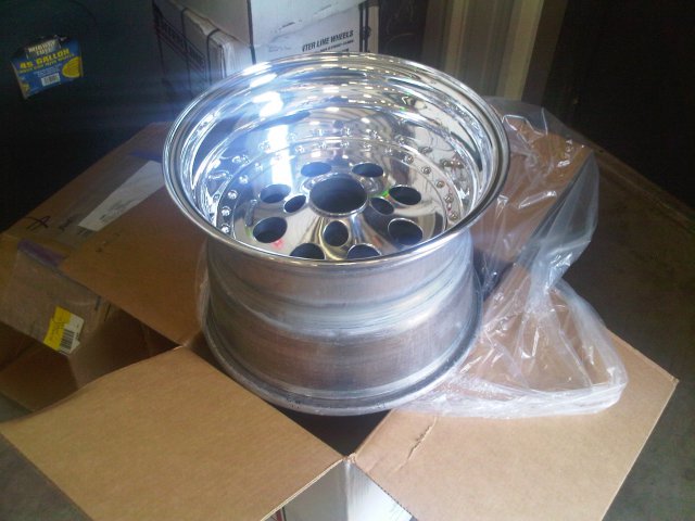

Not much progress so far except I received my wheels back from Centerline. They did an excellent job in polishing the wheels back to a like new finish.
