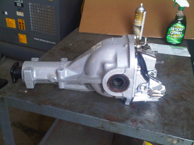

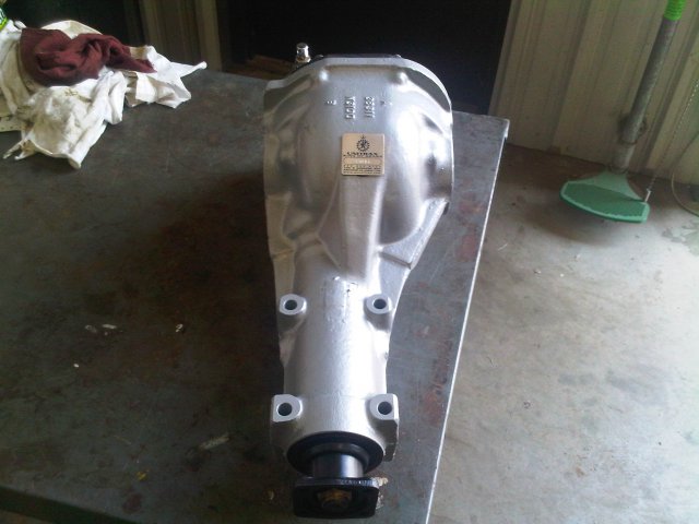

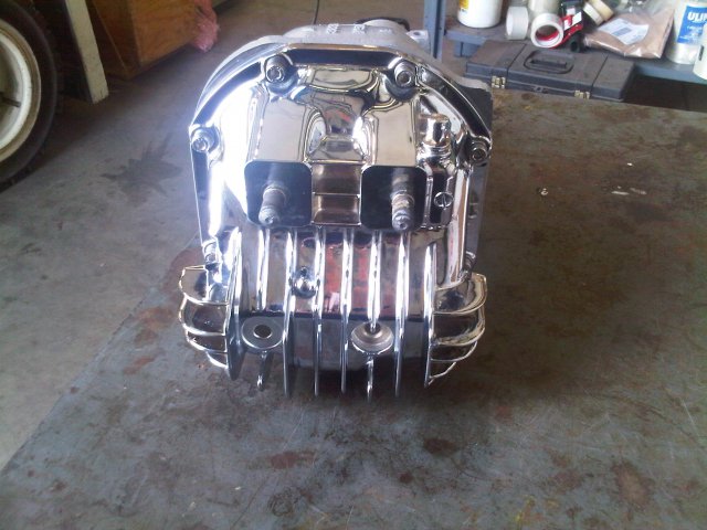

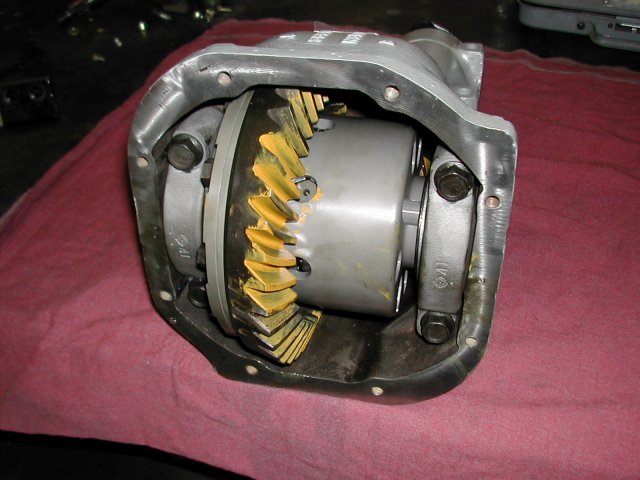

Update, Today I received the R200 back from John at Betamotorsports and I have to say I'm very pleased with his customer service and workmanship. The R200 was completely rebuilt with new bearings, seals and a OS Giken Super Lock LSD unit was installed. The case was powder coated to match the T56 transmission, driveshaft and CV axles. Still waiting on a opening at the fab shop for the frame rail and fuel tank work not to mention a reply from Ross at MM.

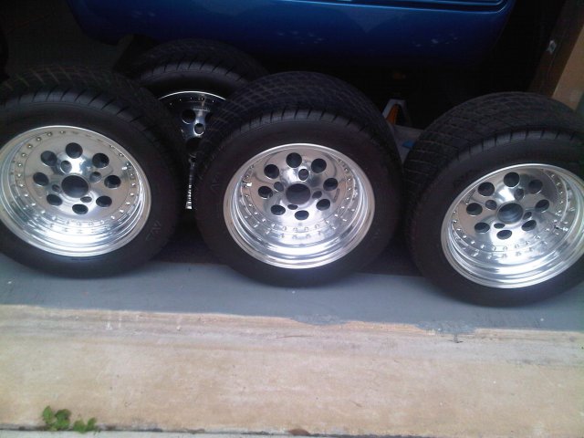

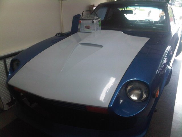

I just removed the wheels to send back to Centerline to be repolished. Waiting for my rear tires, I bought 4 just in case they stop making them. Had to order them from England since that size (285/40/15) is no longer available in the US but it is still being offered in Europe. Yokahama is making these tires in very small numbers for the European market only. Got my hood and pre-fitted it. Needs some work to get it right plus I need to open the front scoop. Hopefully that will force some heat out of the engine bay.

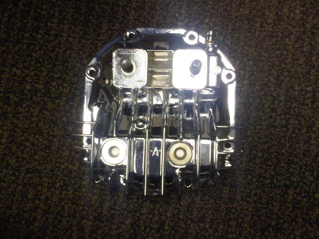

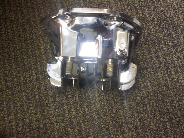

Thanks for the compliment. I sent it out to be chromed at a local shop.
Update: The S30 engine and transmission are both out and sold. I received the Chromed R200 cover along with a new OEM diff. mount. Axles and drive shaft have been taken apart and dropped off at the powder coaters. Still waiting for a opening at the fab shop that's going to install the frame rails and build the new fuel tank. Still waiting for Modern Motorsport to answer my email from a month ago. Anyone know how to get a hold of Ross?

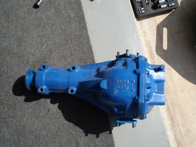

Update I removed the fuel tank and the 4.10 R200 (pictures attached) which I will be sending to John at Betamotorsport. He was kind enough to find me a 3.36 R200 to swap with. He will be installing the OGS Super Lock LSD on the 3.36 unit for me, powder coating the case and installing a chrome plated finned differential cover. I will post pictures of the unit once I receive it from John. I just received a set of 89 300ZX turbo axles yesterday. I will take them appart this weekend and send them to be powder coated to match the differential. One of these days when I hear back from Ross at modern motorsports I will be able to order the billet stub axles and adaptors.

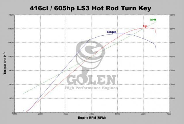

Thanks Cable, I was sure I needed to go with the billet stub axles and companion flanges to be safe. I will look into the OBX LSD as well. You are correct sir this is a stroked LS3 416 CID I'm having built by Golen Engines, no turbo or supercharger I like naturaly aspirated. I have attached the Dyno sheet for your viewing pleasure. It is going to be mated to a tick-performance built T56 that can handle 700ft/lb of torque and a Textralia clutch/flywheel combo. The reason for the high horsepower motor for the street is just to have an S30 that is street legal and is capable of ripping most street cars that pull up next to it, if I can get traction. I gave up drag racing too many years ago, it becomes very expensive and it takes a lot of time going back and forth to the track. I just rather play on the street and go to car shows, car meets and cruises. Thanks again for the information. There is nothing cheap about this build and I don't want to cut corners to save a buck. -
