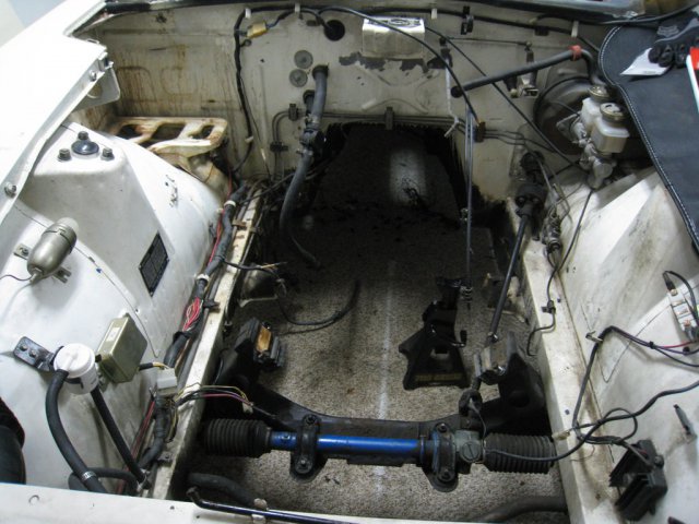

Engine bay is almost stripped down, Started the fuel and brake line removal last night, it got too dark and I couldn't fit myself full in the transmission tunnel to real the rest of the screws. So most of the lines are loose. Everything is coming together and fast for stripping the paint and fixing a little body work before priming. -

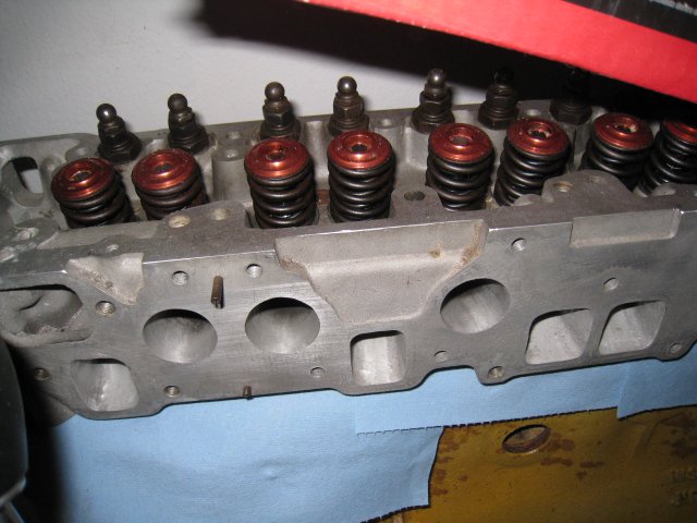

I didn't know that I could use them is more what I was confused about since in a lot of videos I've been watching all the L series I've bee seeing had Flat tops, so I was concerned since this is a turbo block with dished pistons. I know the rings are bad on the pistons, so they have to come out and the block honed. So what i was going to do was get flat top pistons and, even though I haven't decided yet if I should do the honing or take it to a machine shop and have them do the honing and perhaps boring it out. But since I really just want to drive my car, I was going to use the dished pistons and just get new rings and hone the block myself if thats what needs to be done. I've never done any motor work before, so thats what my dilemma is on deciding if Im capable of doing it. I have every book available and the FSM, and Hybridz, but its still questionable since I don't want blow the thing when I finally run her.
Alright, well it looks like I'll just have the block rebuilt with the dished pistons it currently has. The rings need to be replaced anyways. And then I'll just use my n42 head for now since I want to drive my car after I'm done painting her. I'll book mark those links to keep in mind when I want to finally do a high compression build.
Ok, yeah I've been getting a lot of opinions, and ofcourse everyone has their own opinions, but ofcourse I was told about the flat tops with a n42/n47 head on a f54 block. Well my block i just purchased has dished pistons in it since its from a zxt. I guess I should stay with those then when I do the rebuild? I'll go ahead and read those threads too. Since I'm trying to keep to a low budget since my wife and I bought a house and spent all my money's, it's be better this way and I can get away with at least getting my triples that I just love the look of.

Hey guys, I've been searching on here for a few hours now and can't seem to find a few answers to my questions. I just picked up a 83Xt block and it needs to be rebuilt. I don't have much to spend, but from I hear I can do a high compression motor fairly cheap. 1. Do I need to get flat tops since I'm running it n/a? 2. I heard you can use L24 rods for higher compression or is the stock rods that it has now will work? Any other help/insight will be appreciated. I have pics of the items I have on my build thread. Here http://forums.hybridz.org/index.php/topic/101191-1970-240z-project-very-slow-money-is-tight/page__pid__973113__st__40#entry973113

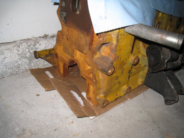

Well today I took advantage of a nice day today, took out the windows, the wiring harness, pedals, and windshield. Also off the left overs in the engine bay, everything is almost taken off so i can start stripping the paint off of the car. Today I also went and picked up another short block an L28 F54 block with the full rotating assembly, pulley, timing chain, and gear, water pump, and even though it had a turbo oil pan, i was given a n/a oil pan with it. All of it for 100 bucks, pretty good deal I think! I had purchased an f54 block for 40 bucks awhile back and I picked it up at a machine shop that a friend had stored their. The block was cleaned 3 years ago, and was stored outside. The block is rusty everywhere, and I was told it would be a good working block, as long as I put some work into it. I didn't really trust it, so I was looking for another block this whole time. Now that I have that and my N42 head I picked up from Gollum on here, im going to have an awesome motor at some point. Im going to get the motor back up to stock form to just run the car when she's done, but after that I can do my 3.0L stroker set up a few years down the line. I might be able to do a cam and valves plus springs since Thats what i can afford piece by piece. Anyways here's some pics I took of the car tonight and of the Yellow rusty 40 dollar F54 block, and the, 100 dollar entire short block. More things to come!!! -

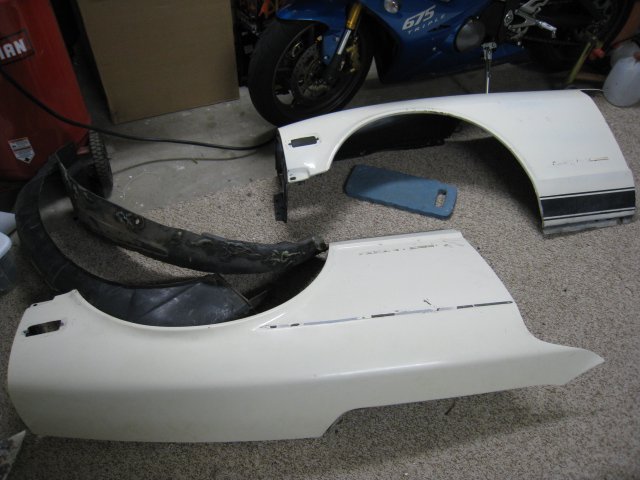

Well today was finally a warm sunny day, its been too cold to work on the car in the garage, I know that some of you out there are in colder parts of the US, but it has been a lot colder here this year then previously. Well I decided to take advantage and start stripping the paint from the loose panels on the car. I got 3 pieces completely done, the rest are just waiting. Now that Im finished with my vin verification I have more options available to me. The whole mess with the vin verification was when the previous owner took the car to get it verified since the car was from new mexico, anyways when he took the car in, the dmv looked under the hood and saw a emissions sticker for the L28 from where the hood came from. What I've put together, since the car was in an accident, one of the previous owners switched out the hood probably from a 280z. I also took a short video tonight, here's the link. If anyone has ideas let me know. Im planning on trying to make some carbon fiber pieces for the car(Hood, blinker, and maybe once I get good at it the fenders) who knows maybe i'll start selling the pieces if anyone wants some maybe I'll be able to do that for you guys. I'll make a thread about it when I start doing it, next week I hope to order all the stuff to start making some fiber glass moldings of some small stuff I have laying around. Pictures will be uploaded tomorrow, here's the video from today. -

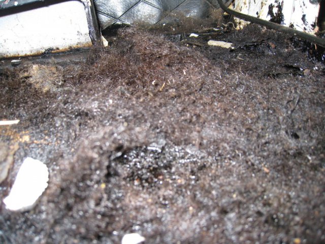

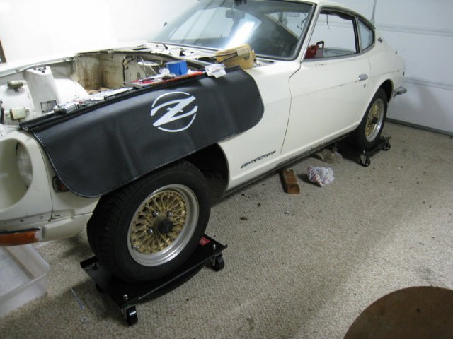

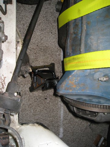

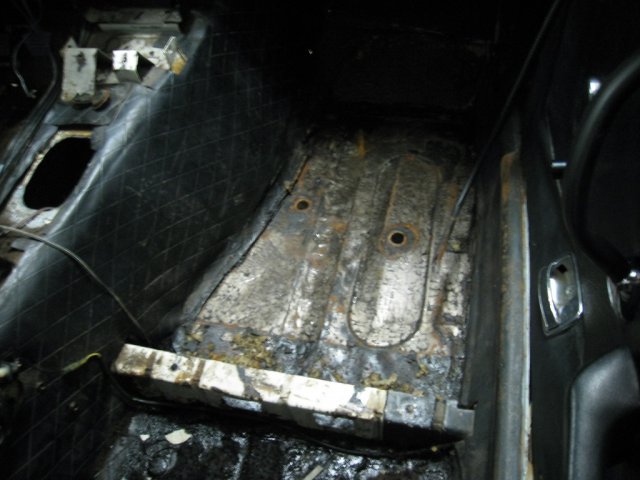

Well it's been about a week since I posted something. Last friday I went out and bought my new(ish) 1983zx close ratio transmission. As soon as I got home I went to pulling the motor out, It took only a few minutes since I've been preparing to pull the motor out. After I pulled the motor I put my car on rollers to roll the Z around the garage. I have carpet in my garage so it doesn't roll around as easy, but It won't just roll if I bump into it so its a blessing in disguise. I Started chipping away at the passenger side floor to get that old deadener off. found a nice crack in the floor behind where the seat goes. Also whoever had this car before me in NM thought it was a cool idea to get self tapping screws and drill them through the floor to hold down this little thin carpet holder so water did get to the metal. But for what it was its only going to need some sanding to get that rust off and then add some POR-15, or maybe I'll paint first then add the POR-15...I don't know which. I'll tackle the floor under the passenger seat sometime this weekend, Its really oily for some odd reason and the old soft cushy fiber is on it like really tall mold lol. Found a really cool place in Livermore that sells 2 twill carbon fiber for 35 bucks a yard. Im planning on making a carbon fiber hood just for fun to see how it looks and to get some weight off the car. It wont be permanent but it will look interesting or ricey lol. I might be coming on a cool new steering wheel soon, just waiting on if its going to work out or not. Pics to come if it does. Anyways its dinner time, so here's the pics I took tonight. I'll be putting a pic of an idea what I might want to paint the car. It'll be the bright orange from a 911 gt3 rs with the lettering of 240z in black on the bottom of the doors. Let me know what you guys think! -

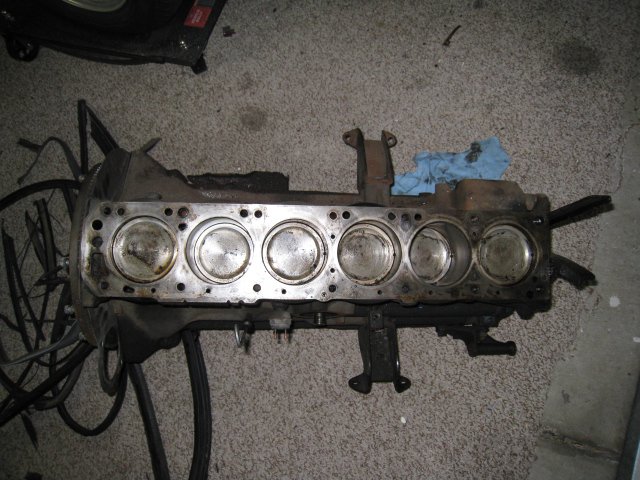

It was at tdc. It would hold only 40psi not 100psi like I thought it was supposed to.. Unless it can't? -

Btw if anyone knows the answer to this I'd like some feedback, while doing the leakdown to the motor, we couldn't get the motor to hold 100psi because the pressure would press the pistons down and the crank would turn. I'm confused on how guys did there leakdown with 100psi on there test? The transmission is not bolted to the block since I'm getting a new transmission and took the broken one off. Could that be the reason? I assume people put motors on the stands and do leakdown testing as well. Help?
