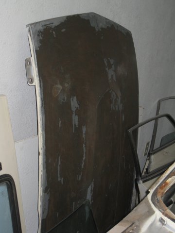

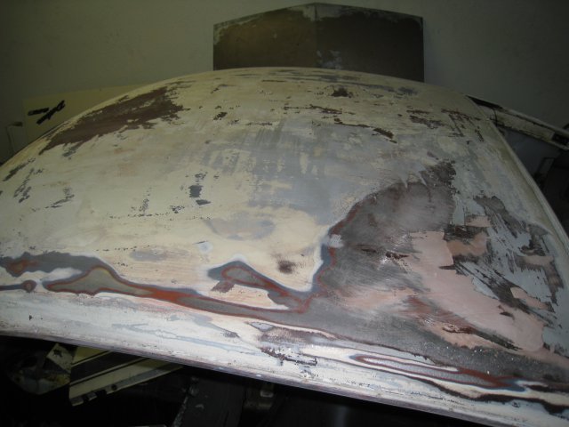

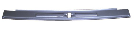

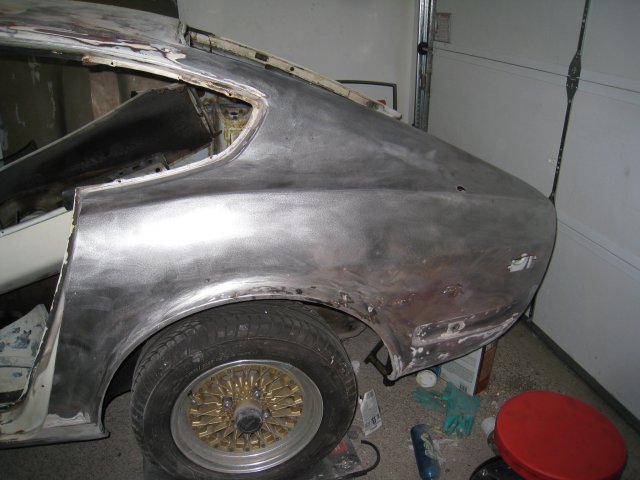

Well It's been awhile since I've posted, still working on the Z ofcourse. I've been sanding the body and using aircraft stripper to get the first layer of paint and clear coat+body filler off. Then I've been sanding with my air compressor sander 80 grit, 120 grit, and 240 grit. The back driver side is basically all sanded down to metal, I didn't want to use a wire wheel because it makes really deep scratches in the metal. Now im on to the roof of the car and I must say air craft stripper really burns > I did also get most of the hood finished, if I can make some room in my garage I will also tackle trying to make the Carbon Fiber hood I've been planning on making. Since I was able to leave early from work today I tackled removing the hatch sill plate since I know it was covered in body filler/silicon and paint. Instead of just cutting it off like most people. Instead I drilled out the spot welds and pride it off. It did take awhile but Im happy with the result, I do however have to cut off some small pieces, but I will be ordering my new hatch sill from Z car source. It's about 134 bucks, but I know that It will fit and I don't have to do really any modifications. Heres what the hatch plate looks like after I pulled it off. To keep myself busy I bought a valve compressor to take apart my heads, really wanted one so I can get the work done on the head and valves and put them back on myself, I bought this on amazon for about 42 bucks, I added some duct tape and bubble wrap on the valve end so it won't scratch the valves . I've been in a search for an E31 head and have found a few people willing to sell for a good price. I was trying to find a head that was in running condition to just bolt on and run but the one I found which is a member on here was supposed to send me a vid and never got back to me. I was ready with cash in hand, I hope he reads this and send me my vid If not I'll be purchasing from another member. I also have been playing around with the idea of making a high compression L28 on the side with a MN47 head since I found a gas station near by that sells 94 and 100 octane. Might make for a fun ride I'll make a video tomorrow when Im not so tired. -
