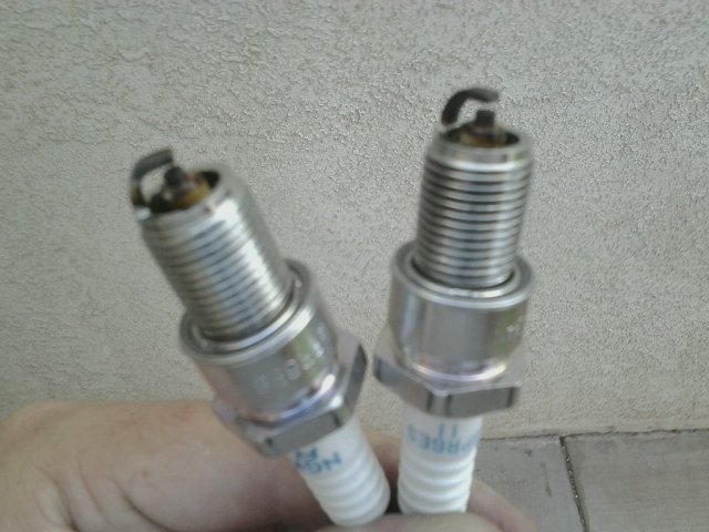

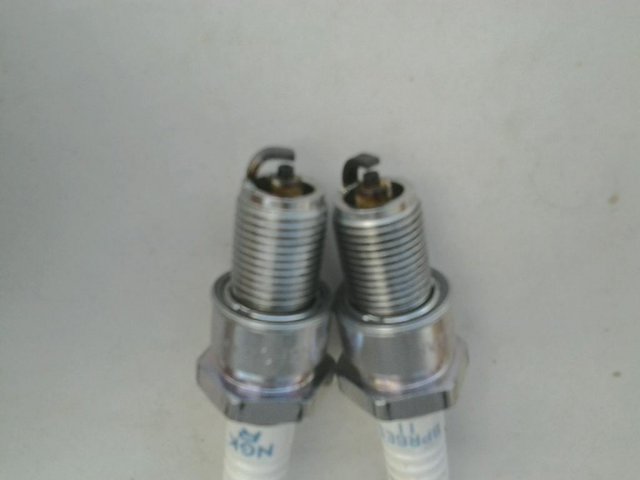

	I have an 83 L28ET with Z31 ECU in a 77. These plugs are new, 0 miles, just idleing. Gapped at .42. My timing is at 25 BTDC with TPS plugged in. They have a yellowish varnish (fuel?) The car starts fine and runs good for about 30 seconds then starts stumbling badly. It also gets hot really quick. Is this caused by my timing being too advanced? Stock for the 83 I thought was 24 +/-3. Should I be setting timing for the Z31 ECU? I have a new set of NGKs gapped to .39 to use. Thank you

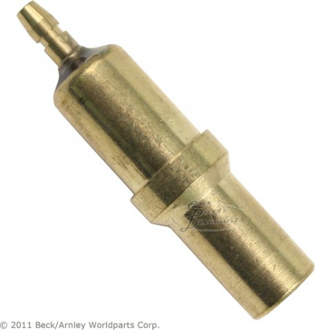

	I went to install my Speedhut coolant temp gauge which needs to use the supplied Speedhut temp sensor. I removed the stock sendng sensor for the stock gauge and now my car runs terrible and sounds like it wants to die. My question is does this sensor pictured send any info to the ECU? I thought it was just for the gauge. I have the CHTS in place, the only thing I changed was removing this. Those of you with a Speedhut or aftermarket coolant gauges how did you do the sensor with the stock system? Mine is an 83 L28ET with Z31 ECU.
