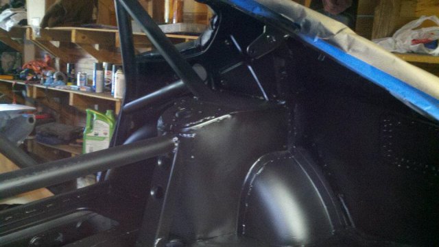

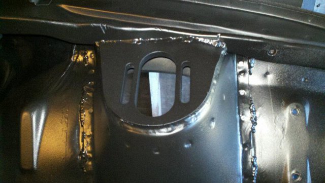

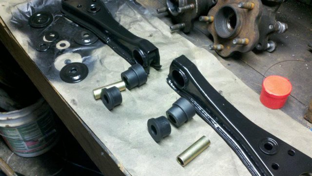

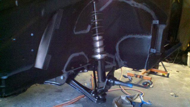

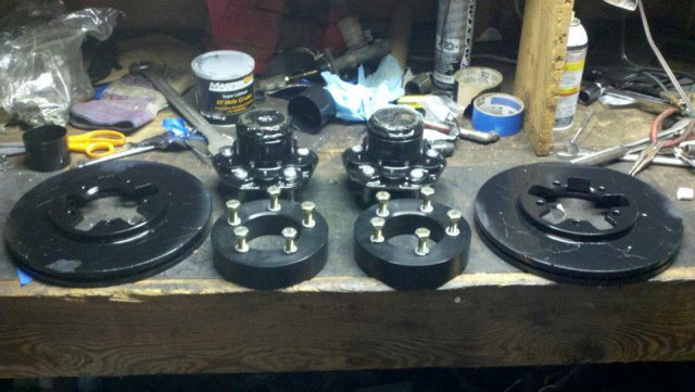

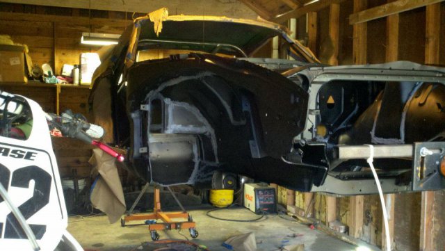

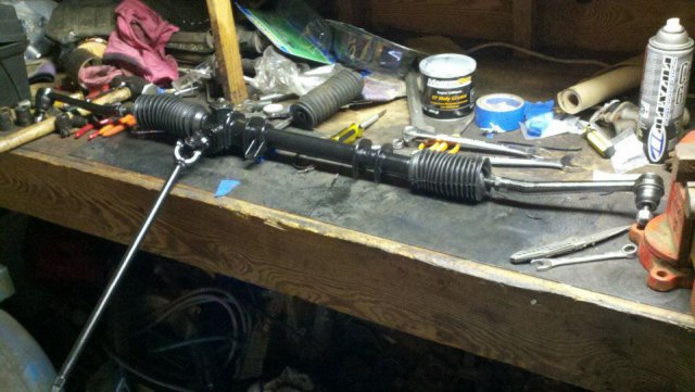

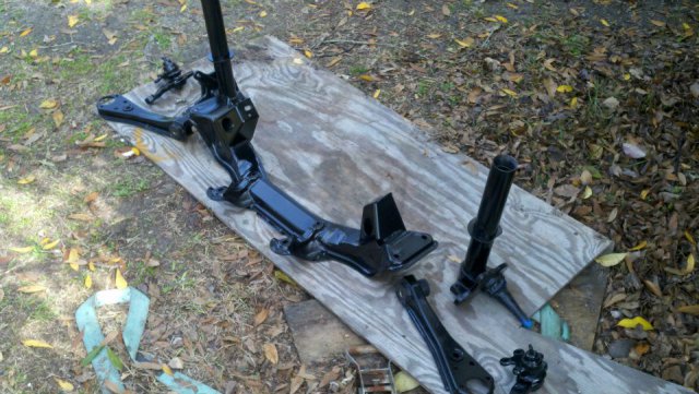

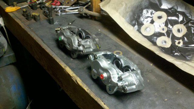

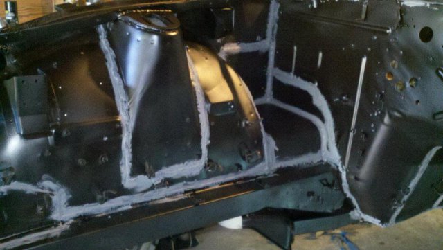

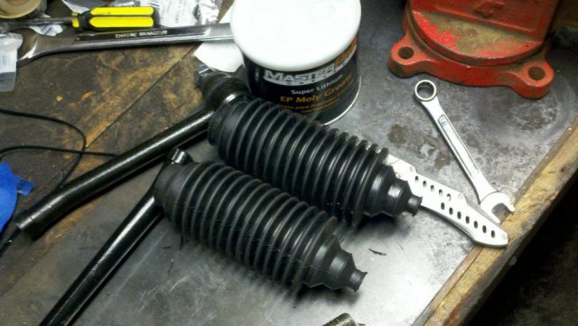

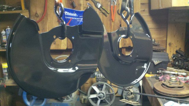

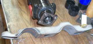

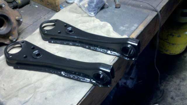

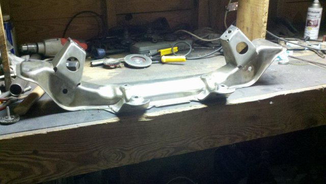

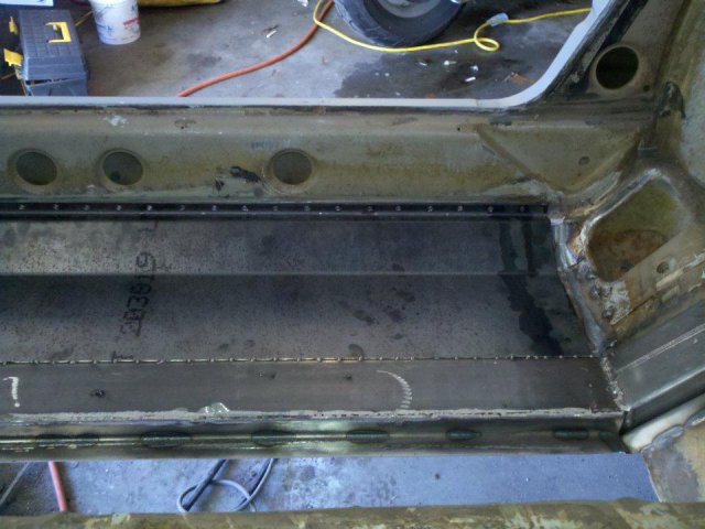

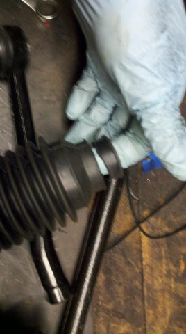

Update, Some old floor pans pics... Repainted and seam sealed... Suspension Stuff, stripped, painted and installed...I did relocate the LCA pivot point up by about 3/4" I think and slotted the engine mount holes in the crossmember. All suspension components have hyperflex energy bushings installed as well. And now the brake stuff...Typical 4x4 S12W vented rotors with z31 hubs up front and Q45 hubs in the back. Honda odysee Studs up front and ARP studs in the rear. (can give part numbers if needed) The front z31 hubs have the same inner and outer bearings as the s30 but they do use the dust seal from the z31 hub. Just slap the hub up there and run it on the spindle with the nut, dont bother trying to "hand" fit the hub to the spindle as it will take more effort. I will be running a 1" wilwood master cylinder with a rear proportioning valve. I'm changing all my lines over to 3/8-24 threads as its easier to connect to the wilwood stuff instead of having a monstrosity of metric adapters. Also rebuilt the Steering rack with some speedi boots from advanced auto parts. They are universal botos and have to be cut to fit but they work great. I used generalpurpose lithium grease on all the rack componets. Question about the cage though. My welds dont encompass the entire tube at the mounting plate ebcause of the angle required. It's REALLY hard to get a MIG torch head in there. Im considering getting it TIG'd in that location before I paint it. Could I leave it alone and spray some paint on it or should I be worried about the weld not going all the way around the tube? The joints on the cage were all Tig welded except for the mounting plates to the car and the bar to the plate joints. Any help would be appreciated. Comments are welcome!

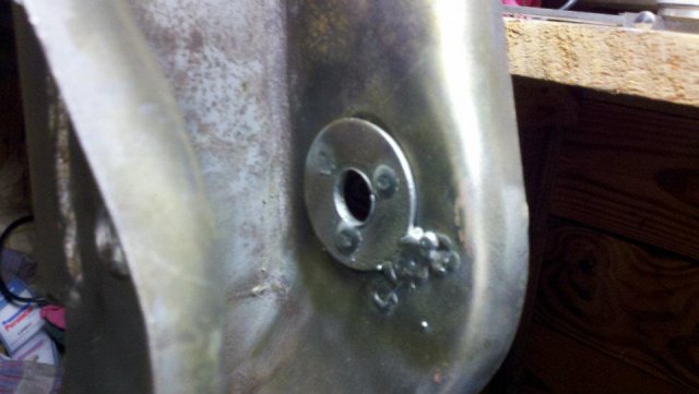

http://forums.hybridz.org/index.php/topic/65455-fuel-cell-fuel-plumbing-install-w-pics/page__p__613247__hl__%2Bfuel+%2Bcell+%2Bplumbing__fromsearch__1?do=findComment&comment=613247 I copied his design and used a 15gal cell so my dimensions are a little different. I REALLY need to upload some pics to reflect the status of my current build. I haven't updated anything on here in a LONG while. The only thing I changed was I welded my nuts inside the 1x1 down legs instead of doing like he did and have the bolts welded in them with threads sticking out the bottom. My bolts run up into the down leg itself and all you see when its all bolted up are the bolt heads. I also ran a thicker sheet to cover everything up with too. He used 22ga I believe whereas I used 20ga. This is the best fuel cell design I've run across which is why I copied it. There's alot to consider when doing this though. Everything he did was well thought out. The support bars running horizontally prevent any excessive frame damage should a rear end incident occur. I'll update my old thread sometime soon and post it here if I can remember.

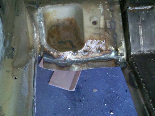

In all honesty if thats a "BAD" spot to you, then you should really consider looking at some of the rust repair threads on here. No doubt you will find more areas like this but I'd be ECSTATIC if that spot or a few like those above was all I had to deal with. I had feet sized holes in my floors, battery tray completly rusted through, firewall rust, trunk hatch area rust, rear-end damage from previous collision and so on. To repair that section you could buy a sheet of 22ga steel and cut out a small piece and weld it on after you cut out the rusted area. clean it up with an 80 grit flap disc and wire wheel after your done and it will look like new. Lurk around in the metal fabrication area for a while and you'll get a good idea of what has been done to repair these cars and what the typical problem areas are.

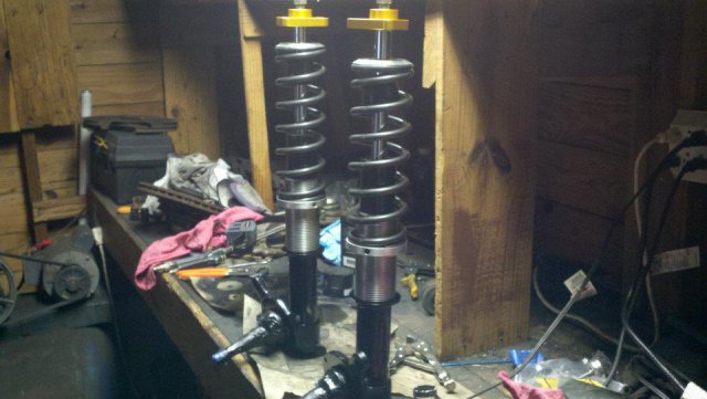

I pieced together my own kit. I just dont like to buy something in a kit just because all the leg work has been done before by someone else and they are selling a "kit" to ease the install. All of these parts can be bought for cheaper off of racing websites and they are all made out of the same material. You have a much higher freedom of choices with piecing together something on your own such as choosing spring lengths/rates, sleeve lengths and anodizing color, and the best part is its CHEAPER! I have about 450.00 in my setup because I bought second hand struts, springs, and sleeves with brand new top hats and camber plates from techno toy tuning. The GC "kit" only includes springs, sleeves, and perches. I only have about 150.00 wrapped up in those parts. The ride and handling will be the same as anyone else with that particular spring rate setup 250/225 lbs with tokico HP struts. -

I'm almost finished with my coil-over install. I have stripped and painted all of the front suspension parts and springs. I ran into one more question and hopefully Johnc can chime in here and give some input. When I measured the length to cut out of the strut I used the old gland nut on the upper strut tube housing. The nissan glad nut is longer in depth as well as has more threads than the one Tokico provides. With the addition of a 1/8" thick washer at the bottom of the strut tube I can get the needed "crush" on the strut within the housing when the nissan gland nut is torqued down properly. The Tokico gland nut does not screw in as far and is not as long as the nissan one I used to measure. When I screw in the tokico gland nut the strut has about 3/8" of play before its seated in the top of the gland nut. The tokico gland nut has a recessed grove that fits fairly tight to the circumfrenece of the tokico strut and prevents any wobble on the top side of the strut once it is torqued down. In hindsight I could have cut off about an additional 1/4" ish of the top of the strut tube housing and taken up this extra slack If I would have used the supplied tokico gland nut to do my measure ments with. But now that the tubes are already welded and painted I've settled on simply adding a spacer at the bottom of the strut housing to take up the slack. My question is in regards to which gland nut to use. Would it be better to use the old nissan nut and my 1/8" washer I had planned on in the beggining, or would it be wise to use the tokico supplied nut with the proper grove for the strut itself and fab up a larger washer and have the assurance the strut will not wobble in the housing? The strut will sit about 3/8" higher in the housing if I built a spacer for the bottom of the strut and use the tokico nut. -
I really wouldn't worry about getting all that stuff out with a torch and scrapper. I hit the "teardown itis" bug a long long time ago too but stopped after I blasted the chassis and removed all seemingly appropriate seam sealer. The reasoning behind not wanting to remove ALL the sealer as you are doing now is that your not going to have any way to fill that area back in when your done. There will be exposed metal between the layers of crimped sheet metal that will start to rust over time no matter how much sealer you coat the top of the actual seam with. I would follow johns advice and try a different welding technique to get the desired outcome. I followed the same procedure as outlined above and my welds penetrated the seam without contamination. As far at the 1"-1" bead/gap ratio I would lean more towards the 1"-2" bead/gap ratio due to the cost of welding material and gases and amount of work for a given result. Stitch welding all the seams is alot of work as it is, no need in making it take longer or cost more than it has to. Your not going to get the chassis THAT much stiffer by adding a bead ever other inch. Lay a stich about an 1" long with a 2" gap between the stitches and that will be plenty. Trust me, your going to be systematically stitching every seam you see and when your admiring your work and thinking your done there pops up another seam that needs to be welded. Its a ton of work, adding a bead every other inch is only going to make the job last longer and cost more in the end. Let us know how it turns out!
