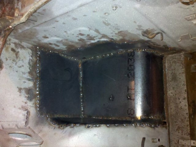

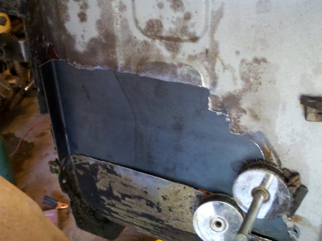

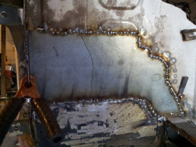

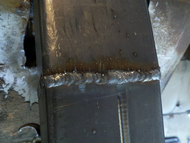

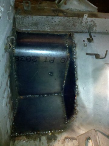

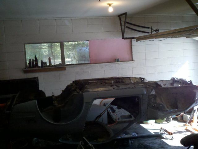

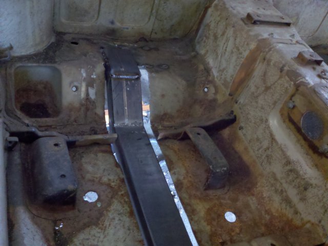

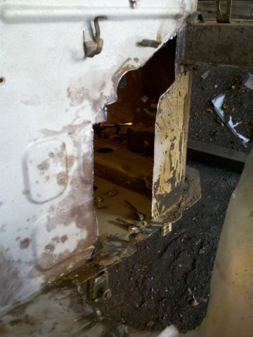

ive been busy...srry for not giving an update. pictures can do the talking better than i so here goes!
I finally got my rotisserie built...then had to chop it up again cause i didnt get everything perfectly square. fixed all the issues and she flips all the way over without the stands wanting to push towards eachother! CG is still top heavy but going out to the garage an seeing a flipped 260z on some engine stands put together in a few hours is a sight to behold!!!
