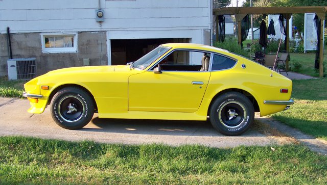

I have a 72 Datsun 240z, with a old robotic Autozone Mirror only on the drivers side. While at a car show a fat kid leaned up against my car a broke it where it wont stay in place. No biggy they arent worth anything to began with. I would like to add some fender mirrors for a different look and finding many styles and shapes with totally differeant price ranges. Can somone tell me some pros and cons of theses mirrors? How hard is the installation? Do they mount in front of the front tires or in the center? Are there any templates or exact measurments where their suppose to be? I know these are some silly question, but Iam in the process of painting my car a diff color and nows the time for me to decide if I need to weld over the holes from the old mirror. Any help with the questions and some pics would be appreciated. DatsunZman04
