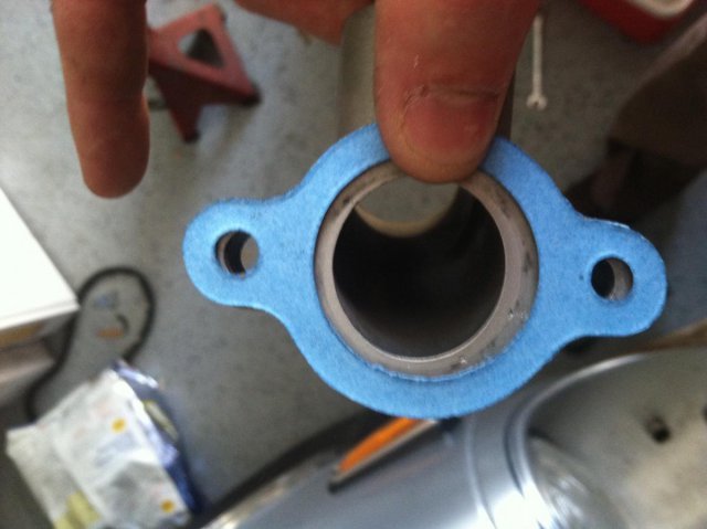

  12. I have been puzzled putting the last few pieces of my engine. To start off with my oil pickup/strainer to block gasket was not quite lining up properly either when I put it on. The spread between the bolt holes on the gasket wasn't nuts on with the pick up. It wasn't enough to cause me great concern. All other gaskets from this Fel Pro set have been fine, now the water outlet one doesn't look or fit right. I can always get some gasket sheets and cut my own, just weird/annoying.

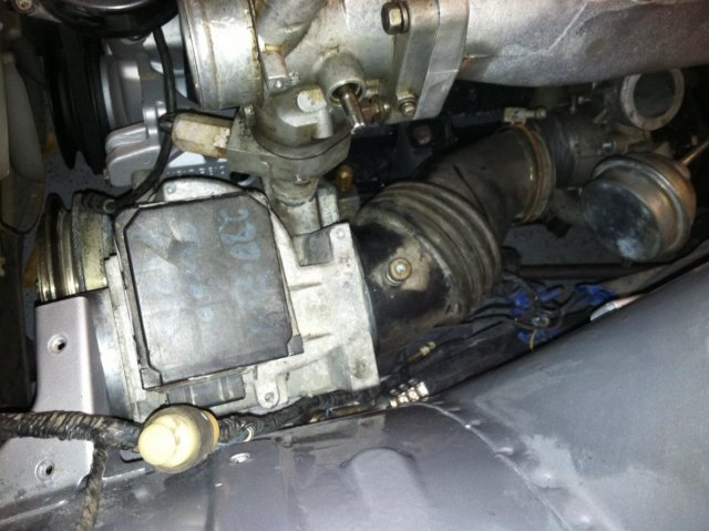

  18. I got my AFM to turbo boot working nicely. I whacked up the stock 280zx boot. I should have enough space to clear my A/C comp and a cone filter will be really close to the fan shroud, but it should all work. The rubber at the turbo was a little brittle but I trimmed it back a little bit.

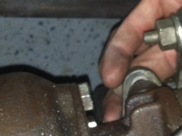

  19. Tonight I was trying to put my oil return on the bottom of the turbo, but the trouble is the tube is hitting the pan tube before I have enough clearance to bolt the tube to the turbo. Its as though I need more space between the turbo and and exhaust manifold. As of now all I have is the metal gasket between the turbo and ex. manifold, which I presume to be correct. My pan went on the block fine so I sure it is not bent or favoring the drivers side of the block, certainly not the probably 3/8" I need to get enough clearance to bolt it on. Both the oil feed and return are "parallel" to the ground, so I'm sure nothing is clocked wrong if you could even clock anything wrong to begin with on the cast part of the turbo.
