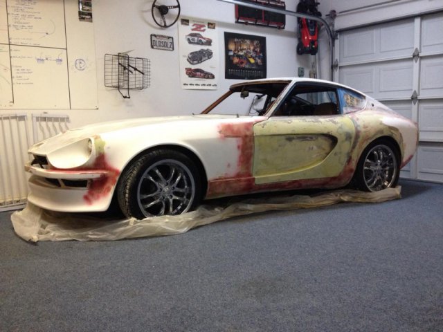

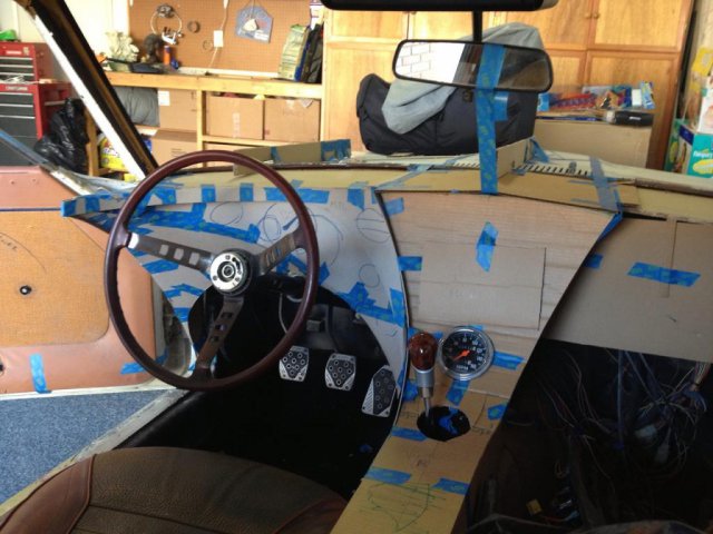

  7. 1. I tried a cheap Grant steering wheel, but didn't like the smaller diameter. At this point, I plan to use my original stock steering wheel. I just need to refit the horn pad. 2. I bought these wheels and tires, about 5 years ago. They are 235/40zr18 fronts and 275/35zr18 rears. I have 2" front spacers and 4" rear spacers. What you see is what will be
  8. The tire I have installed are 275/35zr18 with about 2.5" of space before they hit the spring. But I left a little wiggle room so that when I lower the car and straighten the camber that the outside edge of the tire will not rub the new fender. I therefore don't know how much wider of a tire could fit. The rear's have 4" spacers that also convert to 5 lug so I could find less expensive wheels.
  9. The carpet is nice but I have the car parked on a plastic sheet and then I srop down a plastic sheet curatin that is stapeled to the celing to creat a dust booth. That way I don't have to clean up the whole garage or worry about my 64' mustang also parked in the garage. P.S. The mustang is for sale to pay for all I want to do to the z, which is my favorite car.

  13. Maybe instead of a link to all the photos, I will attach a couple here. SubtleZ front fenders and dam. YZ Rear fenders. Obviously, 100% custom dash mockup:
