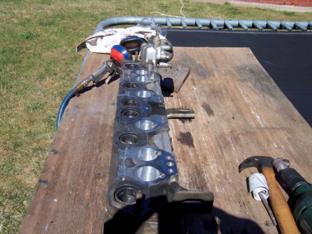

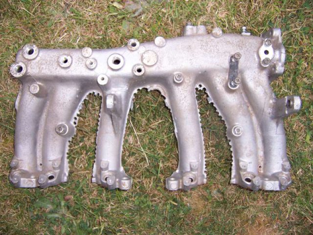

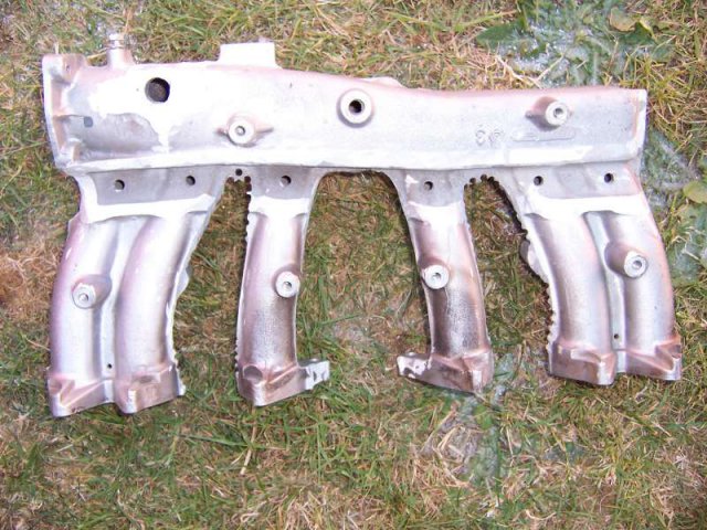

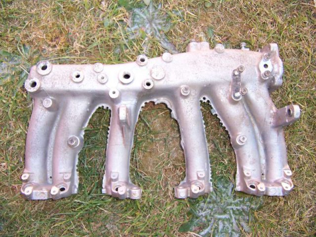

This will be about all I will be doing, except plugging the holes. I was going to buy some tungsten carbide bits, but when I saw the price AUS $90 each, down to about $60 for the small ones, and since I would not use them very often, I couldn't justify buying them, and my wife would have "hiffy" fit. Nigel -

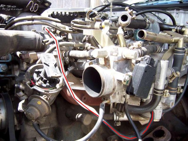

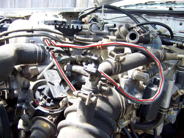

I answered my own question, I don’t need it, it connects to the Boost Controlled Decelerating Device, (BCDD), thanks BRAAP, after reviewing my pictures (I can’t remember everything) , I see where it came form and where it’s going.. BTW, it’s not any "Z" car.. And yes I know this is a "Z" car site, but since it's a L24E, I thought it may be similar to something else out there.. Nigel
Not sure what this does, I believe it operates when the engine is cranking, it appears to be connected to the dissy and manifold, but I dont have my pictures here to check,, I think it can be removed ? Nigel

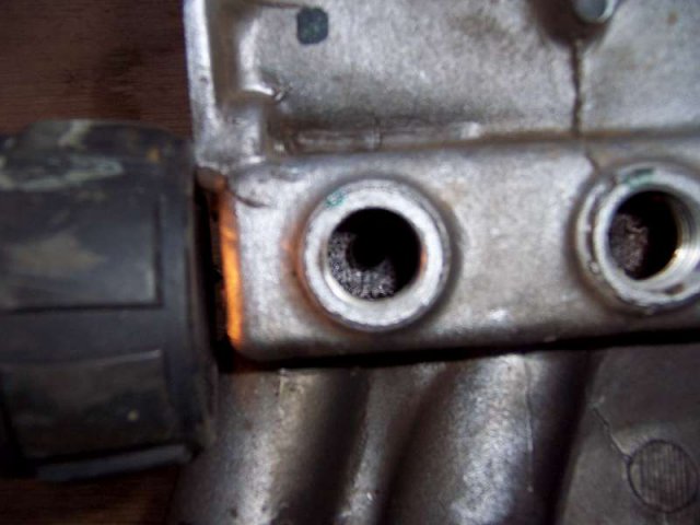

A very good Idea, or maybe little welsh plugs, Thanks for the hint, Nigel -

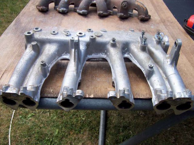

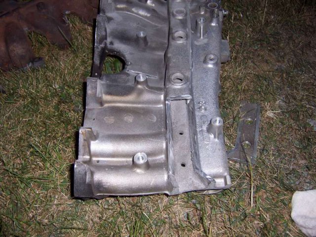

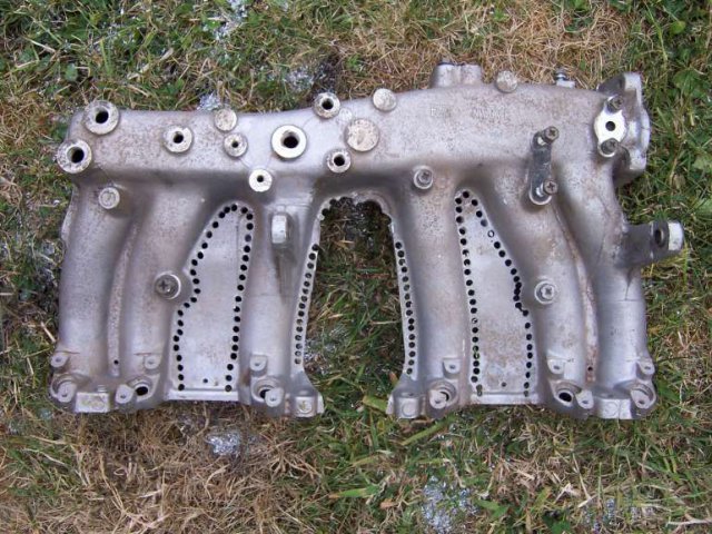

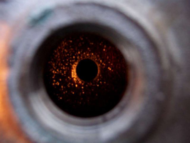

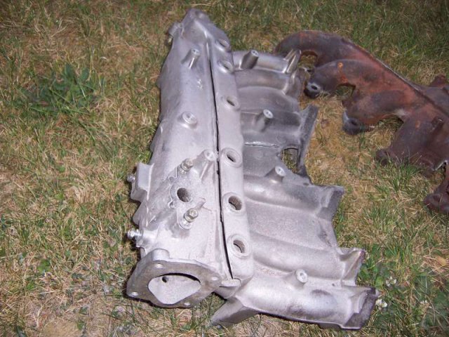

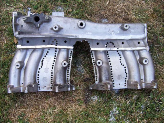

I found holes into the runners, behind the bungs , so I won't be able to remove the "blue" area in the original picture, unless I get them welded up, but since money short, and I'm trying to do it on the "cheep", I will remove only the "red" area. I will pay the local wreckers a visit, I may find something, but since EFI " L " engines didn't arrive in Australia till about 1982 (I may be wrong, but I believe the early MR30, didn't arrive till '82), I may not find any non pollution manifolds. -

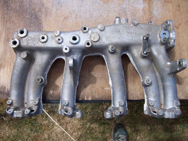

Nice isn't it ?, but for $600 US and shipping to Tasmania, I don’t think so, Cygnusx1, large cracks in the exhaust manifold, if you couldn't tell Slownrusty, I will be running extractors, this should reduce the heat under the manifold, since it will have more clearance, and not have a huge thermal mass sitting there, trying to get every thing hot, I think I will "hack" it, my time is free, and I have some tools, air compressor, Air pneumatic Die Grinder, I will need to get some carbide bits, not sure about the purple and blue bits in the picture, I will have to pull out some of the plugs to see what behind there. I'll take some pictures as I go.. Nigel -
Thank you, for your quick reply BRAAP, I thought using the coloured lines would make it easier to get across my question.. Nigel
Just wondering whats the best way to remove the webbing on this manifold, I was looking at removing the RED part , see image, the blue and purple may be too much of a hassle to do, the main reason I want to do this, is to make it a little nicer on the eyes, and to help with getting to the exhaust studs. Nigel.
In these 2 pictures, the Red Line I believe if for Fast Idle (Cold start), The Blue is for IDLE (I think), what is the Purple for ?, can this be removed ? thanks,
