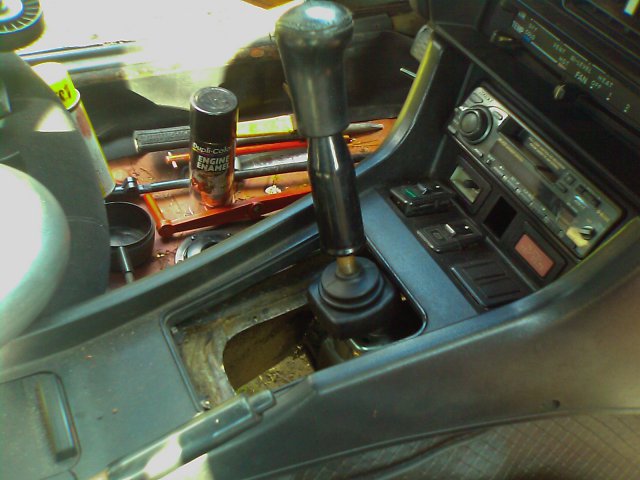

  16. I have the standard r154 that comes in the supras(no extension) And i can put my trans in any gear with full interior..maybe my engine is further back than yours...
