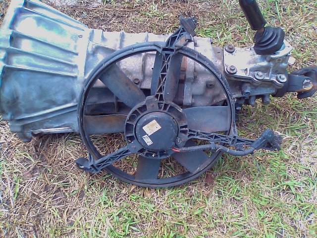

  4. My dad had this eletric fan laying around near the shop so i snatched it up, all i know is it works good( I did the old battery and two wire trick to test it:mrgreen:)...not sure if it will be enough to cool the 1jz though, well have to see!!
