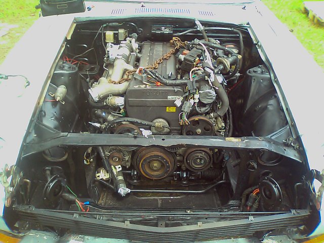

Today My dad and I got he 1jz into the s30, but it's only for mock up and is blocked up for now...Yesterday, I made a cross member from 1 1/2 box tubing and 1/4in thick( i think) angle iron....Now that the engine is in place i can put my cross member in place and make ajustments....I still have to make the actual mount on the CM, might do that tonight or tomorrow, hope to have pics of the cross member tomorrow... check it out....It looks cozy!!!!

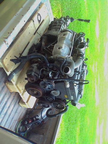

Thanks!! Im aiming for about 350-400whp So nothing to crazy.. So far the engine looks pretty good, although it did arrive with a broken tps housing..know where i can buy one? The oil looks very clean, spark plugs look pretty good, but i can tell it was running a little rich..Most of the sensors look brand new, coil packs the same...The harness look kinda ragged, but it is complete and uncut...The ECU looks fine, but i have not had a chance to open it up..The twins all spin freely with only minimum shaft play...This 1jz seems to be a second gen version because of the way the vent on the valve cover is designed, so it is a newer 1jz so thats all good.... Will prolly try to pull my l26 this weekend, and paint the engine bay... I'm now trying to decide should i just pony up the money and buy the mounts i need of just make custom...I stared this project with the idea that i could do this swap for cheap..my budget was $3500-$4000 including the price of the car!!!! Now i know some of you may think that I'm crazy...but i am on my way...so far i have paid $600 for the car, and $2000 for the engine set..total of $2600 so that leaves me $1400 to get the 1jz in the car running good!!! Of course that is if everything goes as plan which rarely happens.. I believe in build to what the car is for...So i wont be spending money on fancy this and fancy that...I will imitate or maybe better stock design..for example a good piece of fuel line works fine as fuel line, don't need steal braided fuel line..lol...If i was building a track car then it would be diffrent...just clean stock form factor...
