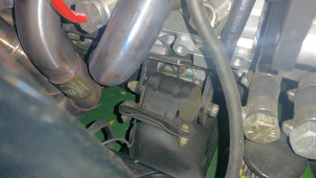

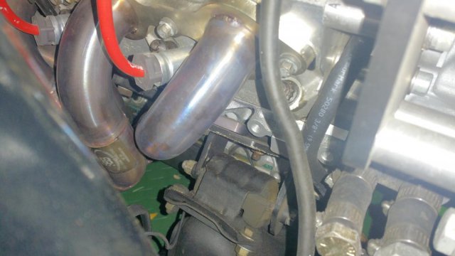

  3. sounds like you have some educated advice subhuman. think i will take it too....as far as what nismoluv asked, ive seen some do the universal joint done, it would help to get the header to exit towards the fire wall. but the passenger side i didn't have room for it to exit towards the fire wall with the starter and brake lines in the way, so you would still have to run 2 different headers. also the steering shaft is so short as it is, i didn't feel safe having a universal joint. right now i have billy boat "stepped" shorties for a c5. the primaries are 1 5/8 which my tuner said it would be better with 1 3/4 but i couldn't fit them. i bought every shorty header out there and just returned them as i determined they wouldn't fit. i still had to mod the ones i have by re making the primary closest to the fire wall (which u can see in the pic)and denting in the back side by the collector a lil bit.. here are a bunch of pics. I drilled and tapped threw the shaft so I could cut that ear of for room and I also got rid of the rubber joint so that I could put a smaller diameter solid mount to get room. the manifold I had originally I cut out a patch and had a plate welded in from the back side to get room for the shaft

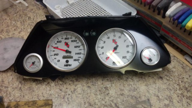

  7. I used aeromotive also part#11106 good for 700hp, aeromotive regulater,before and after filters, 8an feed, 6an return, and braided flex hose the whole way.i did the same thing making the feed line my return line.i didn't know much on modifying the sender so I used and external pump but my understanding with fuel pumps is they make better pushers than pullers so I put a fitting on the bottom of the tank for gravity feed. I had to drill holes in the tub inside the tank cause now my feed is outside of that tub, I put fuel cell foam in too. I eventually want to weld a sump in the bottom for better pickup, right now I cant get less than a quarter tank or it will suck air which is obviously bad. there is a thread that says how to use a autometer gas gauge for a ford to work with the Datsun sending unit but It didn't work right, I gotta play with the resistors a lil more to get it accurate.You will want all new gauges to work with the new motor, you could save the gas gauge and maybe volts and oil pressure but new ones fit perfectly in the old pods.

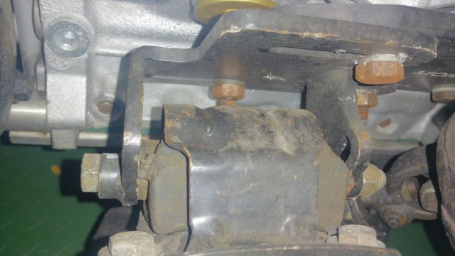

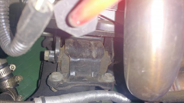

  11. Those mounts could work. What I think will be your problem is were the mounts bolt to the motor end up behind the cross member. I had a small block Chevy in the car first so I already had the jtr mounts. Then I got sbc to ls swap plates. Problem then was the motor moved to far foward. My dad said to try reversing the mounts. I put the passenger side on driver side and visversa and it actually put the motor in a good place. I had to weld bushings on the mounts cause now the slots in the mounts went up and down Instead of right and left. Hopefully u can make sense of the pics, I know this may be confussing but I was able to make this work and I'm sure there is other ways to get mounts to work.just be creative. Good luck with yours, keep me posted. the headers i felt were the biggest obstacle.

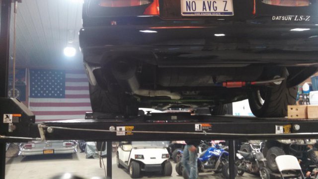

    Out with the old exhaust, in with the new and improved. Dual 2 1/2 to single 3 1/2 full stainless. Oval pipe to get over the sub frame.

    From the album: 280zx customization
    Billy boat stepped shorties for a c5. This is after I replaced the primary on the right

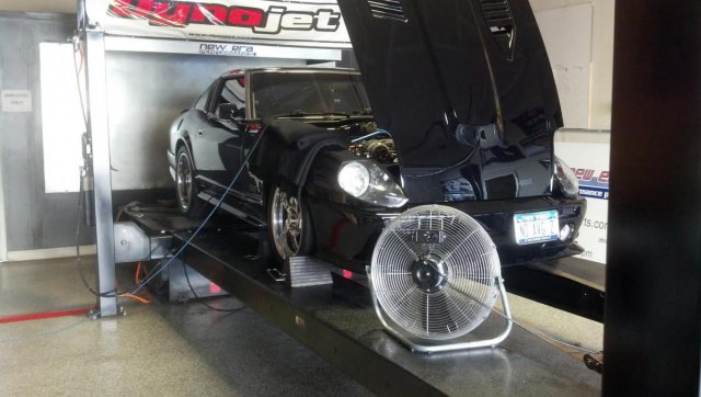

    Hello ls motor. L33 bored to 5.7, ls2 dart heads. 400whp

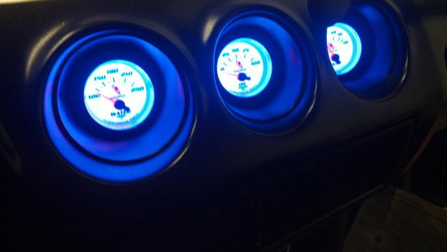

    Made gauge cluster auto meter gauges, indicate air/fuel.i used a Ford gas gauge but I couldn't get the amount of resistors right to work correctly dispute what I read on a forum before
