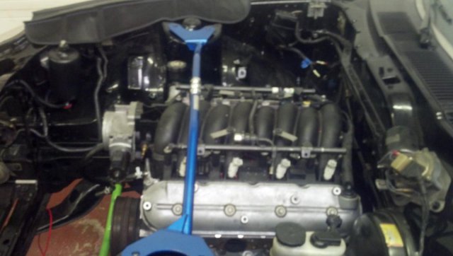

  21. looking good as always. like what you are doing with the radiator. here are couple pics of were my motor sits.i basically put it an inch or 2 from the fire wall.... keep going, mayb by next spring you'll have one badass s130.
  22. i gutted the heater out, so i put the pcm on the tranny tunnel where heater and all that was. and pass fire wall for relays and fuses also

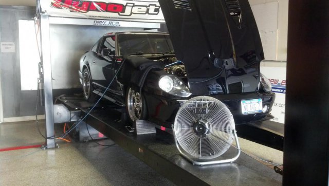

  23. im very happy with my setup. no major trimming or mods, or no fender flares.to get a 17in rim, 4 lug with 0-offset is pretty hard. i had mine custom made by Boze wheels. you can go that route, or you could do a 16 in rim with a 50 series side wall (there is some options for 16in rims) or i have seen there is now a 5 lug conversion for s130 (more options for 5 lug 0-offset rims) from techno toy tuning or arizona z car i think has it. if your doing the whole Ls swap i would get stronger stub axles from modern motorsport with the 5 lug. all depends on how crazy you wanna get. a small block chevy is the easiest swap. it will be great at the drag strip but not too great for roadcoarse stuff. if you wanna do the Ls swap, its alot of work but there is a thread i started in the V8,Genlll & lv section called 280zx's with Ls swaps. that"ll give you an idea on what to do. PM me any other specific questions if you like on the swap.
  24. i run 17x7 with 225/45/17 and 17x8 with 235/45/17, 0-offset on both. i have 400whp and the rear likes to squat so i actually had to trim the front of the wheel well cause the tire pulls fwd as it squats. i have plenty of traction with only 235"s on the rear. and i like having a 45 side wall cause it gives the tire a lil flex for launching, instead of a real lo profile tire that wont give good traction for taking off. i hear and see of people doing wider rims and tires but i dont know how they are not rubbing when hitting bumps or when the suspension travels alot.

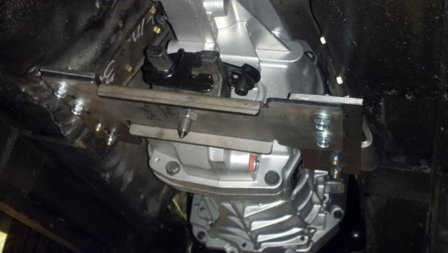

  25. i worried about that too. my 280zx had some tranny tunnel reinforcement but didnt feel that did too much. so i added some 1/4in thick steel plate to the floor. had it welded to that tranny support, then welded it to the frame rail. that gave me some great rigidity and i no longer worried about it. not a great pic cause they are painted black already in this pic and they blend in with the bottom of the car.
